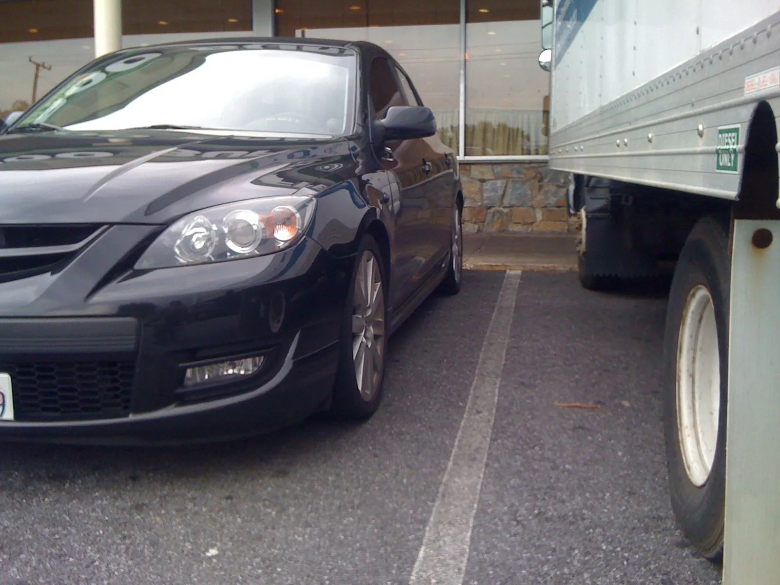

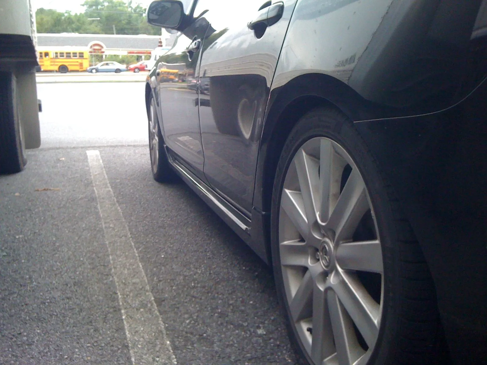

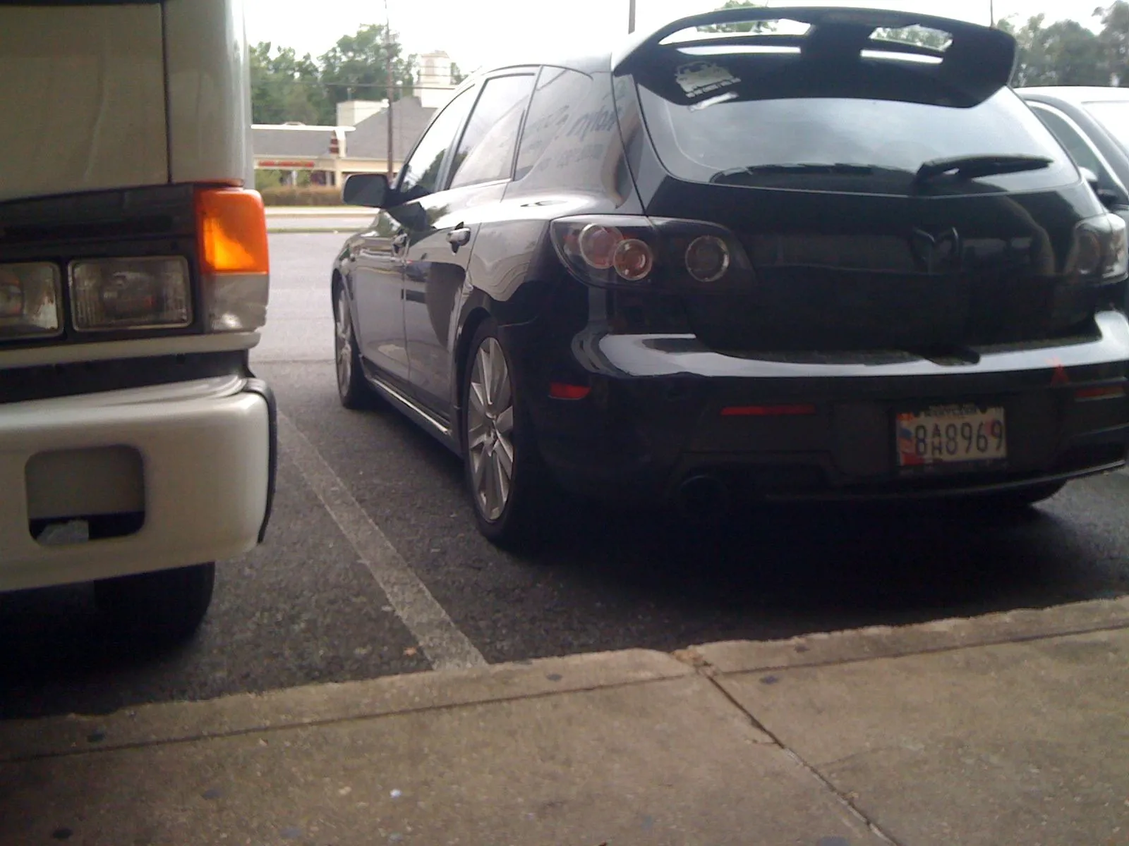

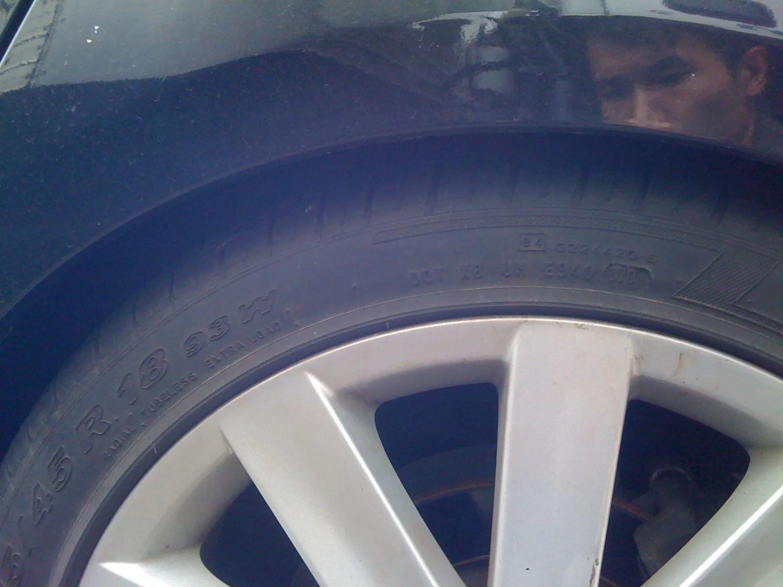

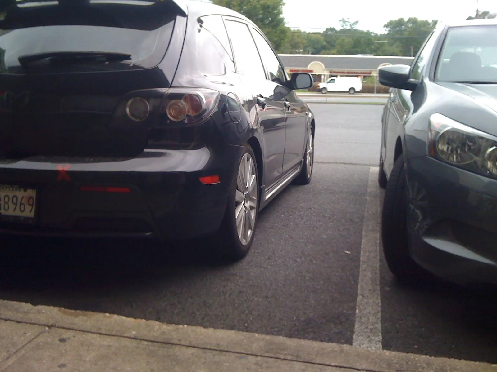

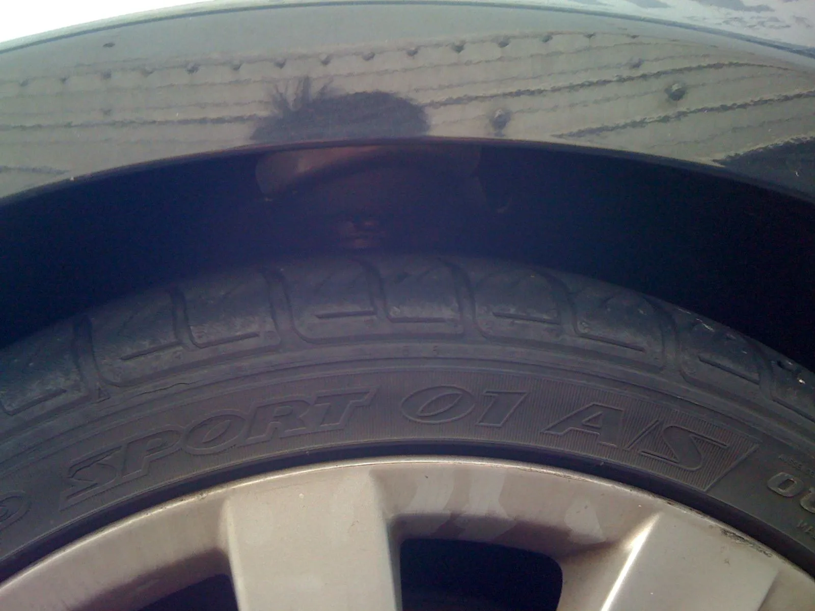

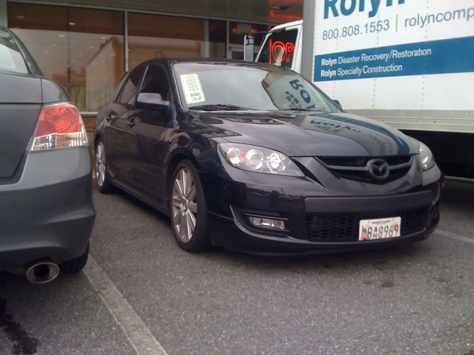

installed with eibachi springs,install was pretty easy if u can put on lift! over all is good, but dunno y the rear looks lil bit lower the front??
My car looks like stock. Take a tape measure and compare it to a stocker. Struts/shocks can take a little time to settle, too.

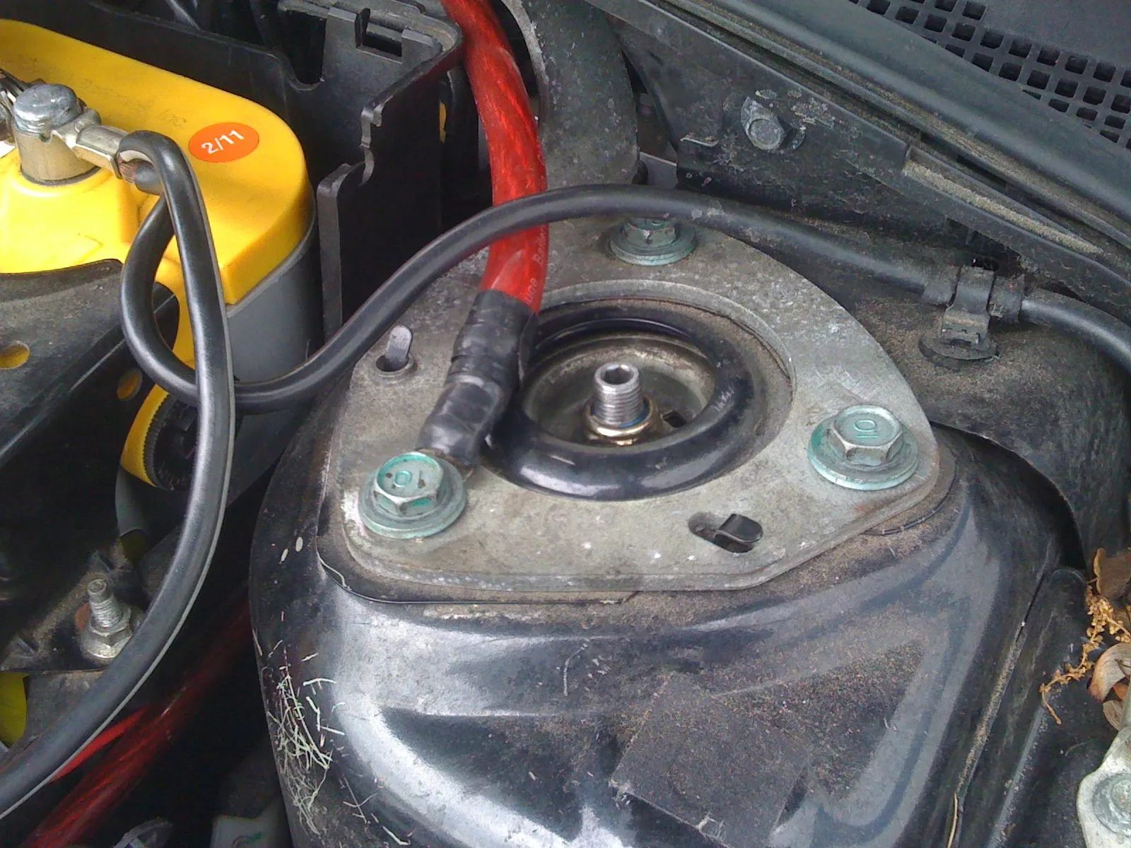

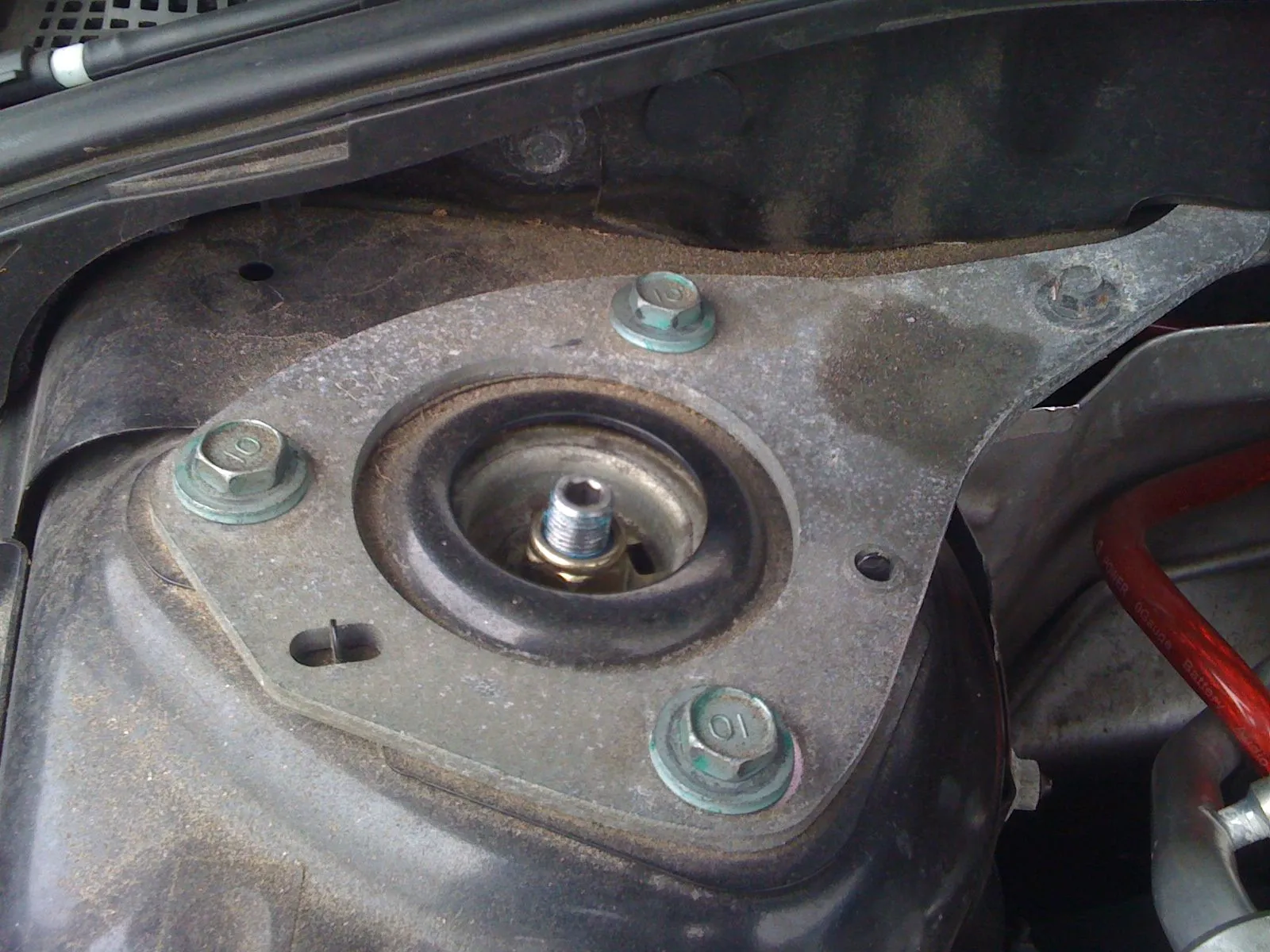

As long as you got the struts all the way down in the front hub pinches, it should be fine. expect about 1/8" to protrude below the pinch if you got this right.
i ll post some pic soon, its been raining in these days here. i mean with that price totall, i can really feel that my money is worth it!!!
rear is on the second pic, 3rd and 4th pics is how i tighted the top bolt, didnt have enought time to take pic from the rear....
