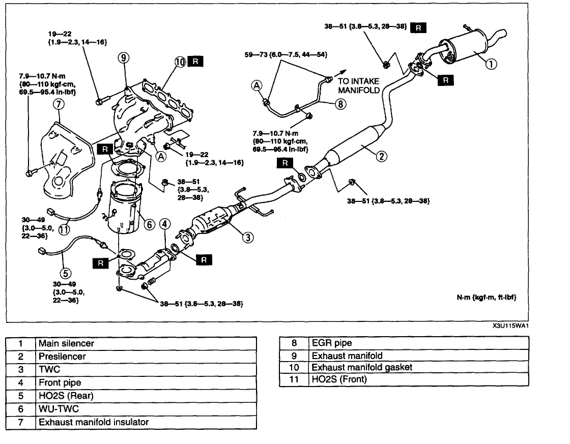

Does anyone know if the exhaust (cat-back or complete) for the 1.8/2.0 is the same for the 1.6? I'm trying to get a setup done but the shop will only prototype it if it can be sold to more people. Any help?
according to the parts guide i have, the 1.6 and 1.8 with the manual transmission share mid-pipes, but the 2.0 has a different part number. HOWEVER, i also know that there are some here that have installed a 2.0 exhaust on a 1.8. so, i would be tempted to say that from the cat-pipe back they are all the interchangable.
I have different part numbers from alldata for each however the converters are about the only difference.
1.6 oem part# zm0140500a
1.8 oem part# fp3040500a
2.0 oem part# fse640500b
I know the 1.8 and 2.0 mid pipes are interchangeable.
