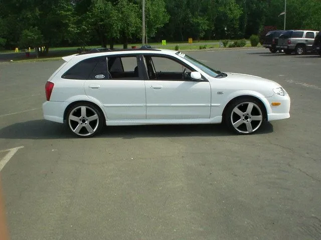

hey i just photoshoped these wheels onto a white p5, im trying to decide between these and rx8, both 18x8, these pegasus rims come in silver or gunmetal, the ones in the pic are gunmetal but there not as dark as in real light. what do you think???

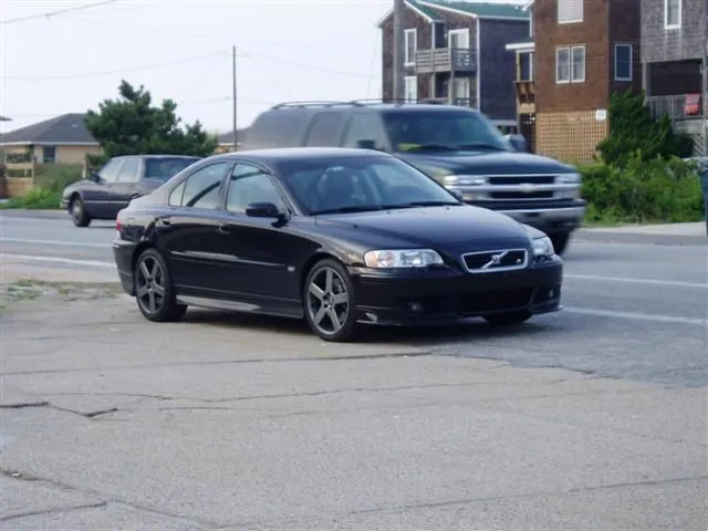

other thing i should mention the p/s kind made the wheels fat, i added a pic of what they really look like on the volvo, lol

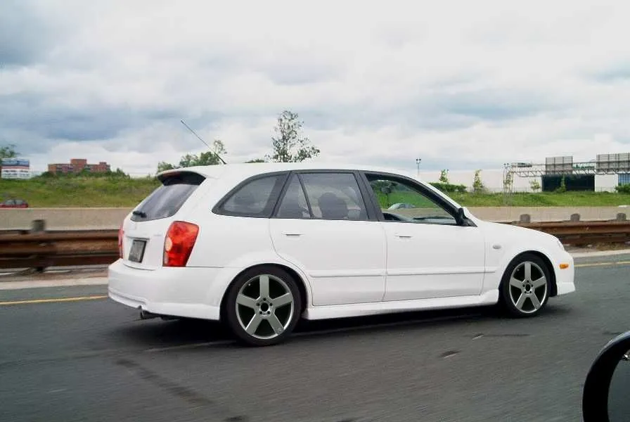

added another photo of the Graphite version which i think would look real good..???

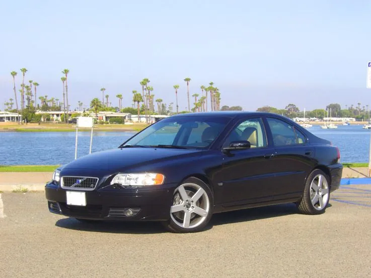

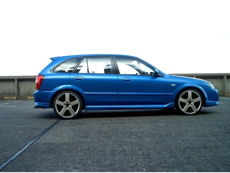

added another pic, its just a better photoshop of the rims

They look good. The RX-8 rims still look better IMO. These might be easier to fit though depending on width and all. But you can also find RX- wheels used here or on the RX-8 forums.
I agree..the Pegasus rims are ok, but I'd stick with the RX-8 rims...the Pegasus rims look a little too chunky on the p5 I think...
rx-8 wheels are too wide, and the rubber won't sit right on them.
