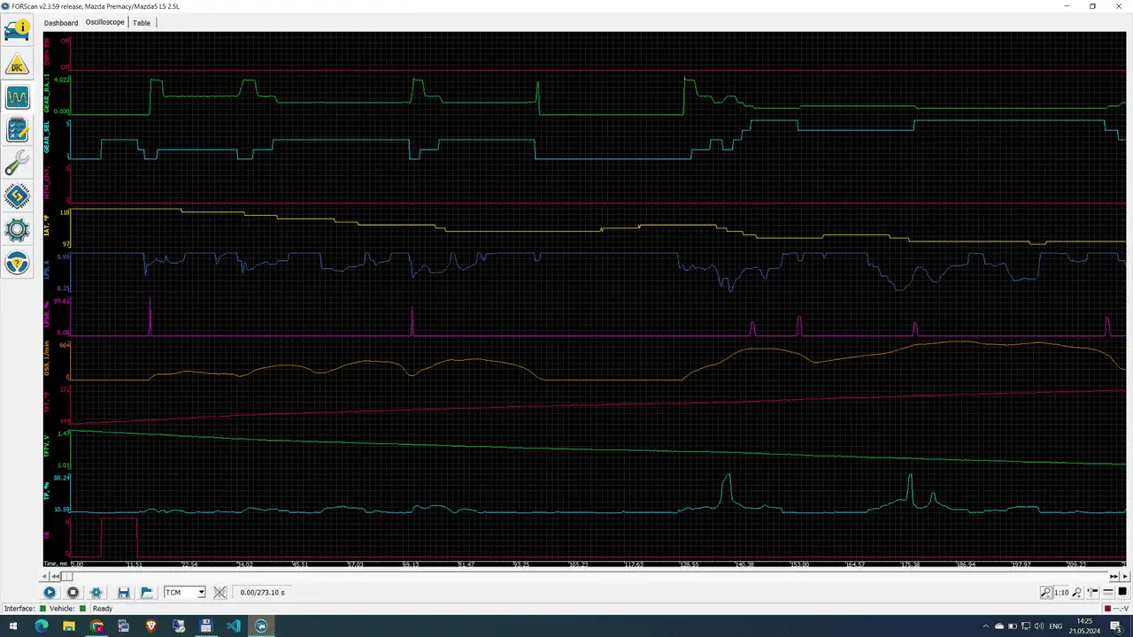

From what I observed over a brief drive monitoring session, it does engage/disengage as supposed to - see the OSS graph (orange). The big flat space between 100 and 128 is idling at a stop.
Is there anything wildly abnormal, that should further be investigated in your opinion?
I would greatly appreciate any advice on which parameters to group on this graph that would help to understand what is going on.
Also, I tried feeding this data into chatgpt4o and, to my surprise, it outputs something that now actually makes sense, although, the recommendations are very generic, i.e., "note whether a change in LPSA LPSB correlates with gear shift, look for random spikes on OSS, etc".

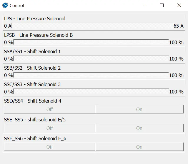

Seems like some control of the transmission solenoids is available. Buttons are inactive because currently the car is not connected.
For the record, this is an activated version of FORSCan on PC with vLinker OBD2 cable.
I'm now doing the research on which one controls the clutch.

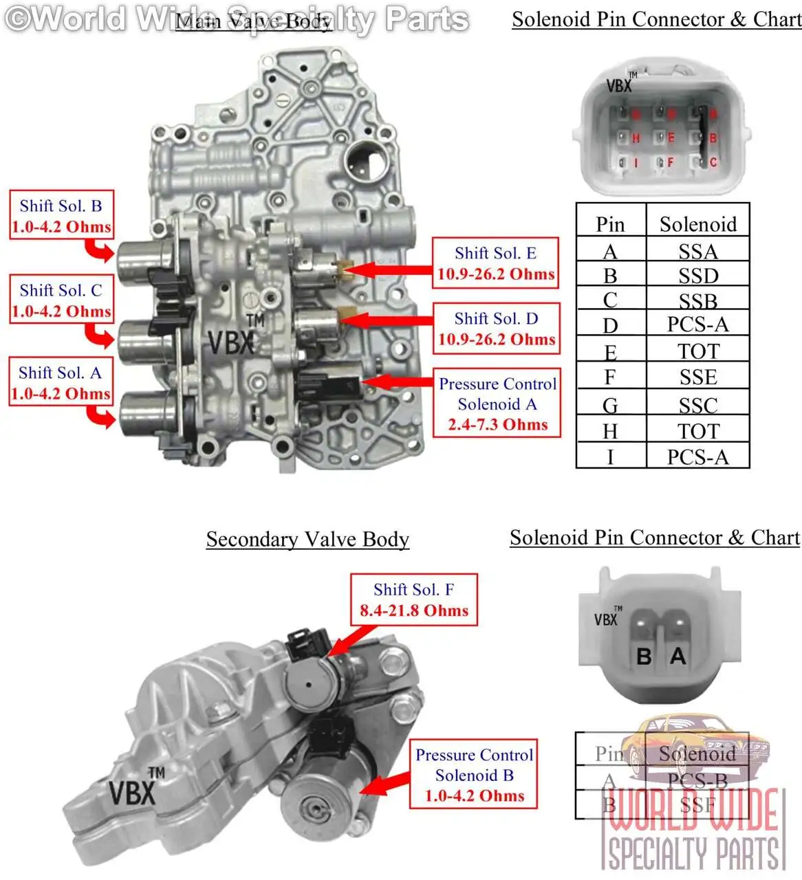

Pic of solenoids that match up to the FORScan menu/options.
I didn't realized there's a secondary valve body with a different "Pressure control solenoid B"!
