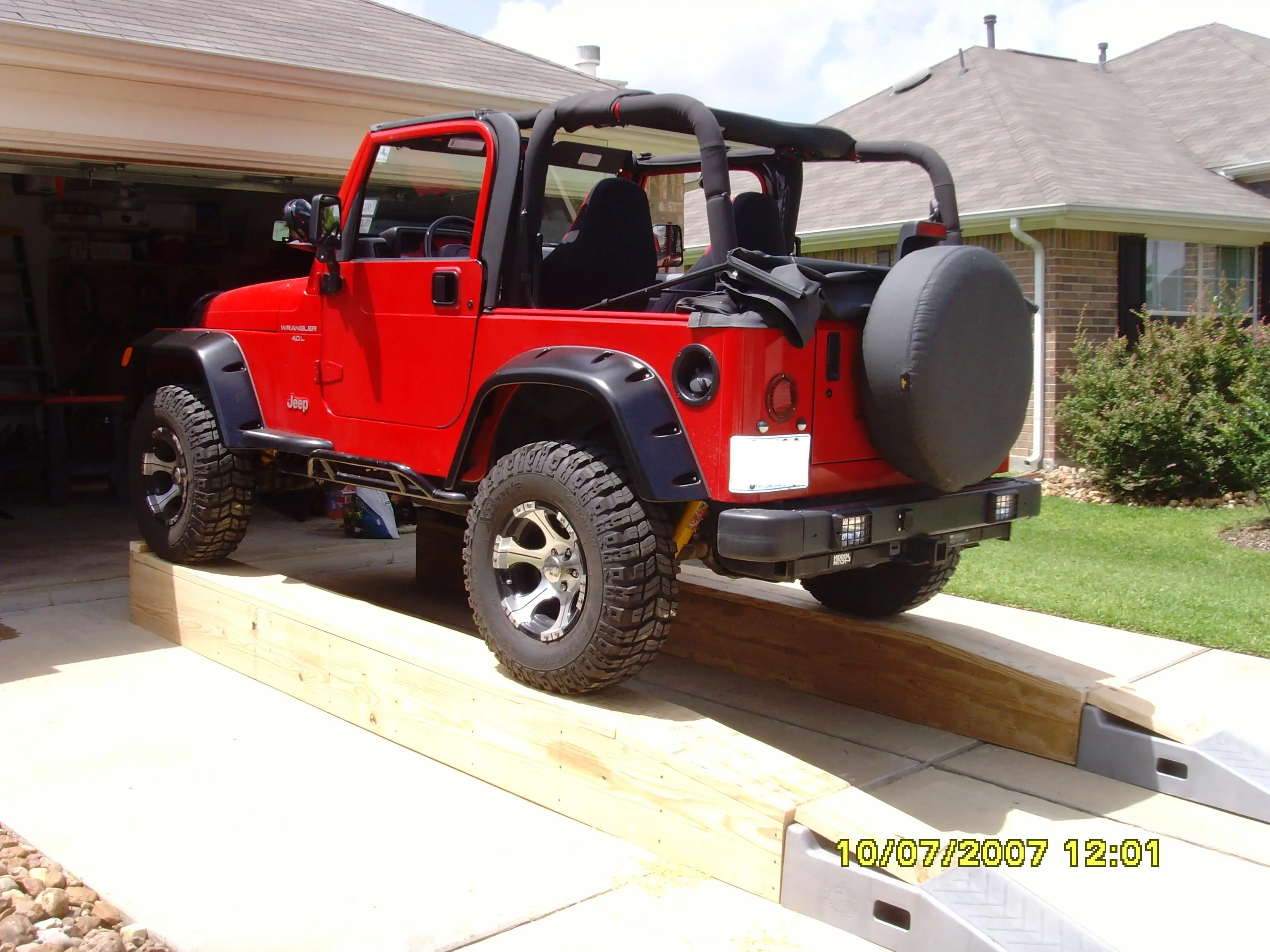

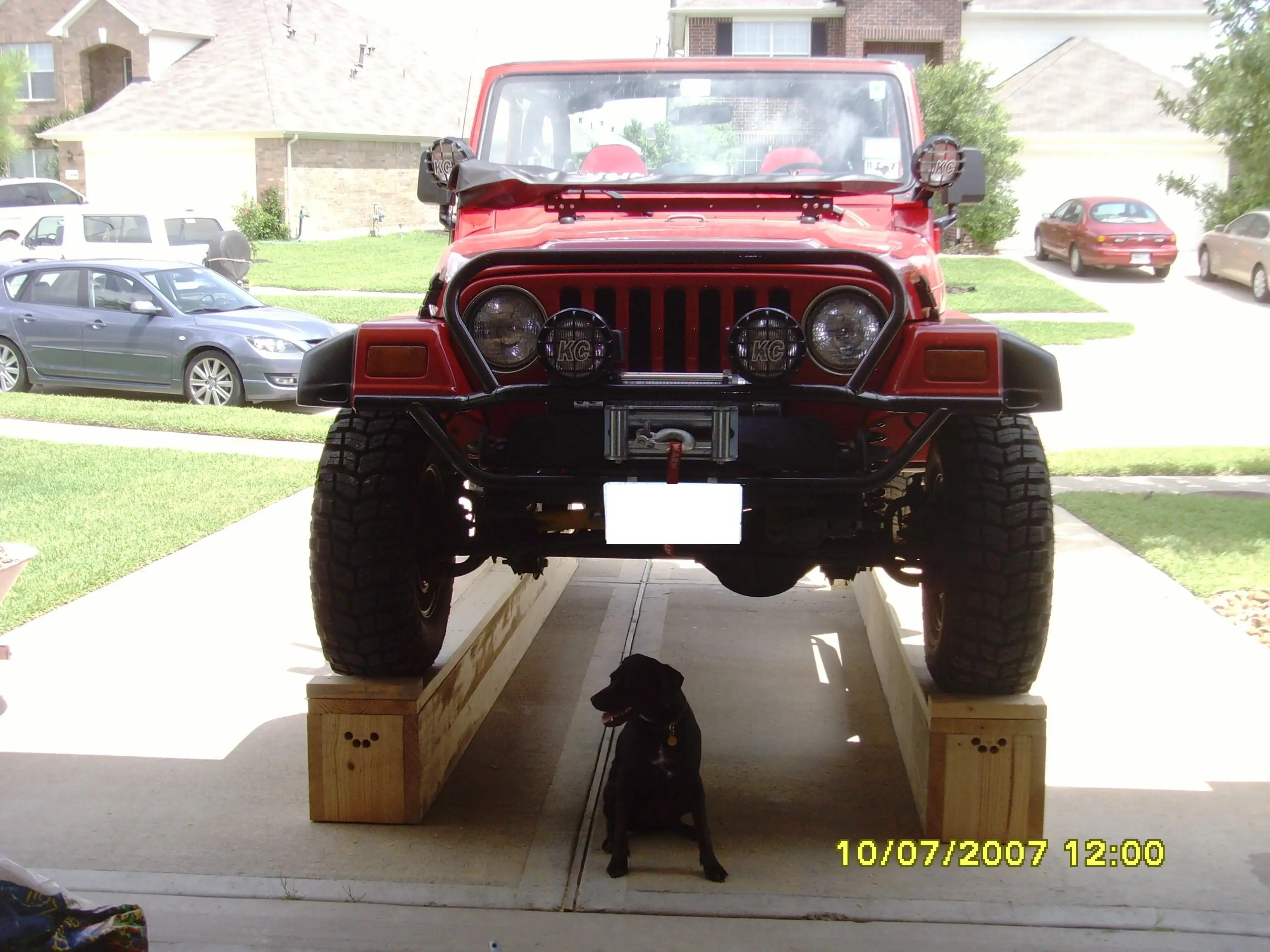

I made these, their 12' long without the ramps.
I had to build another 8' ramp so i could get the MS3 up there without scraping the bottom.
My neighbours think i'm nuts with a 20' ramp.
