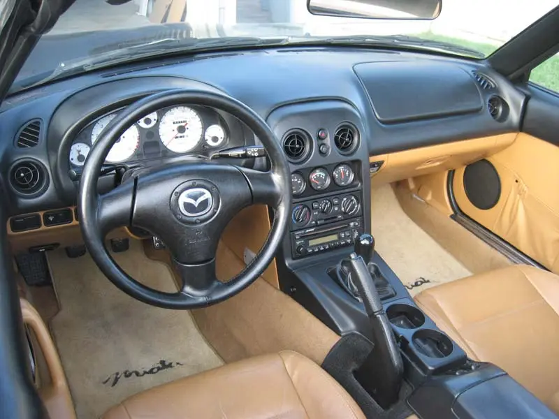

What about retro fitting a newer wheel (maybe NB1/NB2?) and update that interior a little. ...and it would be subtle enough, especially to those not familiar with Miatas.
The Nardi NB steering wheel with bag looks quite good in an NA. FWIW, it doesn't conflict at all with the interior styling of the later NAs.

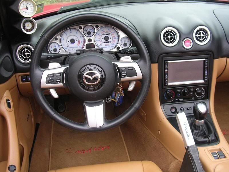

this is also an option. . . .
Although he's got all 3 generations in his interior. lol
This is an NA
