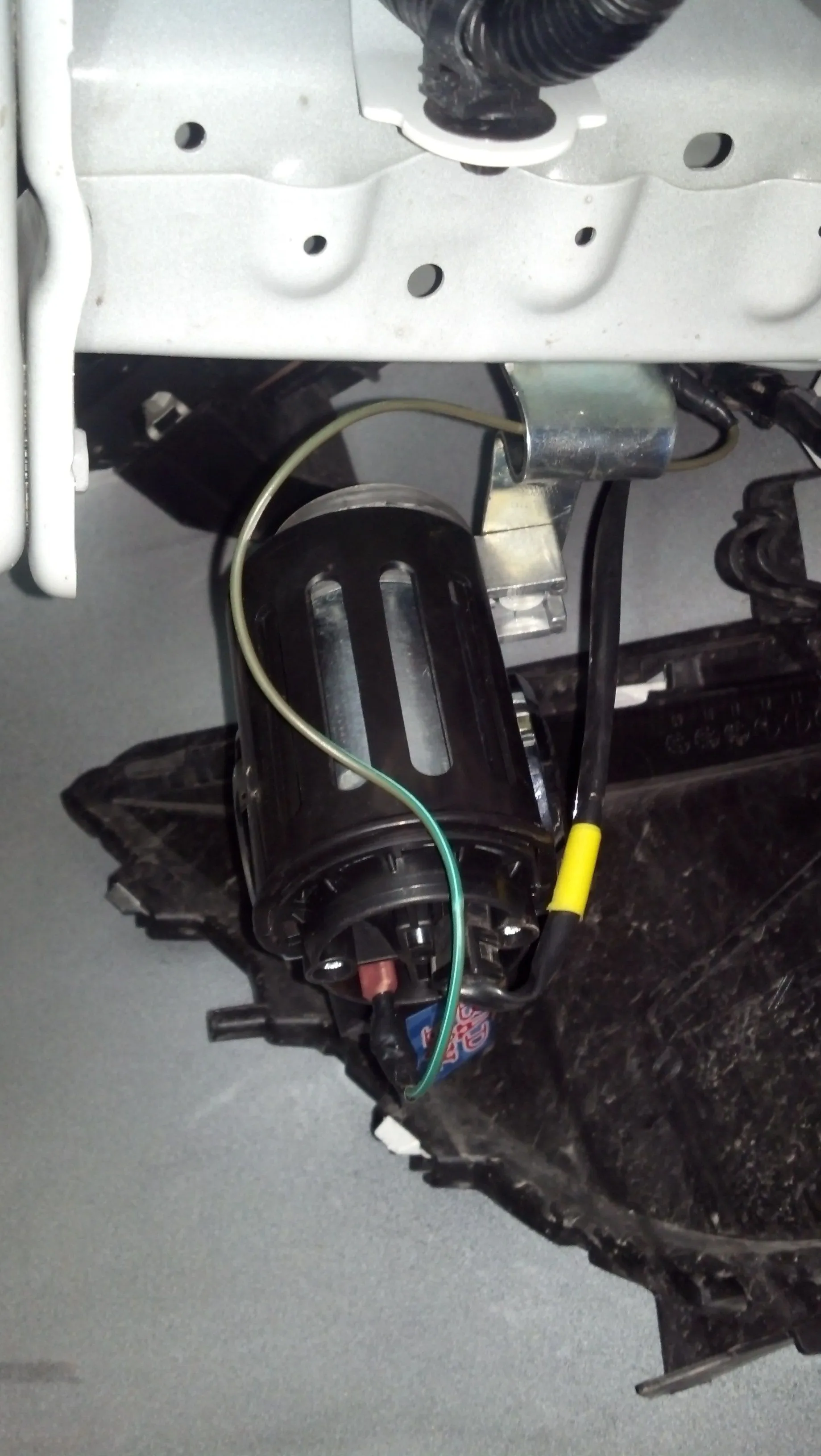

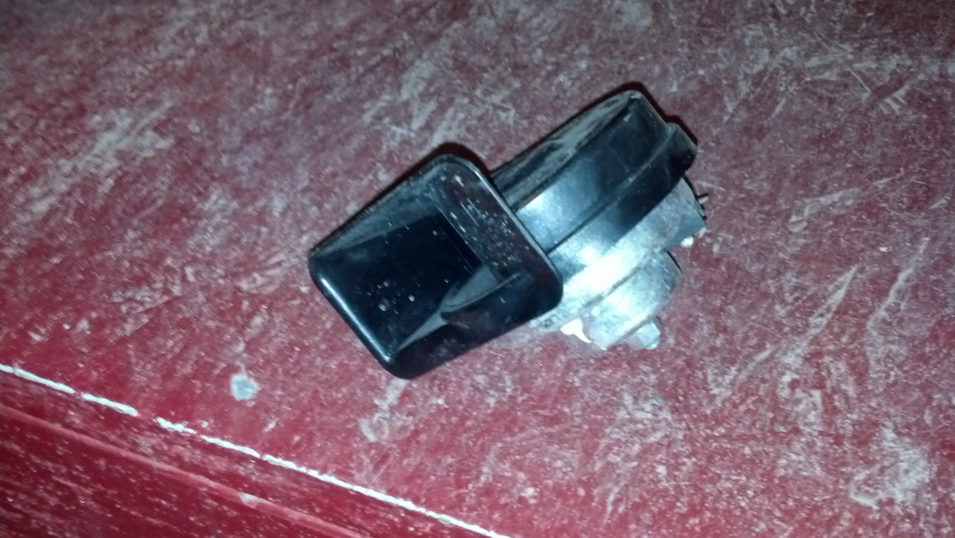

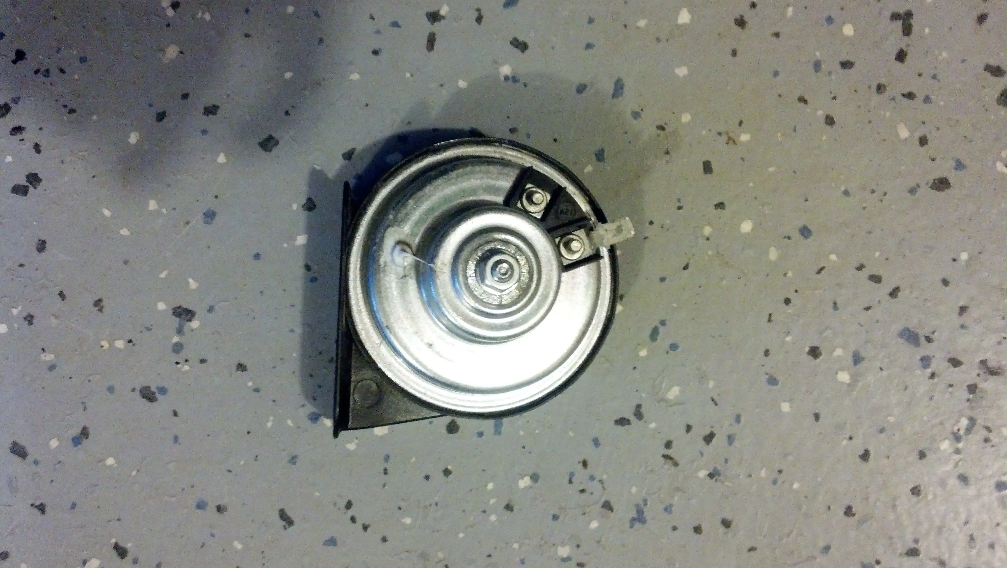

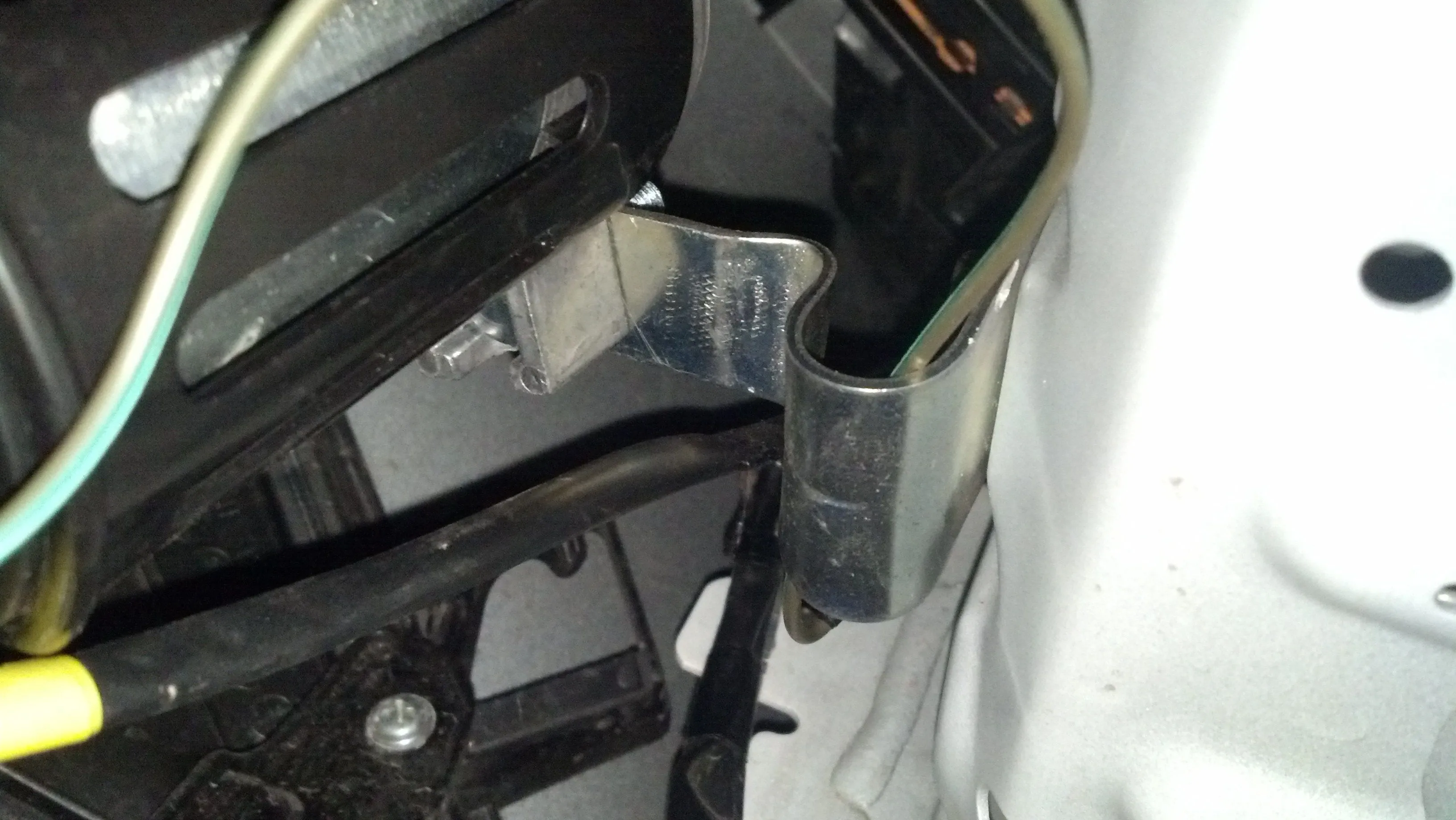

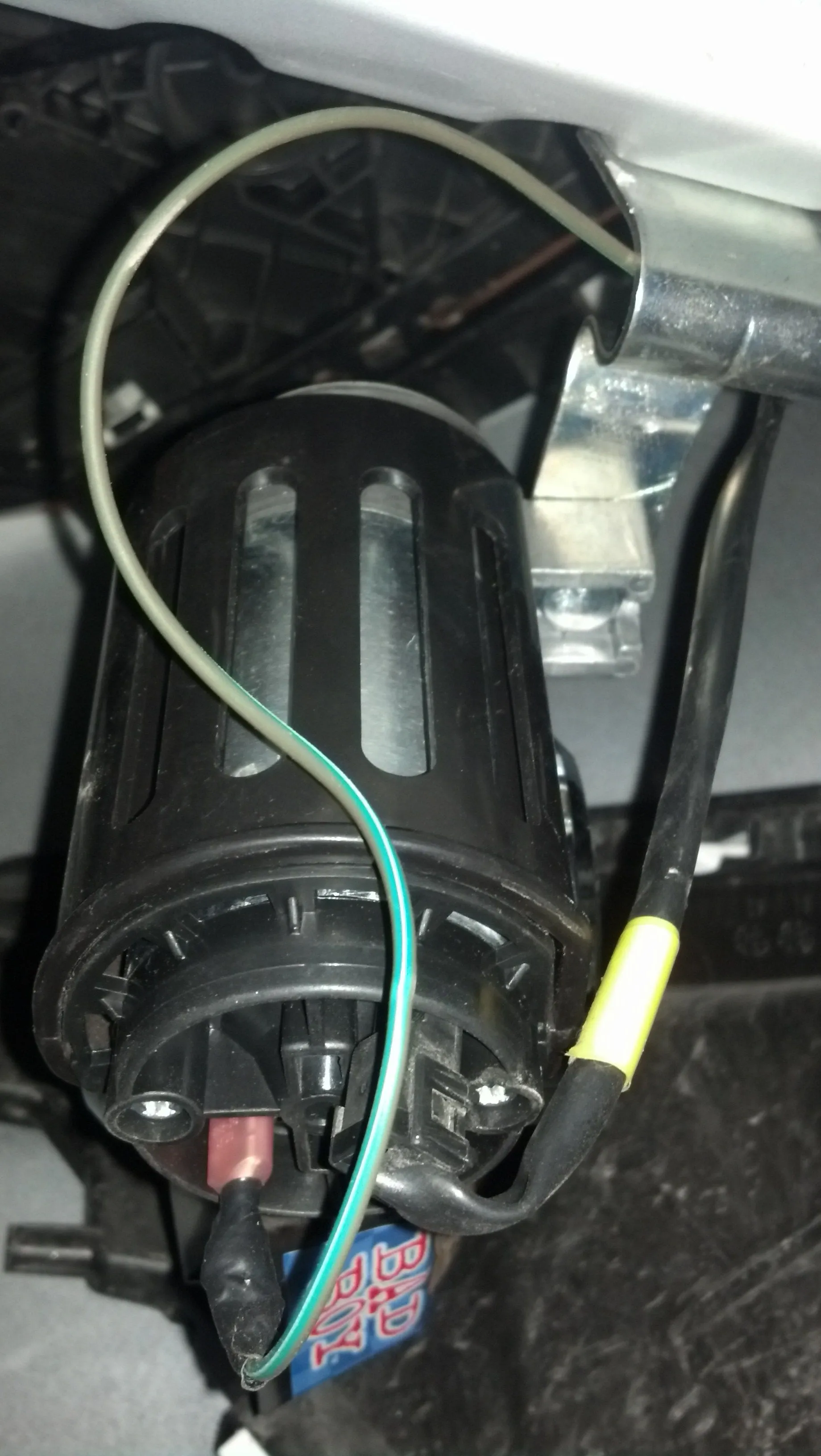

Today I decided to try out the Wolo419 Bad Boy air horn. This decision was mostly based on the fact that the Wolo419 is a one-piece unit and a one-bolt attachment and I could do it without going to the store for additional hardware. Below are some photos of the process. In order to get the horn mounted high enough to connect the power supply to the positive terminal I had to do some bending and filing. In the end, it was a good fit, and the sound is a great deal fuller and louder. I hope that I get some good years of use from this horn.

Fwiw, the 2013 horn is a FIAMM low-tone, part no 55306, the exact same one I bought off Amazon thinking it'd be louder. Duh.
