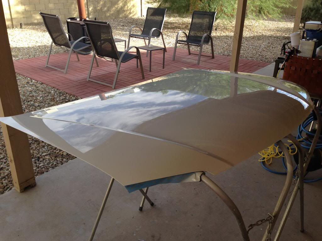

For the last few years I have been painting bumpers, spoilers and small parts using quality base coats loaded into rattle cans and then finishing them off with a two part clear coat that actually comes in a rattle can with insert that holds the hardener that you pop before you start spraying, its worked well, but it doesn't translate so well to big, broad, flat parts like hoods and roofs due to the small spray pattern and generally quick hardener.

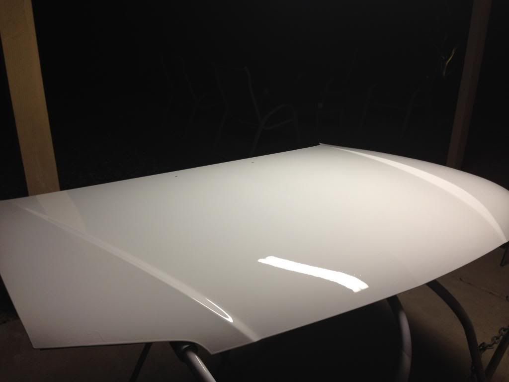

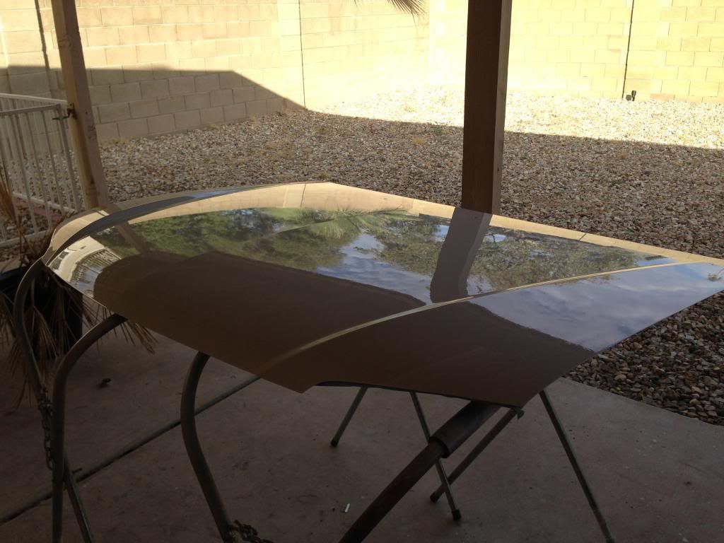

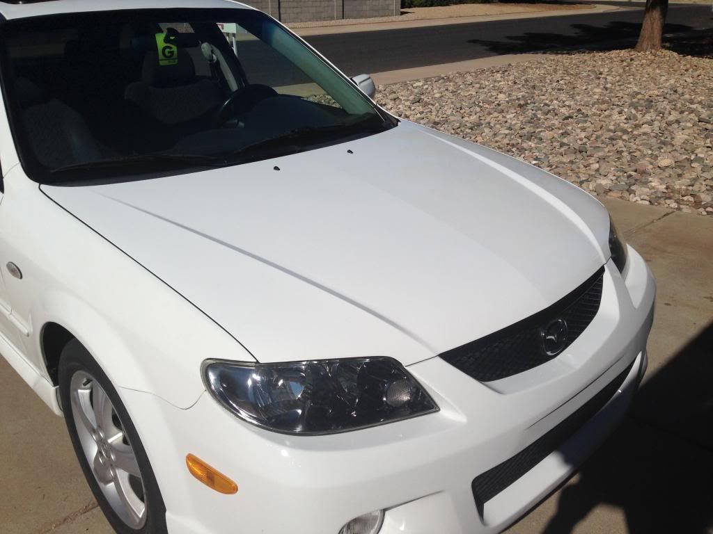

I wanted to go with a slower hardener to get better leveling and less overspray, etc. I have never used a spray gun before but I was happy with the outcome
I used the cheapo HVLP gun from Harbor Freight and went with the mid level base coat and clear coat from my local Sherwin Willams automotve location.

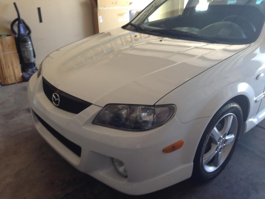

Only issue I had was on the last pass with the gun I dropped the air hose on the front corner of the hood, the clear got messed up but smoothed out some what on its own, there is a sag there now, but I think I might be able to sand it out.
You can see it above the were the passenger headlamp would be:
