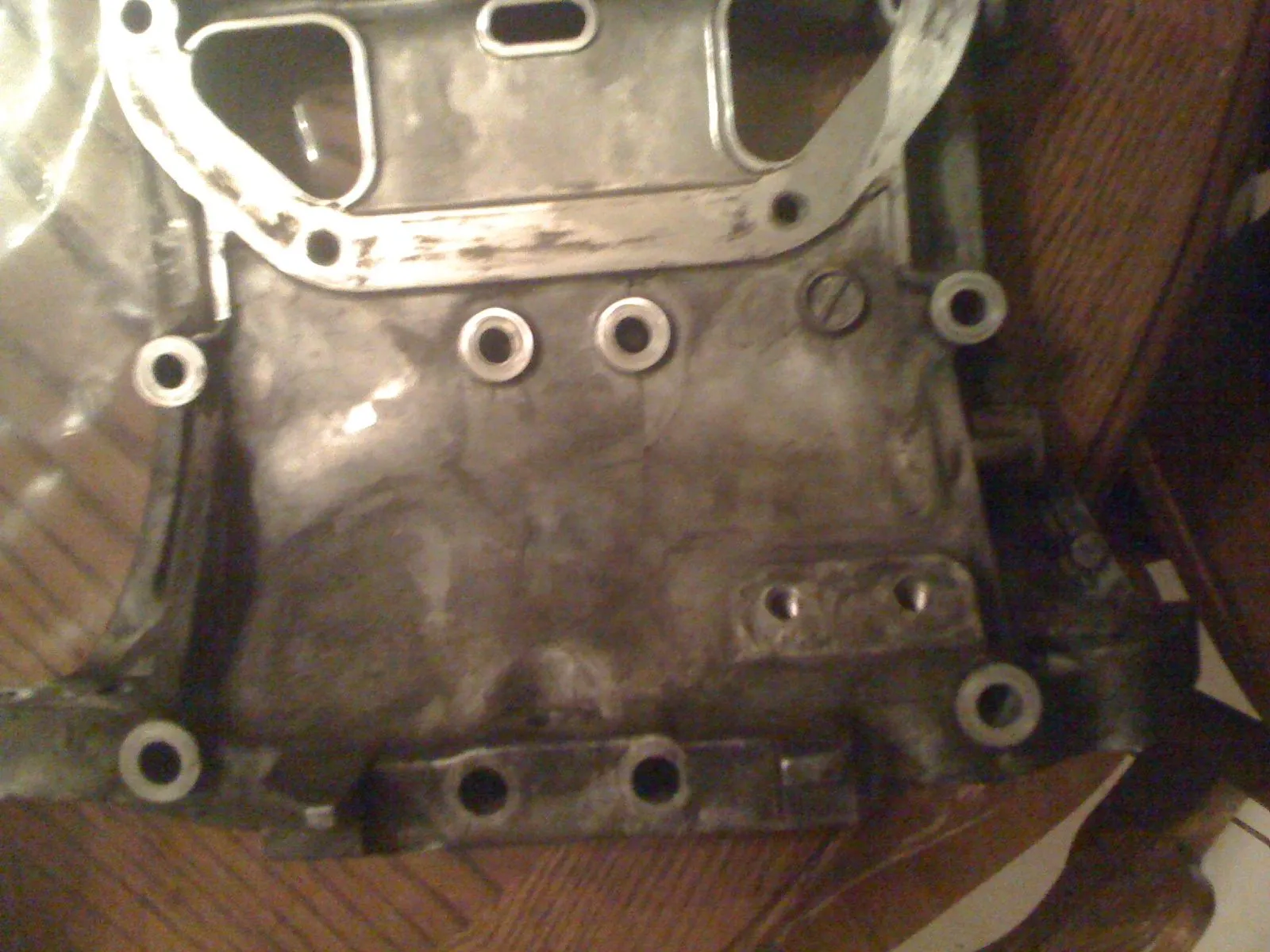

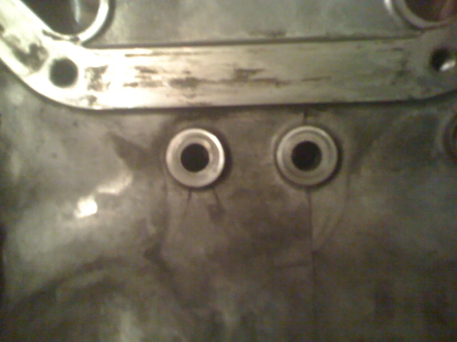

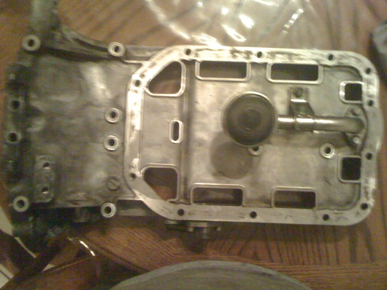

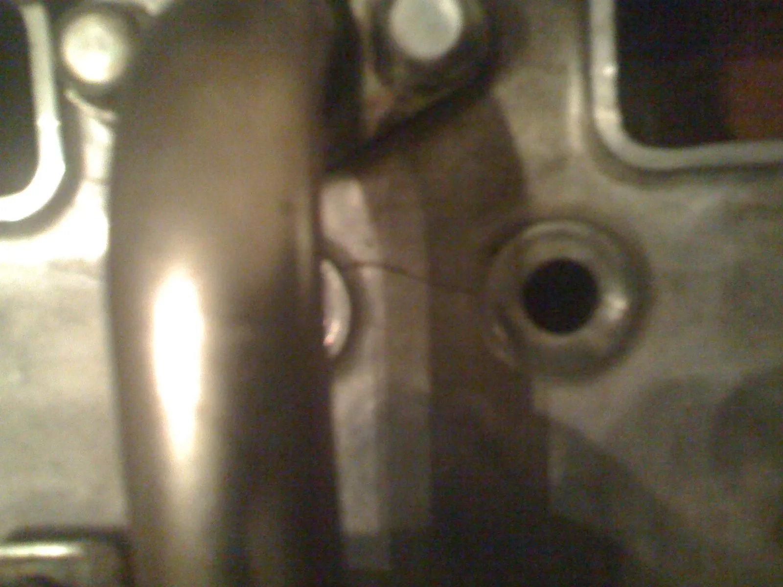

Oh yea thanks guys got the windage tray out. I see that there are small cracks is it still good? I don't see any major cracks that go through each side.
