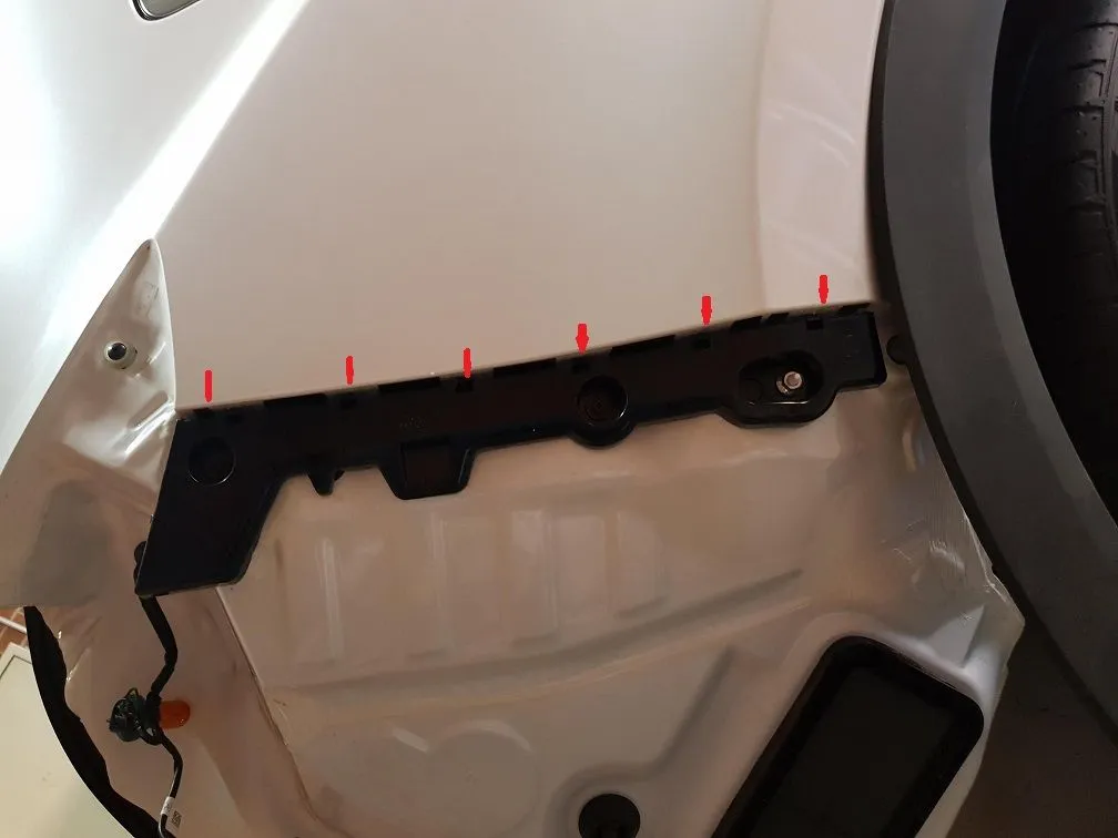

4. Move to towards the rear part of the wheel arch where each side has 2 x screws and coupe of push pins, remove these and continue under the bumper (corner) and remove from each side 2 x push pins and 1 x screws - i ended up removing the plastic cover which attaches on the bumper (corner) and on lower part of the wheel arch.
index.php
index.php
5. Pry open the wheel arch decor (black plastic trim) - start from the bottom with your hand and once the first clip has freed then use a prying tool to assist and avoid over twisting the plastic trim and pry open 2 x more pins and you will see a 6 mm screw which holds the bumper to the wheel arch - unscrew the screws on both sides.
index.php
index.php
6. Once you have removed the screws then place your fingers where the screw was and nice and softly start pushing outwards with your fingertips the bumper and you will it been unplugged clip by clip - just exert enough pressure (only outwards - remember its plastic clip on plastic) and one by one it will come off - repeat at other side.

Thanks for the Great guide, I just changed the chrome strip on the bumper and followed this guide. A couple of notes that I experienced. Take photos of the pieces before removing the pieces otherwise it is easy to forget a couple of the push pins or remember where all the rusted screws go vs. the cobered ones. Once the bumper is almost off mine was stuck in the slot in the middle right underneath the latch. I didnt see anything holding it so I went in from underneath and pulled a bit until it got off. There is quite a lot of flex and it felt like i was going to break the bumper. I also removed 4 of the clips from the fender flair to get to the screw. It felt like i had more space and less flex on the fender flair that way.
I am adding some additional photos that i took, i got some showing the screws underneath and the cable harness, another photo of the inside of the bumper as well.
Almost forgot to mention but you can keep the back lights attached but you will have to wiggle the bumper free a bit.
