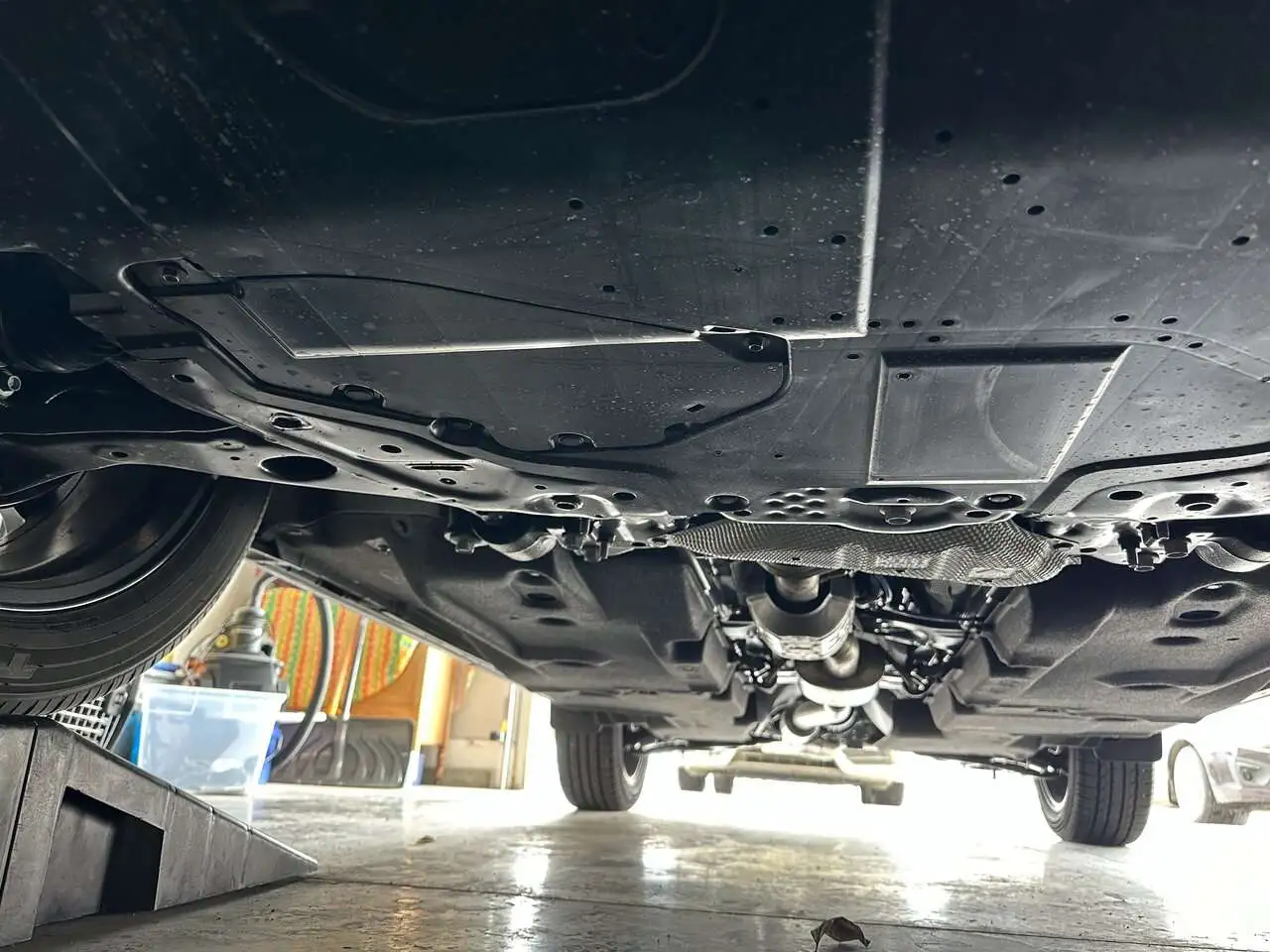

The only way to be able to hold a 5 qt jug right up to the valve would be if you had the car sitting way high on jackstands, on tall ramps, or to have the car on a lift. The lift is out for most of us but jackstands and ramps will work of course.
I personally don't like to raise the car that high on stands if I don't have to, in fact, when I change the oil in the CX I just pull the car onto my homemade ramps (raises the front by ~3"), and all is well.

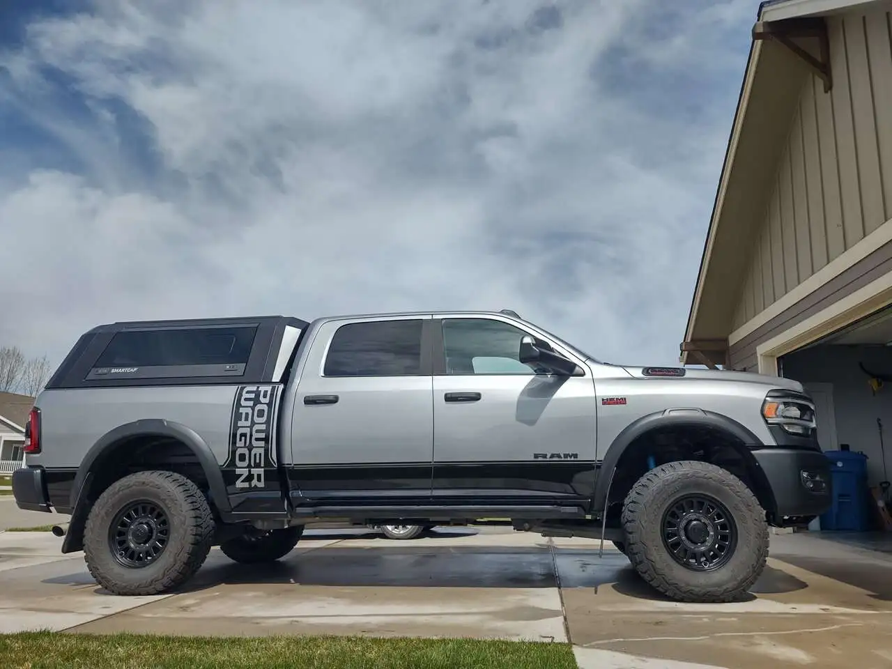

I have cheap harbor freight ramps that are easy to store and hold my 7000lb truck with no problem. I can move around under the cx5 with no problem and I am old fat guy. View attachment 325833
7000lb truck? I have one of those myself, 2003 Chevy Silverado 2500hd Crew cab long bed diesel.
No ramps needed. The truck has PLENTY of room to work with since it has plenty of ground clearance as is.

I have not. they have a rubber pad built in. I actually use 4 to put my Ram up on. Does it need to be up that high? no, but sure nice having the space.

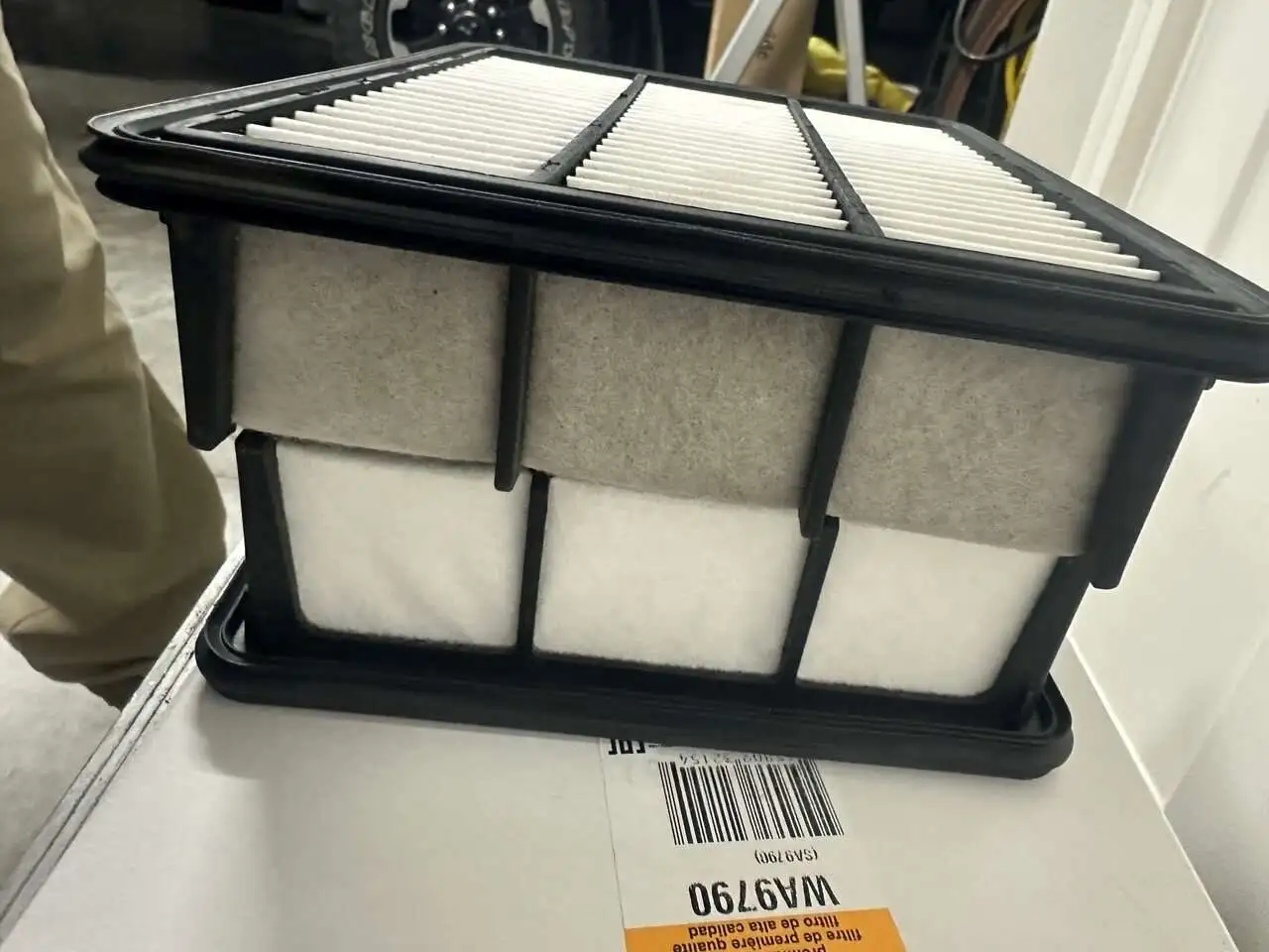

Agreed. Bought one myself last week off Amazon. Paid 17.34. Fit perfectly and looked exactly like the OEM one I removed.
