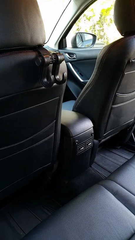

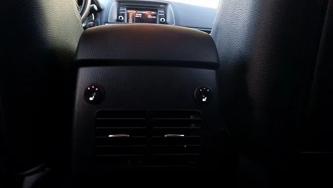

I have done this recently when I upgrading to leather seats and put seat warmer in, I thought I might as well add vents since everything is coming apart.
Like Mike said it wasn't worth the effort, as this would required a bit of fabrication and cutting/trimming parts to make this work.

I have done this recently when I upgraded to leather seats and put seat warmer in, I thought I might as well add vents since everything is coming apart.
Looks good. Electronic too!
No, those buttons are seat warmer for the rear seats, the vents are tapped into ducks underneath the seats and run thru the center console.
Oh lol. 2016 I'm guessing. Didn't know you could get heated rears on a cx-5. At least in the US it's not something you can get MY 2015 or older.
You can NOT get this option from mazda, my cx5 is a 2015 sport. I installed aftermarket seat warmers and buttons when doing the leathers from katzkins.
