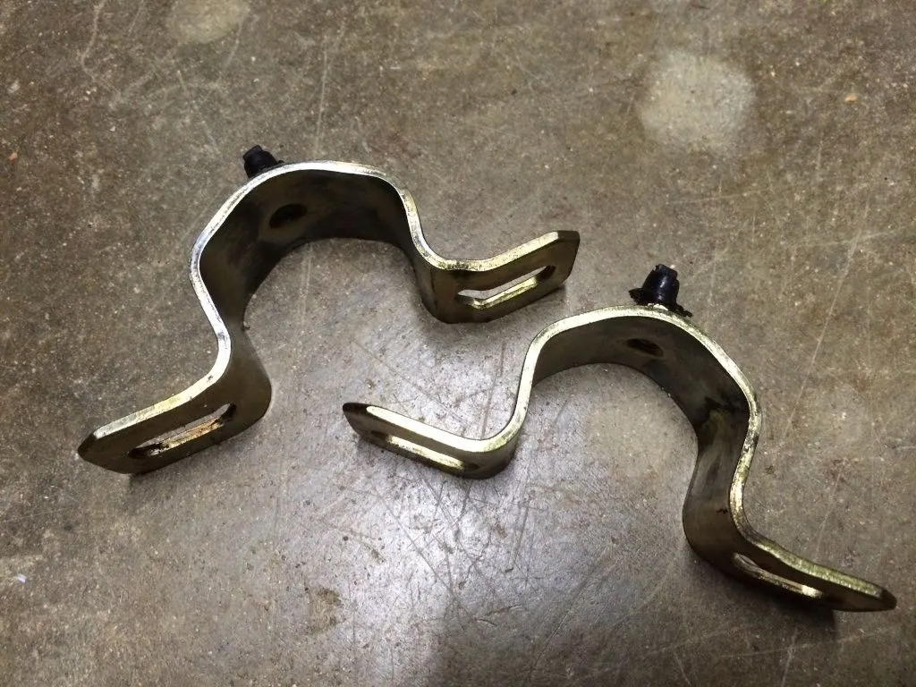

Check your mounting bracket after a few hundred miles. This is what mine looked like before upgrading to a billet ones...
attachment.php
