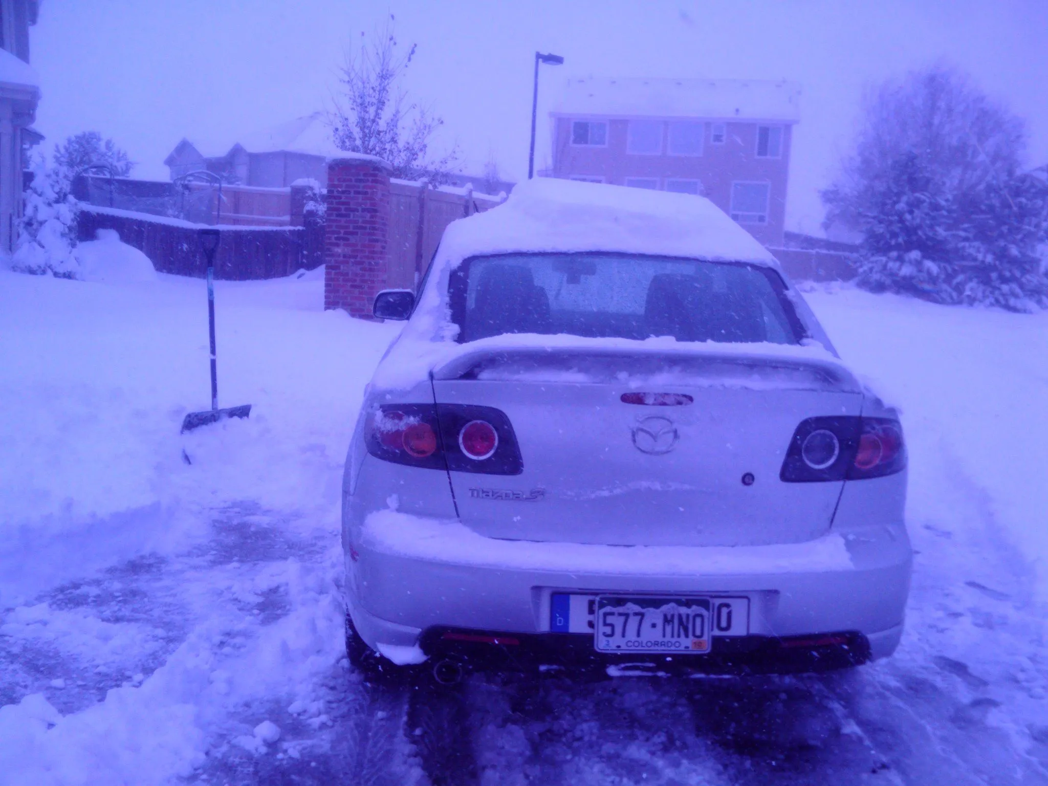

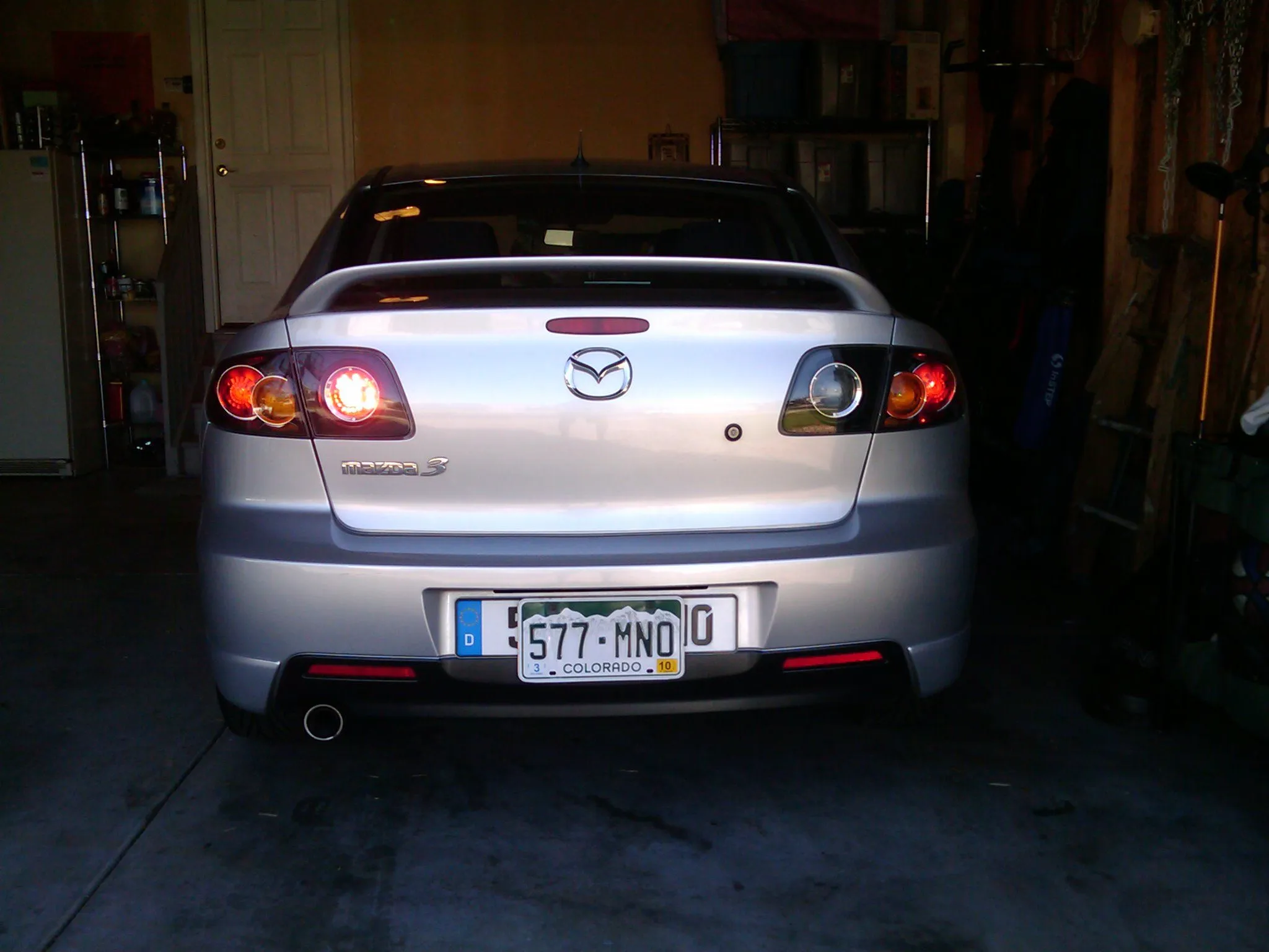

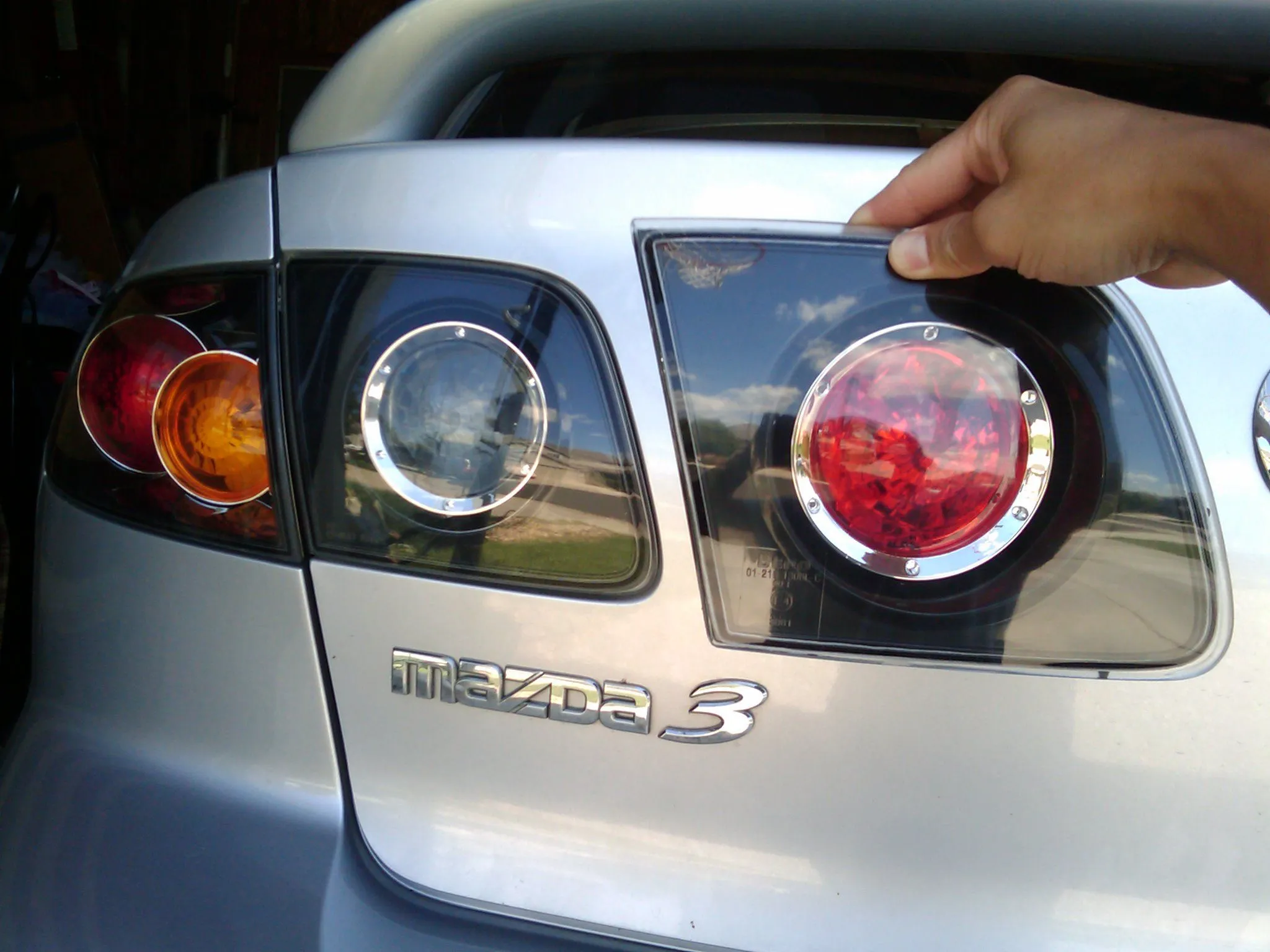

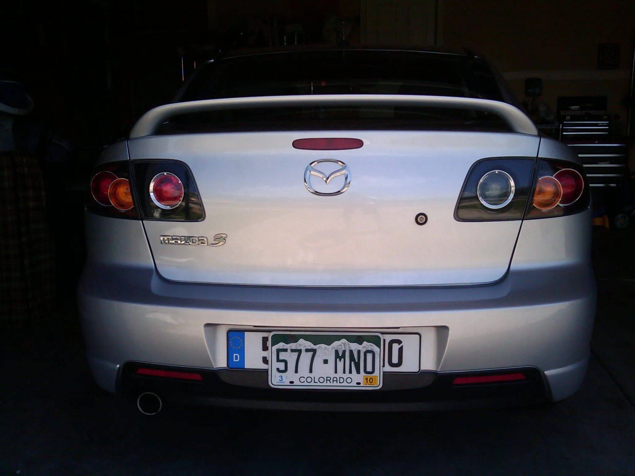

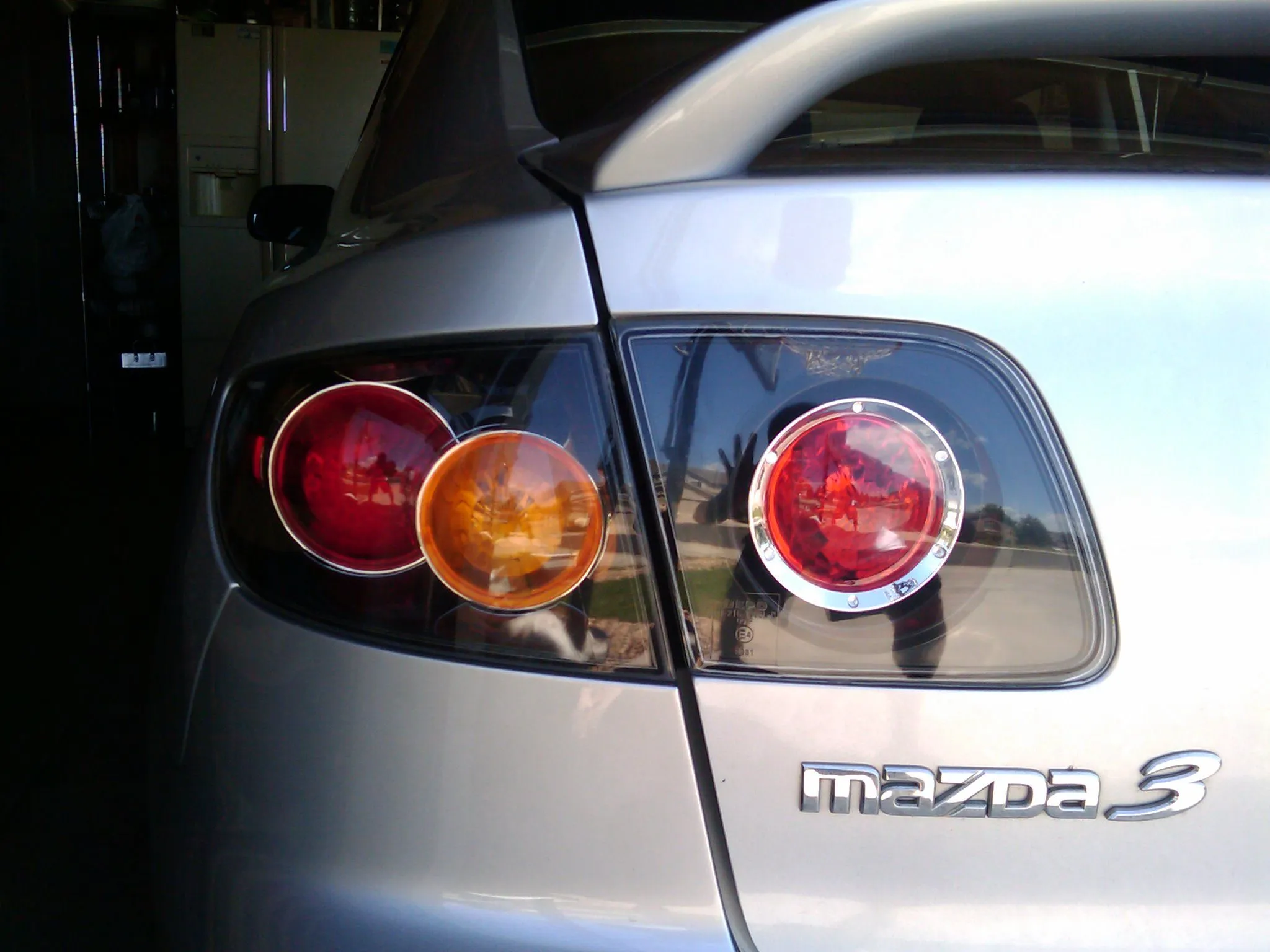

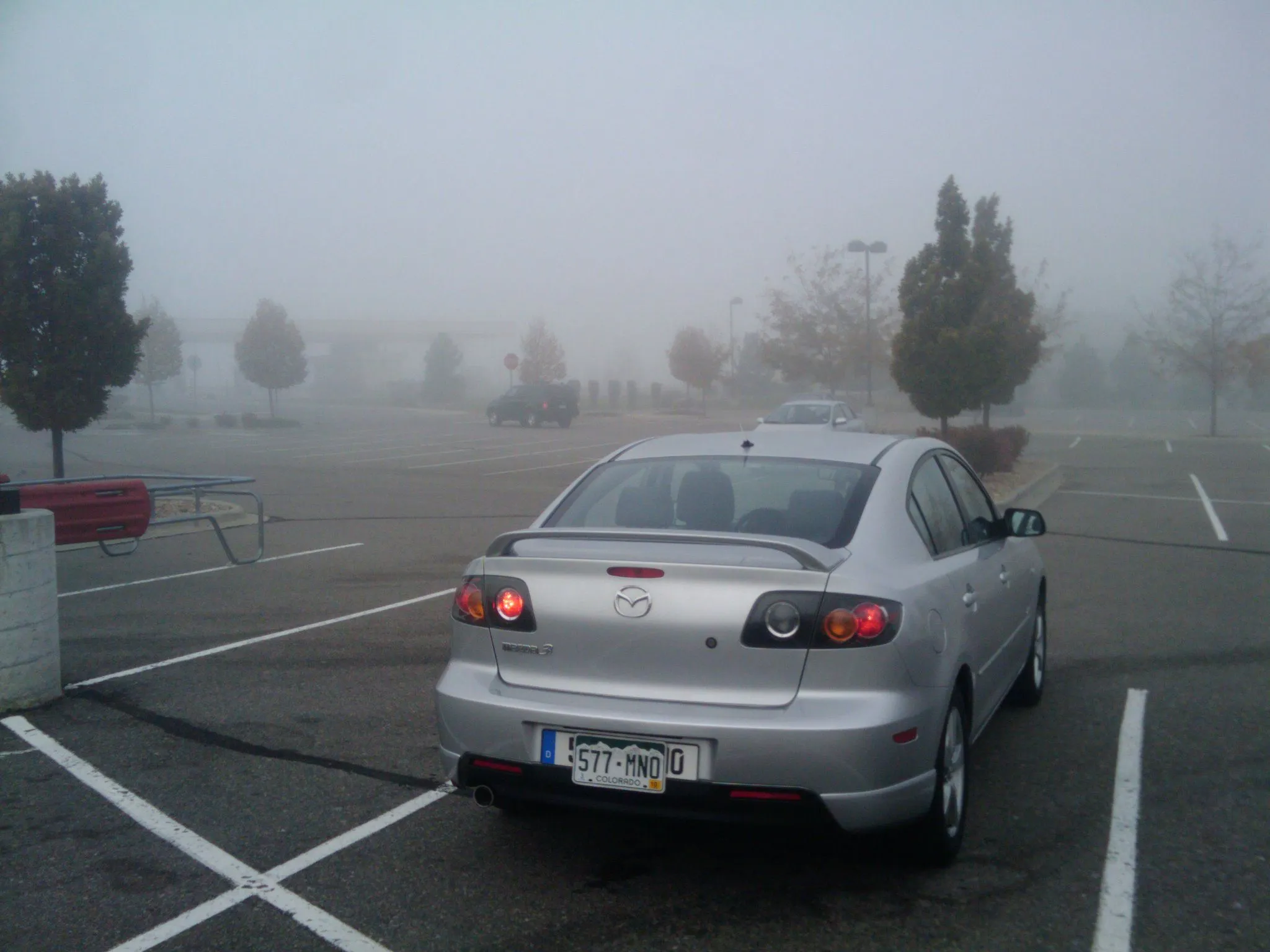

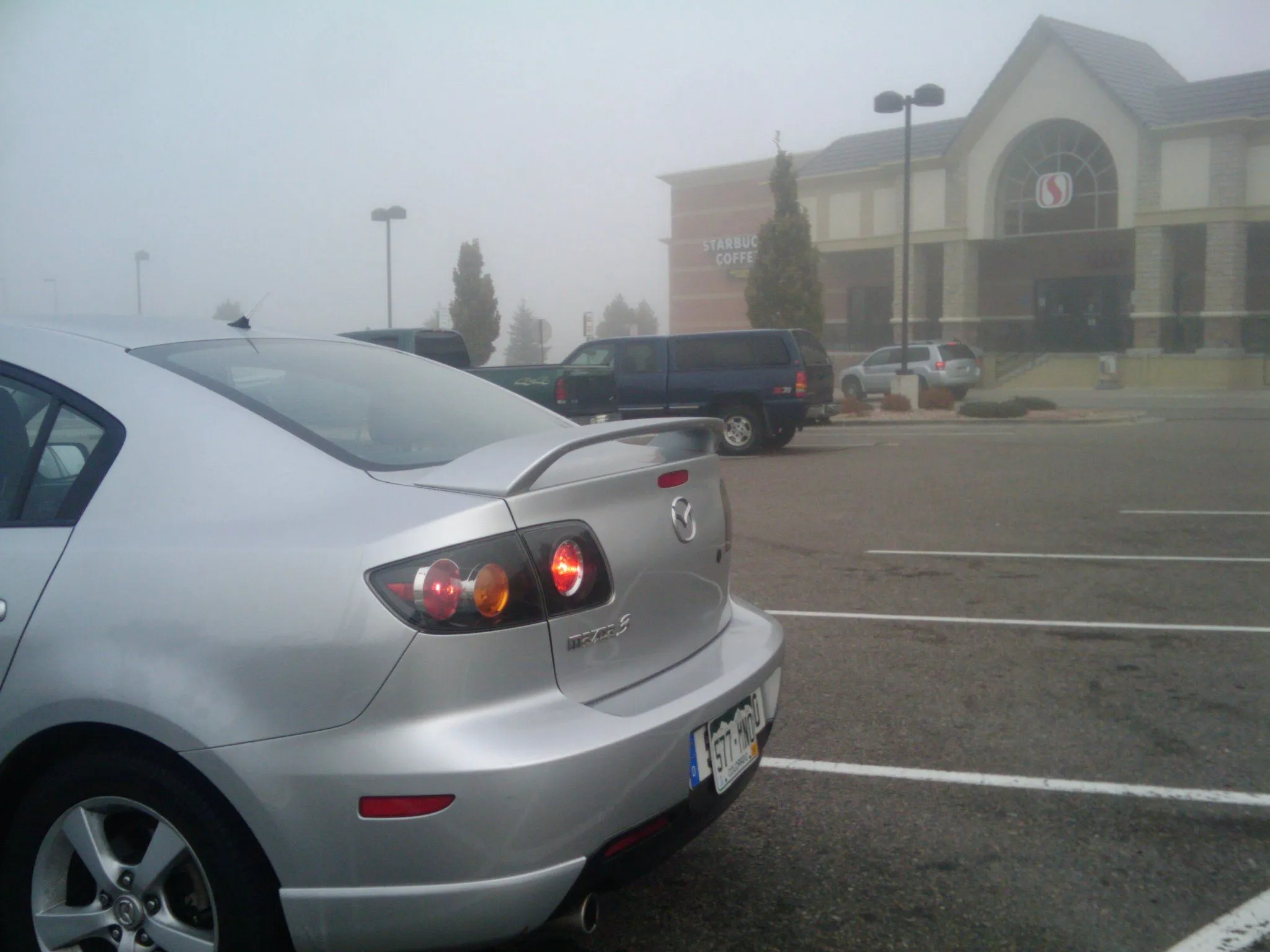

I installed one on my Mazda 3 and I plan to install one on my CX-7. Rear fog usually is only on the driver side. If you will purchase one from the UK I would be on the right side since they are right hand drive.

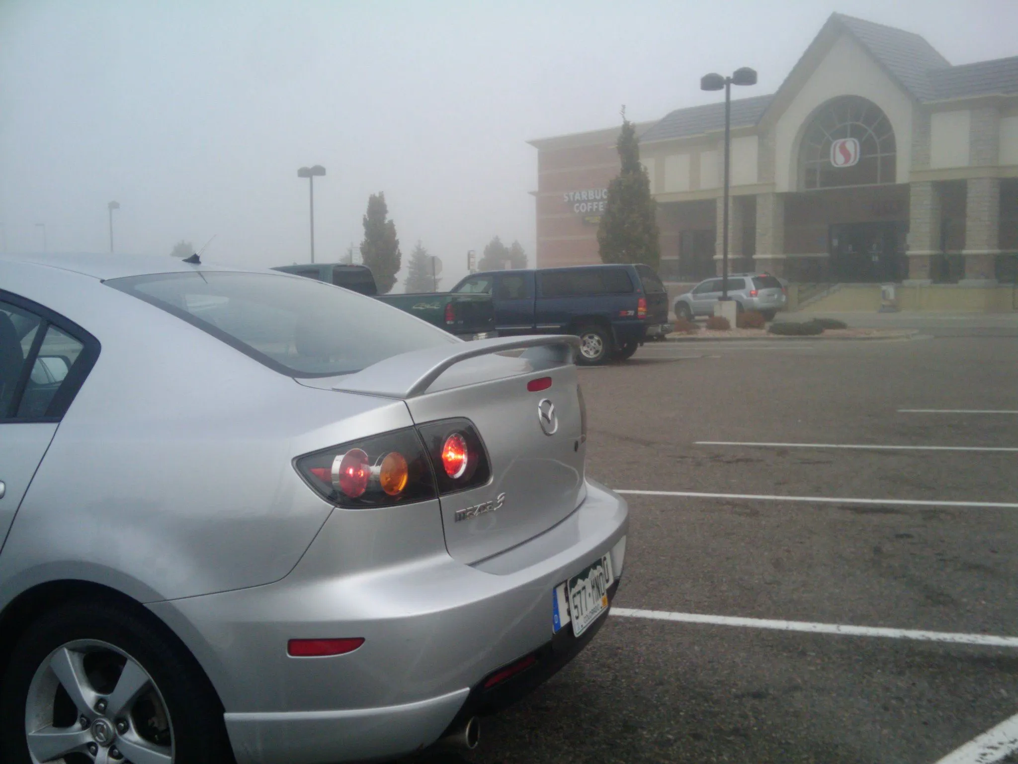

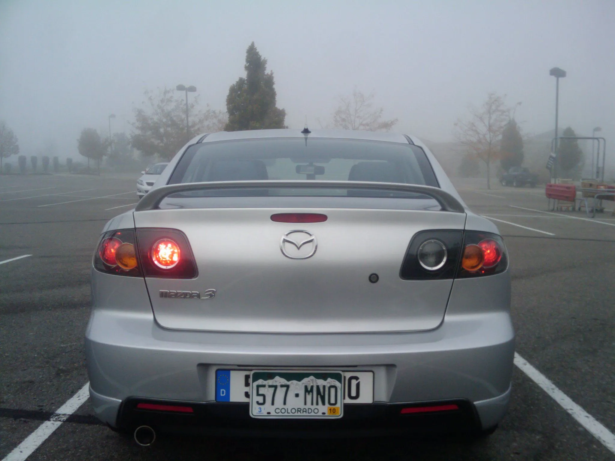

rear fogs in fog

Sorry, but the ghetto looking mismatched lights and stateside plate over your German plate makes your rear end look super trashy. I would opt for the plate in the window if you really want it, or a little Germany sticker or something.
