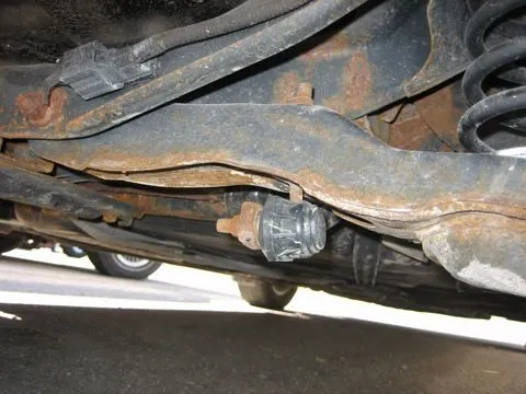

Ok, so i went and looked.
I'm not really sure what I'm looking for but nothing, to me, looks broken. I could be wrong tho.
I also took it out for a drive on a VERY bumpy road that under construction, engaging the brakes at all, even so the car barely slows, completely stops the rattle.

The endlinks appear fine, the big thing to check if you want to would be to make sure that the socket, the round part doesn't move around on the stud that goes into the swaybar. I had mine broken on my car more than once and you can't see them being broken, you have to actually push on them to see them move.
