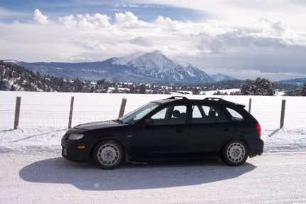

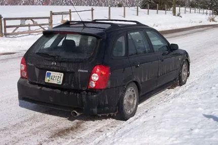

doing the right alignment will make as big of an improvment as replacing shocks/springs with performance ones..if you auto-x ALOT the toe out the rear end a little.. this makes the car rotate easyer, but also makes it a little squirrely at at higher speeds <--above 80.. but seing that you live in snow country Id say toe in the rear a little more, this will keep her stable at high/low speeds and help keep the rear end planted in the snow/ice.. my car has LOTS of toe in and camber in the rear for my winter set up, i travel from louisville ky to aspen co every jan, and im ther for a month with lots of snow.. the car does great with this set up,, and running I-70 through mountain passes at 100+ is gravy, its so stable, and lock in the corner.. just do the suspension set to your needs.. just a little front and rear toe can make all differance, also you want all the camber you can get....
the winter set up- look at the rear lots of camber and toe in- summer set up little camber very little rear toe and alot lower ride height-
