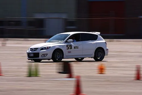

I'm no guru either, but I'm pretty much running your potential setup now on my 08.5.
Cobb rear sway bar on stiff ( not stiffest, just stiff ) setting, and MS springs. I don't plan on going with the front sway bar.
I'm also riding on RE-01R's... 225/40/18's ( bought during the 1/2 price sale... should've bought 2 sets ) on 8" wide Rota P1's. No rubbing whatsoever...
The car feels great... in STU, I'm right on the heals of ( and occasionally beat ) modded STi's, and I've taken 4 out of 5 events from a buddy with an '08 STi - stock - but with the current Azenzi...
I'd tell you to install the springs ( and the rear camber links ) and go play.
Cheers.

MS springs
Yes, I'm happy with the springs. No complaints... the drop is not too great, which is probably why it hasn't become too harsh, but enough to be noticable visually to the trained eye...
