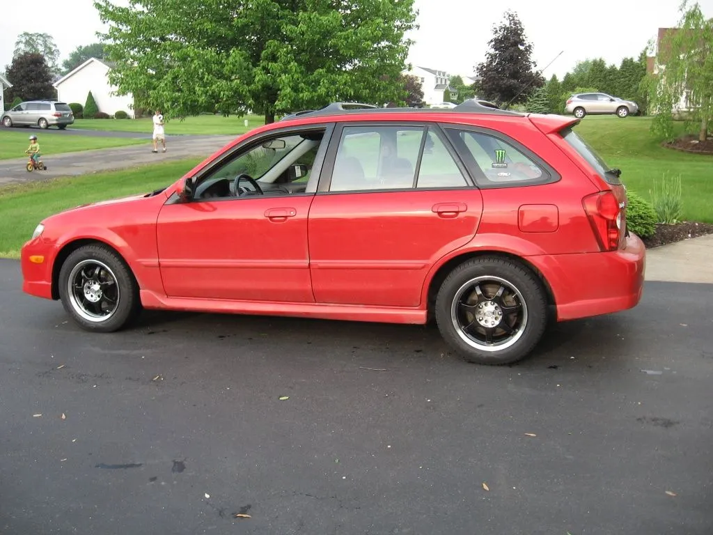

I got some good advice from reading this forum so I thought I'd post my wheel and tire change in case it helps somebody else. I've got a 2002 Protege5 with 110K miles on it. I had enough of the low profile one direction tires in that hard to find and expensive 195/50/16 size, with terrible wear, and awful in the snow, blah blah... So I wanted to drop down an inch in rim size and get a higher profile radial tire. I finally did it and am real happy with the result.I went with Discount Tire Direct, and bought the MB Seven X wheel with black spokes in 15x6.55 size (15x6.55-100/11438GBM) and the Hankook Optimo H727 195/60/15 87T DSB tires. That calculated out to be .8" higher sidewall, and .5" larger overall diameter, which only puts the speedometer off by 1.4 mph. Discount Tire mounted, balanced, and shipped for $629. That included gorilla lug nuts and hub rings. That's alot better than spending $400 on just tires in the stock size, every 20K miles...
See attached image for the result
