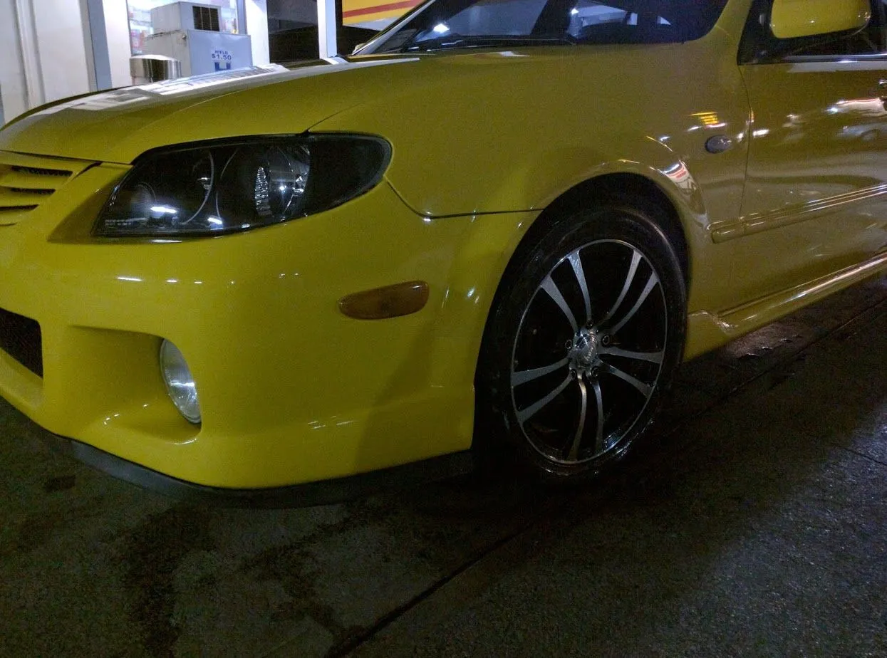

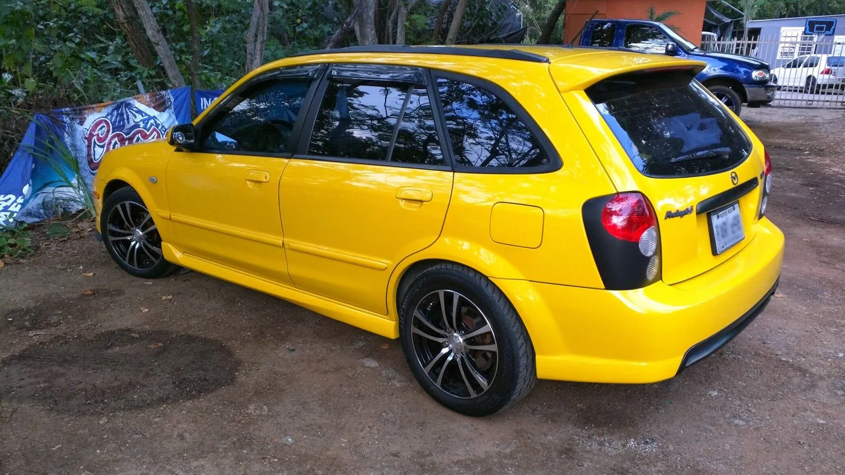

Originally had KYB GR-2 Excel struts. I started getting klunks and replaced them with Stagg Gas Struts. Turned out to be broken rubber on strut mounts and bad plastic bearings in the front. I visually inspected the Staggs and no leaks, no obvious signs of damage. I can rock the vehicle and I cannot reproduce the noise, only when driving. The wagon doesn't bounce around its actually quite stable, no signs of sagging either. Seems to be slightly dropped (I purchased it like that and that's all I know). Attached are images for reference.

I cant tell clearly from your pics if your car is lowered or not however I remember when I put eibachs on my p5 I had to use some washers between the top hats and the nut that holds them on because the tokicos werent threaded down far enough on the shaft to seat the spring and it was reported it would wobble around and cause a clunking noise. I read that and added the washers when I did the install so I never experienced it first hand. Perhaps thats something to look into. that and make sure you have all the nuts and bolts torqued down properly.

youre welcome. there are several threads about using the lowering springs and clunking. they are visibly shorter and as a result you dont even need a spring compressor to reinstall them. if it was that easy to replace struts for you you probably need the washers. if you needed a compressor chances are you dont need the washers.
