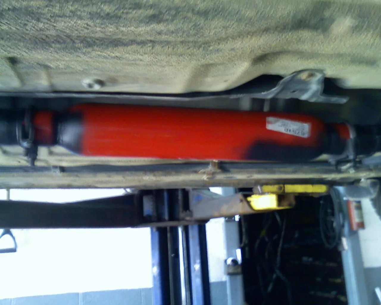

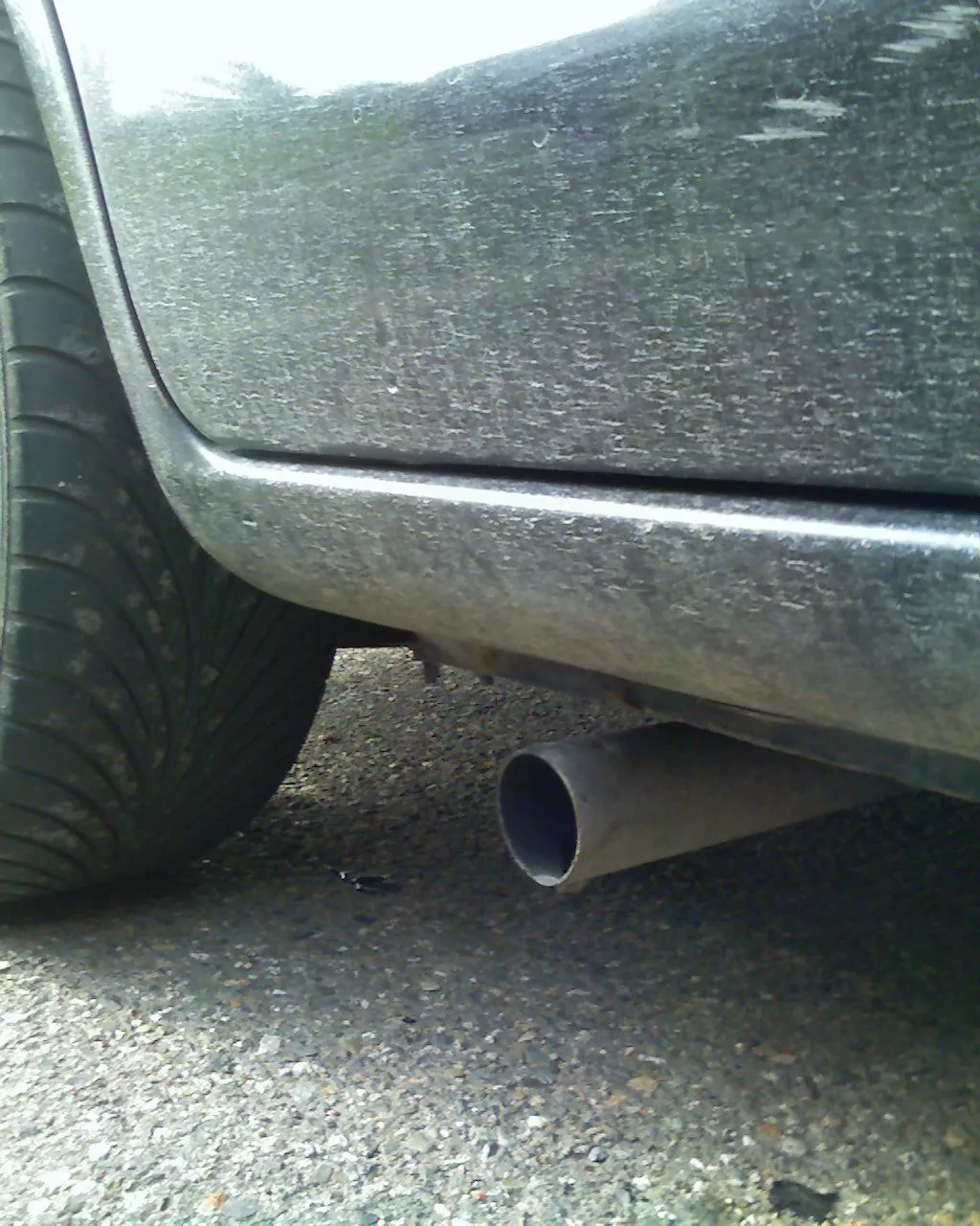

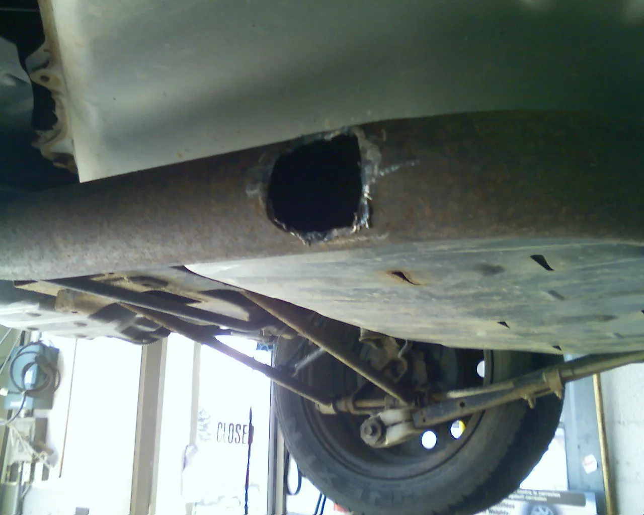

Im also throwing in a few picks of my exhaust; the usual ricer muffler wasnt my style so I took a more redneck approach.
Resonator was replaced with a cherry bomb and I welded on a side pipe. Im going to have it manually valve operated next spring. (sorry for the low quality cellphone pics)

Interesting exhaust.
your one of those guys who i hear drive by me, and i look at my friend and say
"probably has a hole in his exhaust"
sigh
sigh
haha i was thinking the same thing...no offense man, i am all for the "do it yourselfer" but at least save a few bucks and put a rolled tip on the end of that thing and make it somewhat presentable.

no i dont think it was a bad idea. i mean you just put it on, obviously your gonna make it look nicer. but why do you have a hole there? i dont get that part?
the molding just peals off. i think a blower dryer would do the trick. just hold the blow dryer to it, then start peeling.
I cut the hole in the exhaust pipe after the glass packed muffler( 2nd pic), and then welded a pipe over it, coming out the side of the car(3rd pic). The exhaust fumes travel trough the passage with the least restriction, which is the hole covered with the side pipe. I kept the stock muffler in the rear, so when I don’t want to be loud, I can simply cap the side pipe and the exhaust fumes travel trough the stock muffler.
The side pipe is then legal, loud and hard too see (that’s why it is flat black). My car is stock on the outside, it's more for go than show.

im still not convinced about the exhaust, i think your losing power, because in order for the exhaust to travel straigh through, that sidepipe would need to be plugged all the way to the weld... if your just sticking a plug on the end, i believe your causing unnecessary back pressure, and restricting the flow.

I hadn’t thought about the exhaust creating back pressure, but then again, it isn’t often capped... I'm working on having it valve operated next spring, with the valve being close to the original exhaust pipe, near the weld. It will be redneck, once again.

As for the exhaust, most all of your exhaust will take the path of least resistance, which means it will continue on the straight line path out the rear of the exhaust. Gas doesn't like to go straight, stop, make a right angle turn, and then go straight again. Sure you'll get some exhaust out of it but essentially you just have a hole venting to the side. KNowing a little about turbulance will tell you there may be a buildup of turbulent air there, essentially slowing the gases, making less power.
As for the cherry bomb you put on there, I sure hope it is a straight smooth perforated core, not a louvered core like 99% of the resonators out there. If it's louvered you're already down on power.
Not sure what you're going for but an exhaust cut out is best UNSEEN. What have you done of rpower? The P5 is underpowered as it is and super loud ass exhaust won't change that.
Having a rear tailpipe and a side outlet just gives everyone the impresion that you don't know what yu are doing. Maybe you do, not sure by looking at that setup.
I'd get rid of the rear pipe, put a 45 degree bend on the pipe and direct it out the side. At least then it'd be the real deal.
I won't bash you unless you tell us you have the stock muffler up there still, if you do, take it off or forget the whole side outlet thing, that's just retarded.
