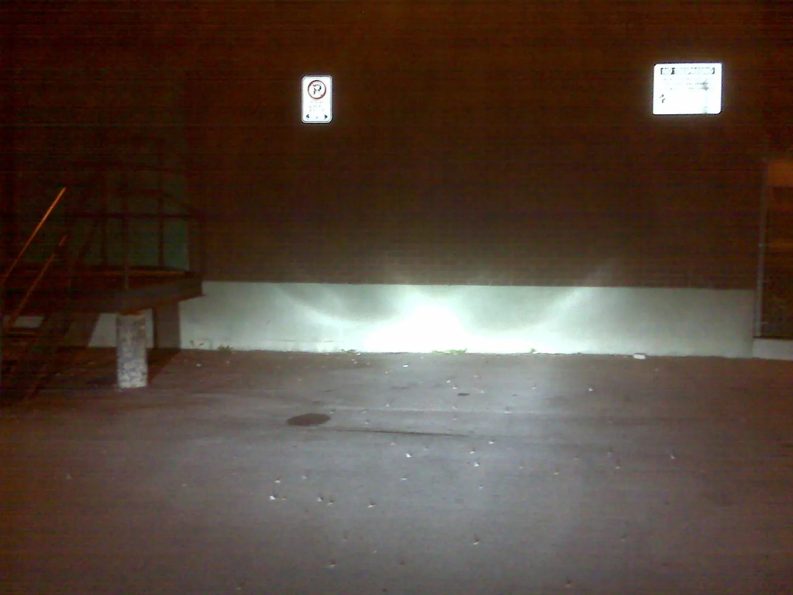

Here is a pic I took a few days ago with the phone in my camera (poor quality) before my glare shield mod. The lights were aimed down towards the ground. There is a lot more usable light now and no glare. I'll take some better pics to show how they currently look as well.

dude, that looks horrible! glad you got it figured out, though.
Yes I was really annoyed when I saw that pattern on the wall. I aimed them down to the ground, drove home and put the halogen bulbs back until I figured it out. A cop pulled in to the parking lot when I took that pic ...he sat there for at least 30 mins. I had to wait until he left before I could leave. lol

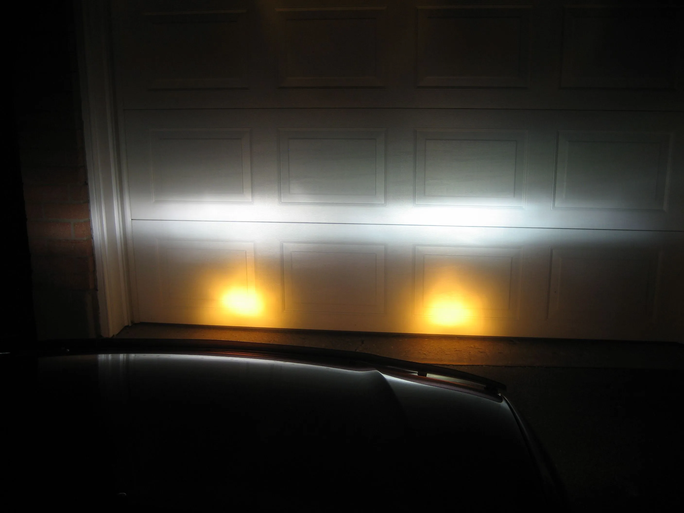

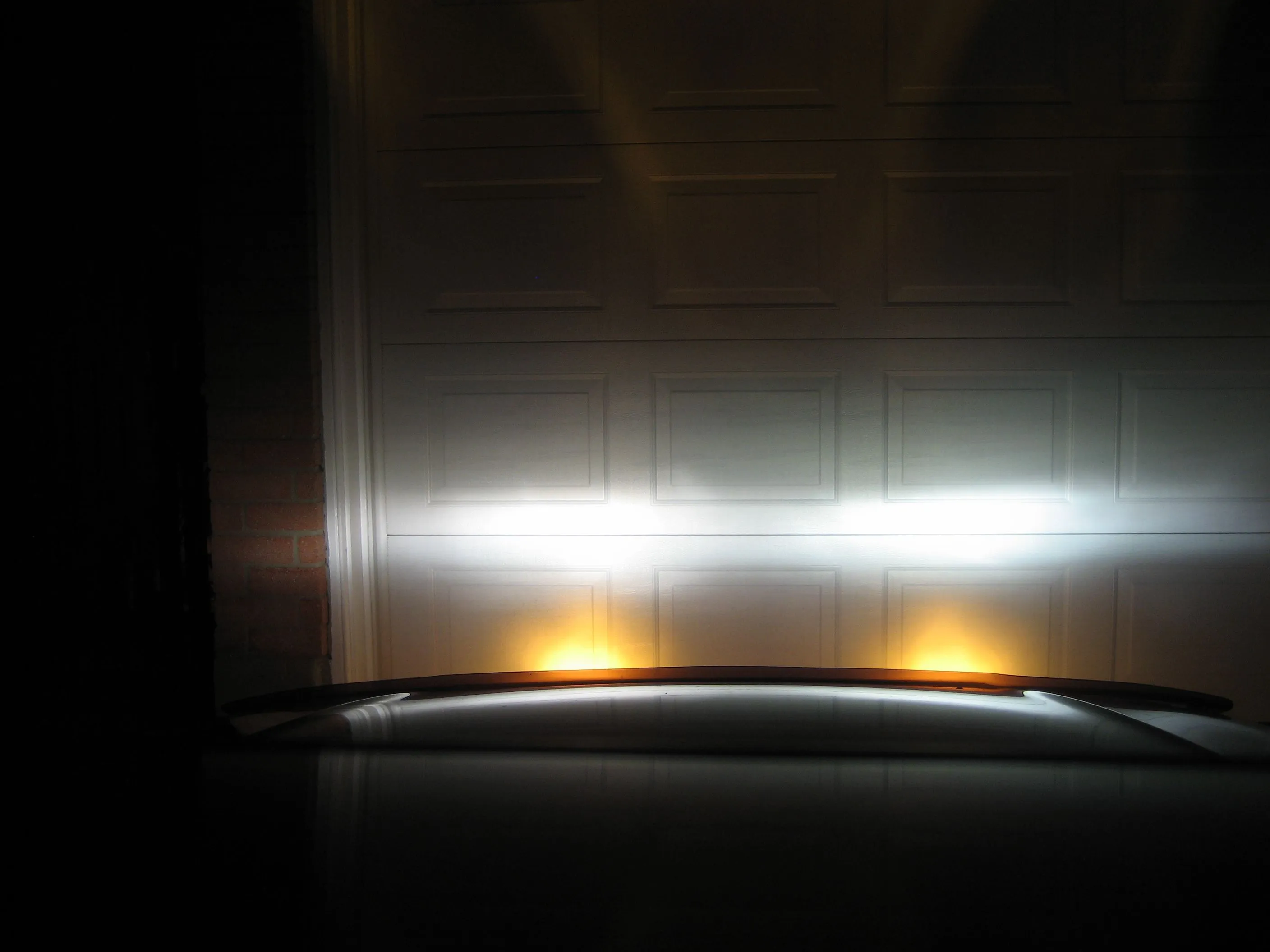

Here are a couple of more recent pics with my glare mod:
