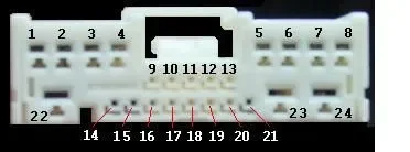

I'm looking to wire up my Premium Boost guage this Sunday and the friend helping me asked me to get any kind of wiring diagram I can to aid with the install. Can someone help me out with where I should hook up to. I read the instructions today but I'm not at all familiar with car electronics and he is. Thanks for any help

I tied into the back of the radio. The wire runs were shorter and everything is easy to find and identify. I set mine up for amber all the time, so it was
Black - ground.
Red - battery.
Orange - accessory.
White - not connected.
Edit: I just realized that you may not know how (or want to) remove your radio. If so, sorry about that.
The attached files should be what your friend needs.

Awsome thank you! I want to leave mine orange all the time to match the car so that's perfect! The guy helping me used to do all sorts of electronic installs so we should be good getting the radio out.
