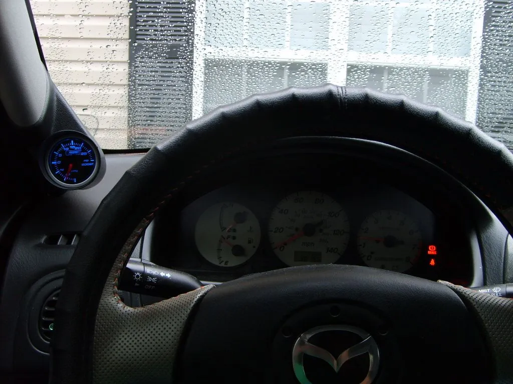

got a prosport blue mech. one in mine and love it reads perfect. thats just my 2 cents. sd530102.webp

got a prosport blue mech. one in mine and love it reads perfect. thats just my 2 cents. View attachment 98284
Where did you get that gauge pod? Would it be possible to use something like that on the MS6 since it has the curtain airbags there?
it's a autometer single gauge pod. as far as the airbags i don't know about that you might have to put the gauge somewhere else.
