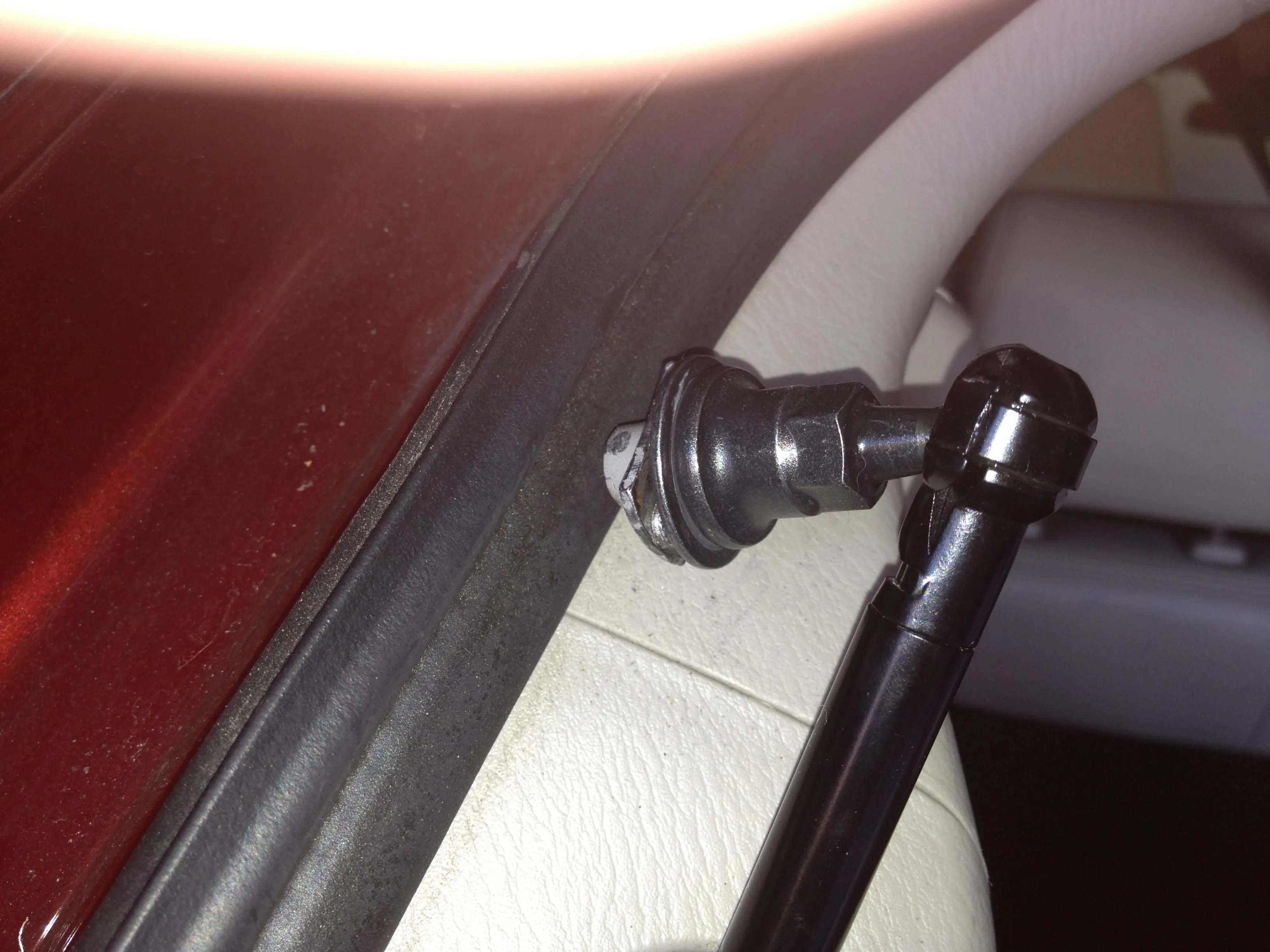

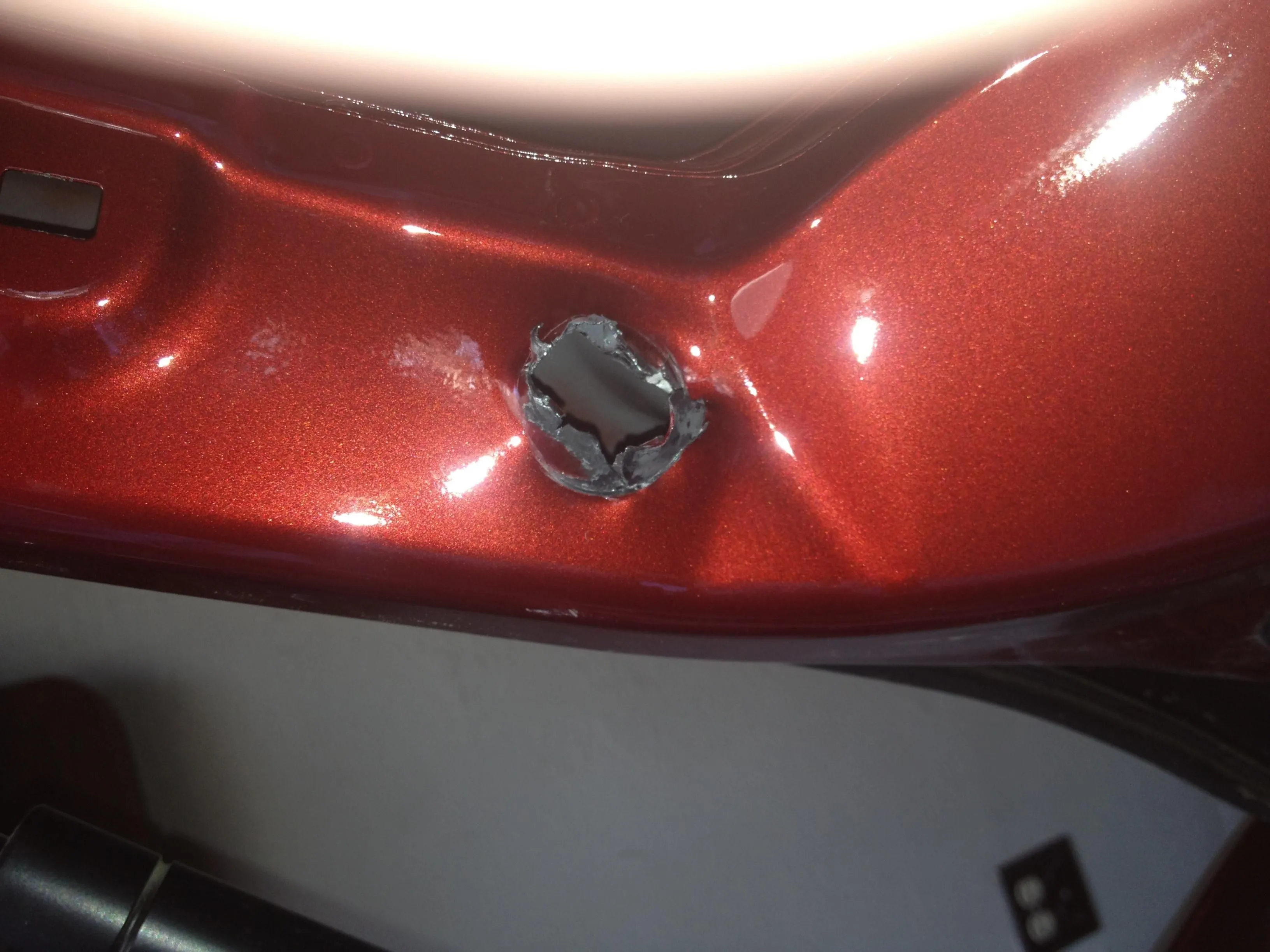

Pictures of failed auto lift gate
Here are pictures showing where the metal fatigued, and the second if of the bar. The dealer said they had seen this one time before. I think I'm just one of the first of many to have this problem. Too much pressure was being put on a small section of sheet metal, and it gave out.

Doesn't look like natural failure to me.
It seems like someone tried to ply it off.
Look at the damage on the metal.
Talk to a body shop to see if they can patch it up for you.

We are the original owners and didn't do anything abnormal. We use the power opener ~6 times each day on school days, but this is probably normal for anyone with kids. I've really love this car, and I'm angry that Mazda or the extended warranty doesn't cover this and for the poor engineering of that mounting plate.
We inspected the sheet metal and there is no reinforcement in the area where the mount is attached. Just sheet metal with a small backing plate of about 1" x 3/4" (you can see it in the picture). The hatch is large and the location of the mount is near the hinge, so it must take a lot or pressure for the motor to open and close the hatch. 4 years of opening and closing many times each day caused the metal to give out -- I'm convinced that others will start seeing this same sort of failure.
The service department at Mazda said there is a "bulletin" on this problem, but not enough for Mazda to do anything about it. One guy in the service department said Mazda would have covered it had it been under the original warranty. They have seen one other owner with the same problem.
Totally agree that a good body shop should be able to reinforce the area and fix the problem. The inside trim covers this and it is not exposed to weather, so not much need for painting or corrosion protection. Frustrated that this will come out of my pocket since we paid for an extended warranty and this is a manufactures defect (time will prove this claim right or wrong).

I took a close look at the ball and socket design on my power litgate today, used a flathead screwdriver to move the rubber aside to check for any bent metal or so forth and everything looks fine. I did note that the threaded ball which screws into/onto the liftgate shell is not centered in the middle of the rubber flappers, but this is likely just due to the trim piece... likely just manufacturing imprecision on the trim piece.
I do have a theory on this though. As the part with the ball on the end either screws onto a threaded stud or has a threaded stud and screws into the liftgate shell (you can see an area on it where you can tighten/untighten it with a crescent wrench), if this part comes loose/starts to come unscrewed and is being pulled and pushed on, I could see how this failure could happen.
That would be my theory is that part coming loose and in turn causing the metal to fail, rather than just the metal failing with no other cause.

Funny I read this thread...for some reason my power liftgate stopped working, doesnt close when opened manually, or open from the dash. When you press the button you hear an audible beep, beep, beep. So I figure great another trip to the dealer, gee that sucks I was just there having another issue fixed plus the 30,000 mile service that cost $530. So, low and behold I'm removing items from the rear of the car yesterday and I notice the trim is all banged up and dented along the edge of the gate. The power liftgate arm is flopping in the breeze and there is a huge hole in the top of the gate simular to the pictures posted above. There is no sign of the ball that the arm attaches too. I imagine the whole door needs to be replaced or welded, but at this point, this is my 3rd "new" car (02 explorer, 07 mazda6, 10 cx9) and this one has been in the shop more than the other two combined! I am ready to paint the darn thing yellow and drive it thru the showroom window.
