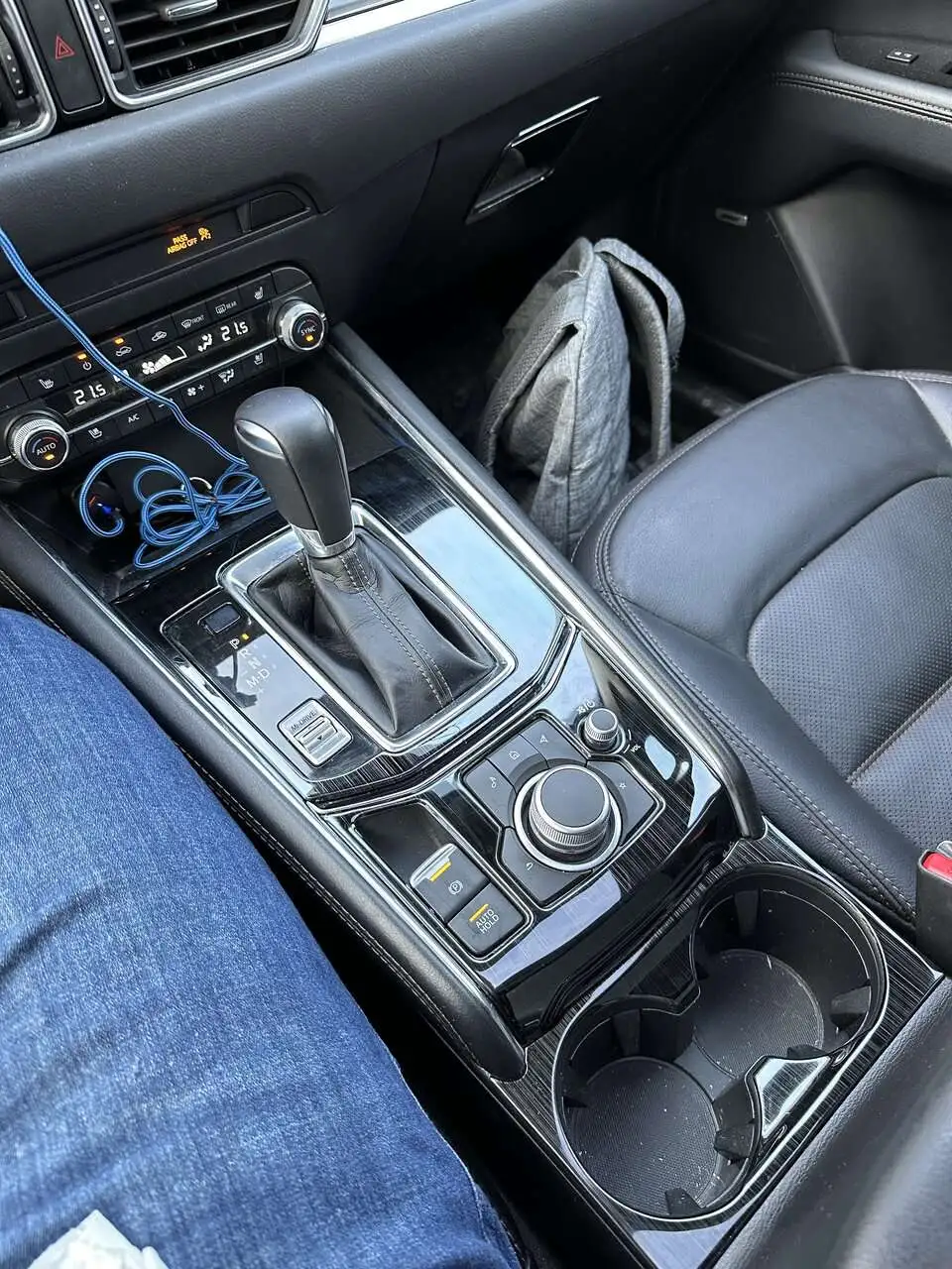

Installed the trim covers that I got from AliExpress. (Center console, window panels, and a couple more pieces) There are a couple of scratches on them and I am trying to arrange a solution with the seller.
I like the quality and managed to install everything in 10-15 minutes (except passenger side window panel due to the lock/unlock button).

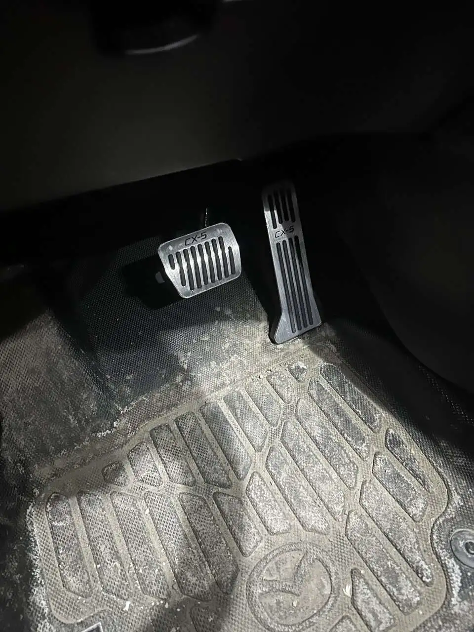

Aluminum pedals: Got them from AliExpress as well. I ordered the footrest piece as well but my winter mats cover that area so I'll install it when I switch to the cloth mats.
They are all metal which is a great plus. Brake pedal replaces the OEM plastic one, accelerator slides over the existing one (great design choice, arguably better than Mazda). The footrest uses double sided tape.
Feels slightly better when driving (obviously aside from the 30HP I gained). Design-wise they look great except for the CX-5 text which firstly uses the old font and secondly isn't super high quality. No one's going to pay attention to that, and at this price point I can't complain.

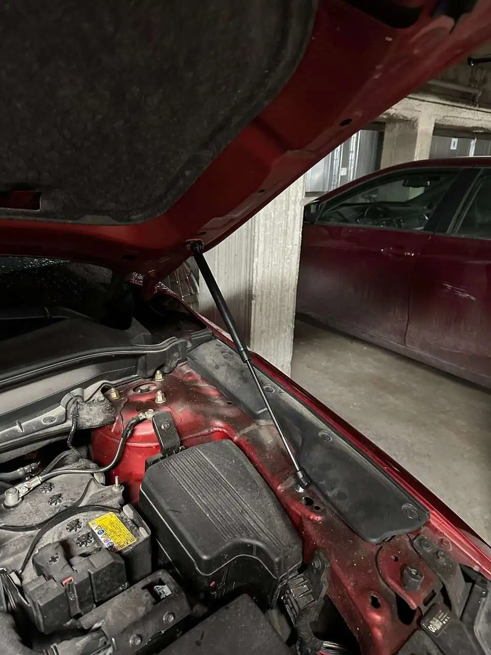

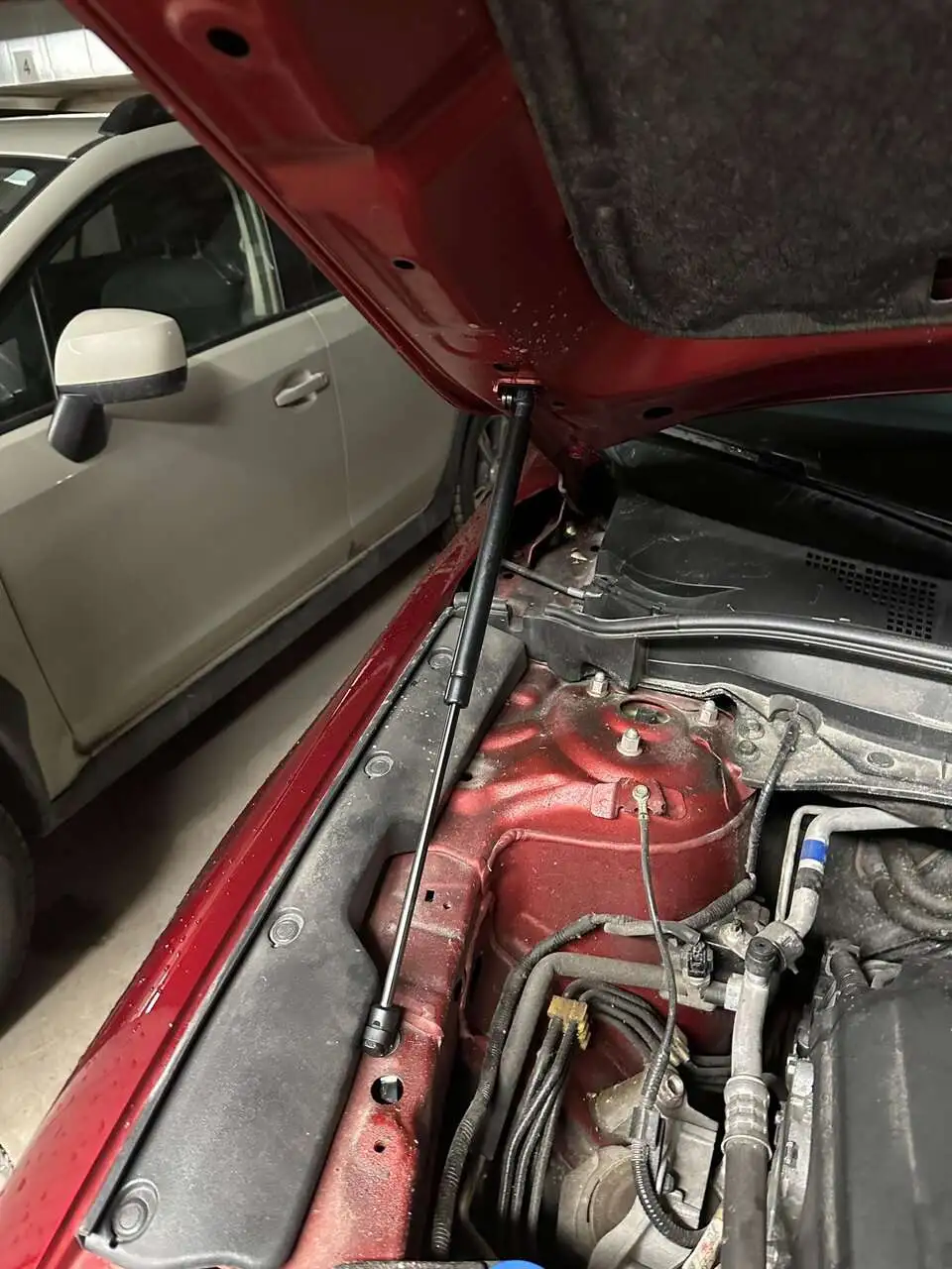

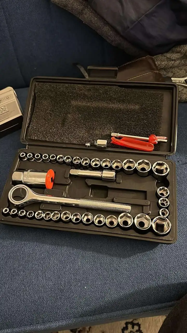

Installed hood struts. Got them from Amazon, had to refer to installation videos on YouTube as there were no instructions in the box. Broke the nut driver as well as the adapter for smaller sockets in the process. (It was a cheap set from Amazon, you get what you pay for)
One trip to the hardware store later, I managed to finish the installation.
When installing these make sure that you tighten all bolts properly, especially the ones that hold the hood.
