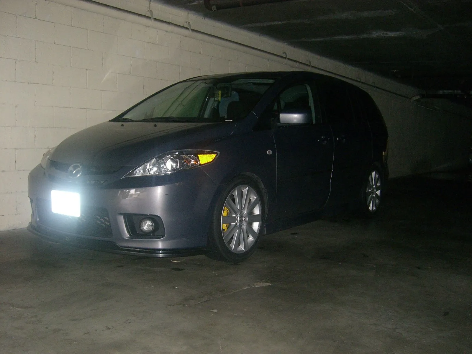

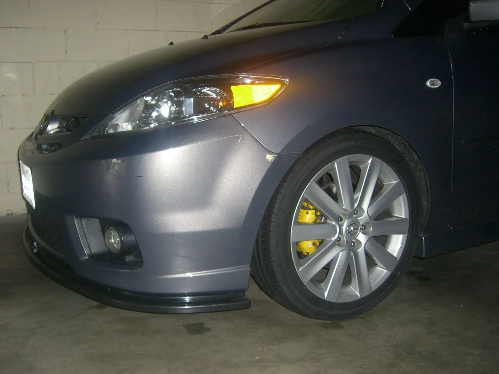

Just got some new shoes and lowered her.

Please post some better pics! We want to see the results!
What suspension? Did you have to get a camber kit for the rear?
I know these are bad pictures but its raining here in LA. When the sun comes out i'll take some better pictures after a good wash.
I got H&R Springs for the 5 with the Mazdaspeed Camber Kit. The drop so far seems to be 1.5 inch around but i am sure it will settle some more. It does Hot Rod a little but i can live with it.
The Camber kit is a must. When i did my alignment, the rears were perfect. I got everything from the Captain. Good deal. Thanks Captain. I finally had time to get it all done.
The ride is smooth and i still clear all speedbumps and and most driveways. The splitter i have does not help though but i love it. Also, moving up to 18s helps out. I am riding on Falken 912. Good tire for the price. It not like i'm gonna track the car. Enough rubber to not worry about potholes and not too much so i am driving on dounuts.
Over all i am very happy with the look and the ride. I wish i could go lower but i still need to drive my Kids around with ease.

So you are riding on stock shocks?
Did you install the spring and camber kit yourself?
How much $$$ did the whole process cost? Spring + camber kit + alignment?
Sorry for all the questions...planning on lowering mine soon (eekdance)

I got a package deal for the Springs and Camber kit. I'll have to get back to you but if you go to the Captains site look at the prices and just reduce it a little.
Lowering and Aligment - $230
installing the camber kit is difficult on the exhaust side. Yoy have to move the exhaust out of the way off the rubber enclosures to get to the bolts. If you have the tools its not that hard. I just rather pay someone. :)

and yes i am on stock shocks. the ride is great and better than before. A little stiffer.
