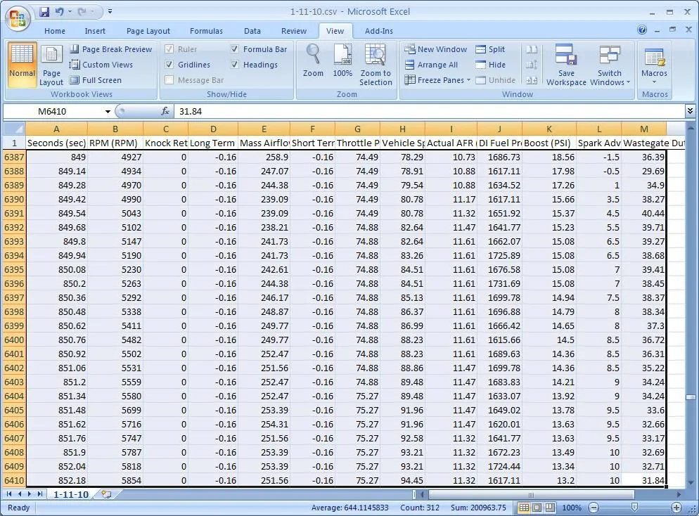

here is a log from today. how does the WGDC look? i really dont know where it should be at.
It looks like to me that your wastegate is staying closed more often to create little to no boost. The system looks like it sees the low boost and is doing what it can to generate boost but you're only hitting 11's and 10's.
