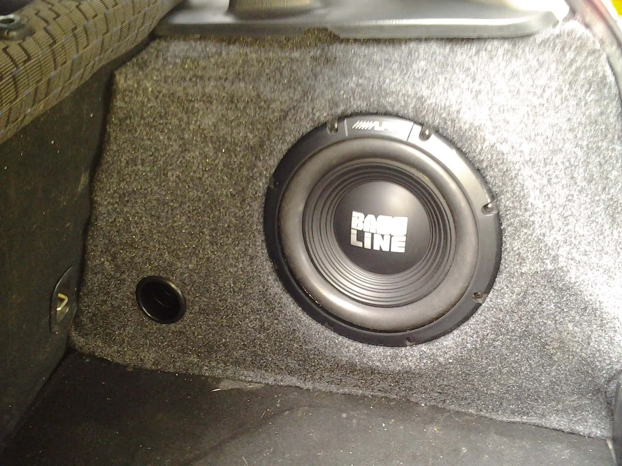

Here it is almost done...used a write up someone else posted a while ago for the general idea. The box was supposed to be sealed but when a rough estimate of around 2 cubic feet of volume came out, ported was the only option. Some 12s can use that much space with a sealed enclosure but not in my price range. This is alpines new entry level sub which sounds really good in this box. It sounded ok while it was sealed still but you could tell the sub was straining. After cutting the hole it sounded better and after getting the port inserted now I am really happy with the results.
There are a few imperfections but for the most part it turned out pretty good. I also dynamatted the entire back of the enclosure which helped a lot because the fiberglass on metal rattle is not a note I like to listen to.
I will post up some final pix once I get the carpet and everything in place and cleaned.
Enjoy

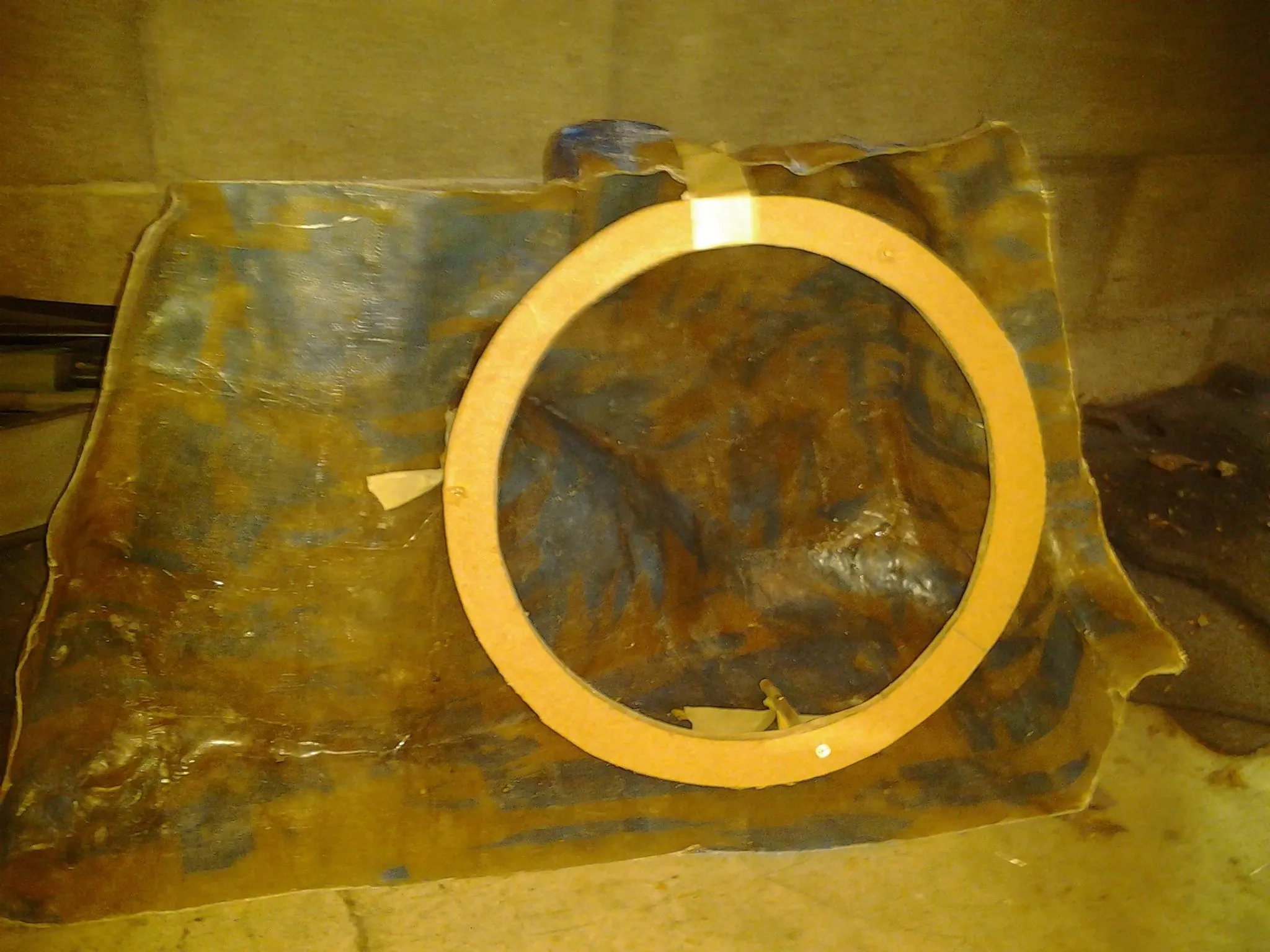

Attempt number one was very ugly and that's when I read the part about making sure the matte was fully saturated the first time. I thought I could go back and smooth it out. The first picture is my first attempt.

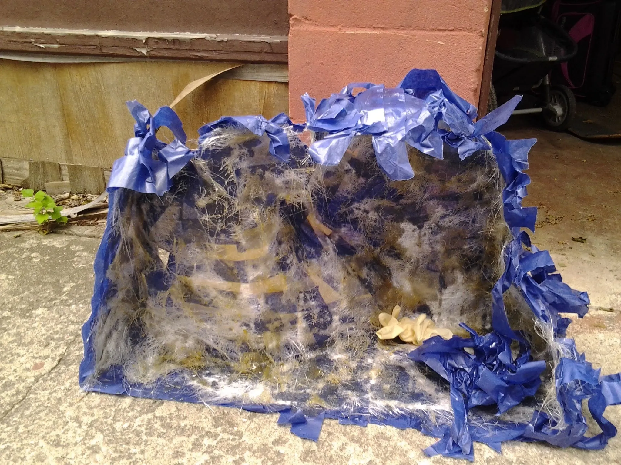

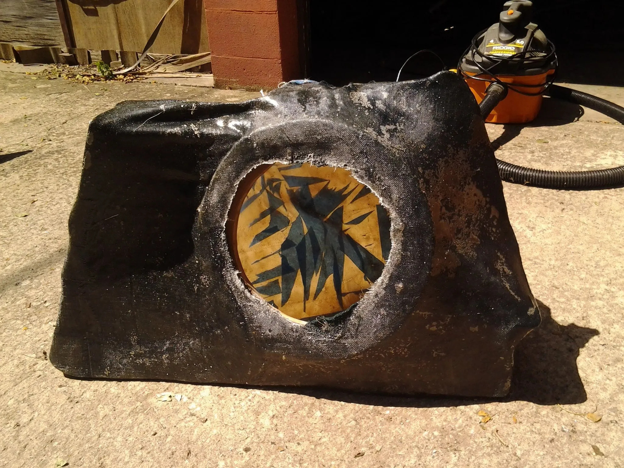

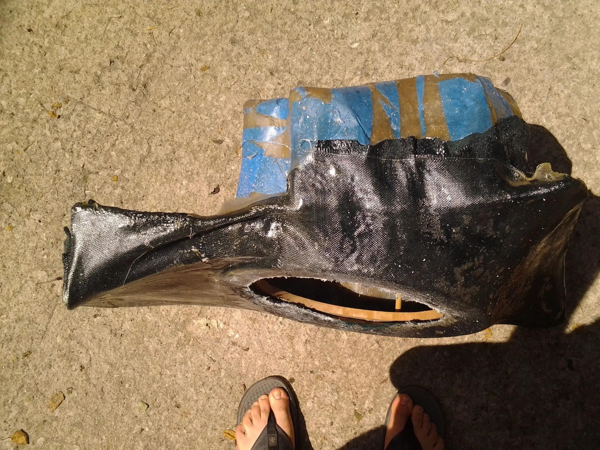

My second attempt was too specific in size. I shaped it to the car and made it so you couldn't get the box out without breaking the box which is good because I pulled it after 2 layers. What I had was useless as a box but a great mold. Using tape I just brought the box in more, cutting space in the areas I needed to and smoothing it out in other areas(as much as I could).
Things I learned and hope help someone else.
1) use the good tape like everyone says...it adds to build cost but is so much better to work with. Crap tape is why I have waves in the part touching my seat.
2) don't build on a tight budget, this being my first time I wasted a lot of matte and a lot of resin. My final box is only 3-4 layers thick on the back and has only polyester front with one layer of cloth
3) taping and getting down your first layer are most important. I was only able to work during my sons nap time so I could only get down 2 layers then had to do 2 more after it cured, it would have been much smoother and stronger if I had gotten all 4 down at the same time. So don't have a budget on time either
