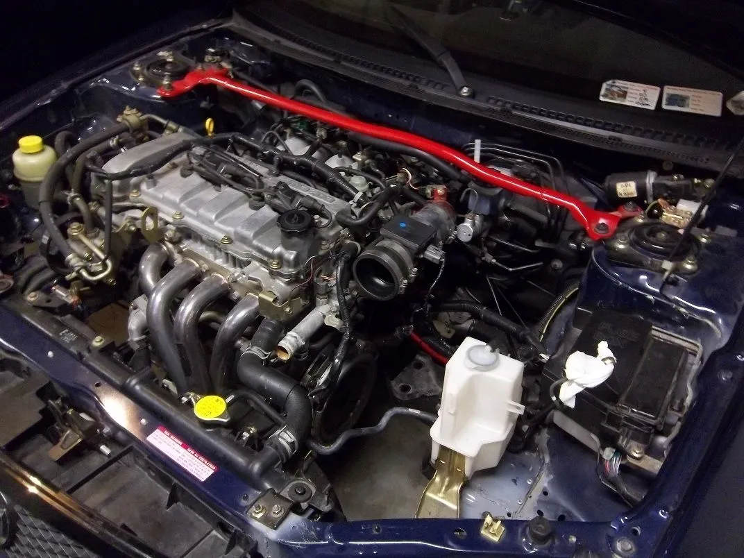

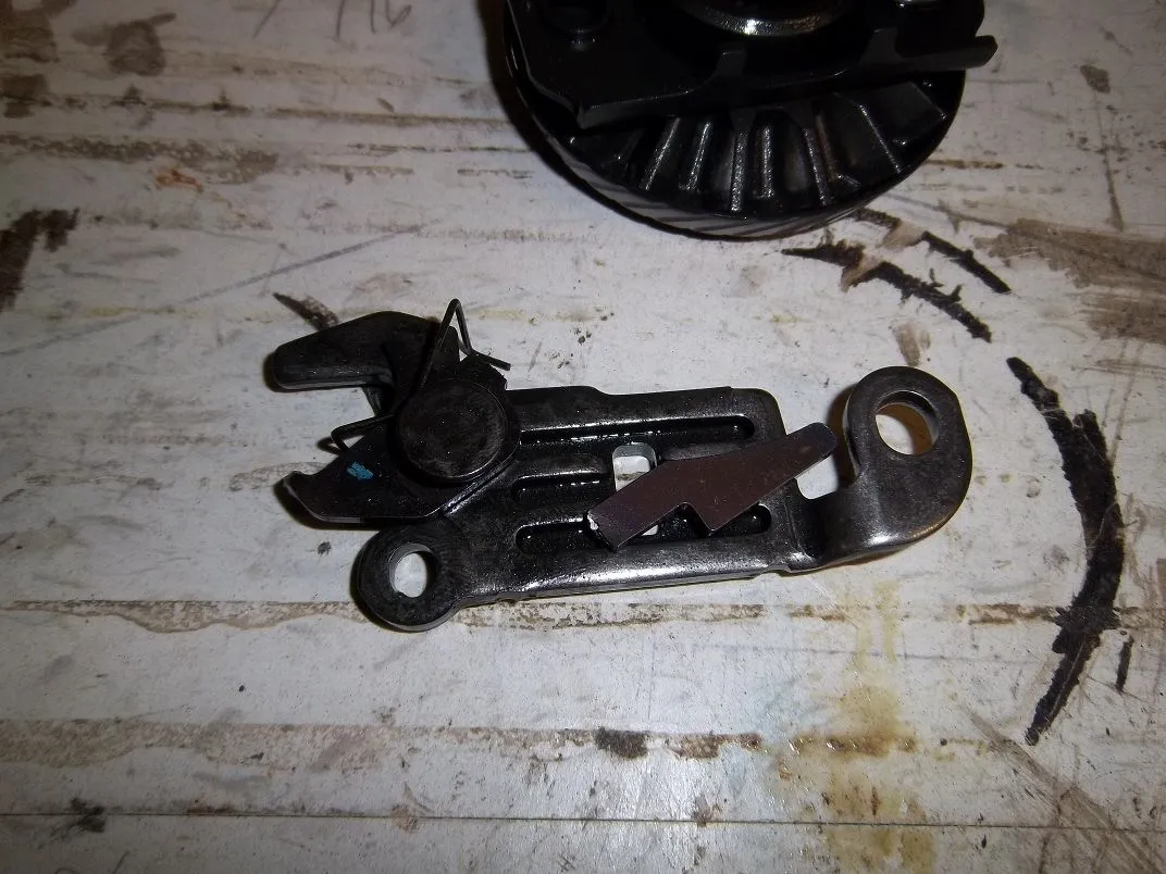

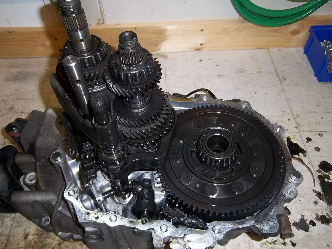

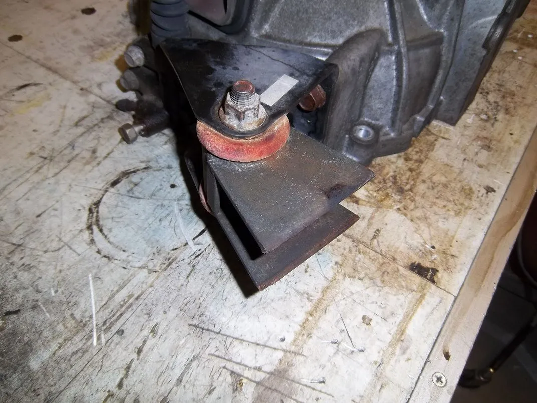

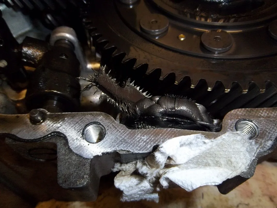

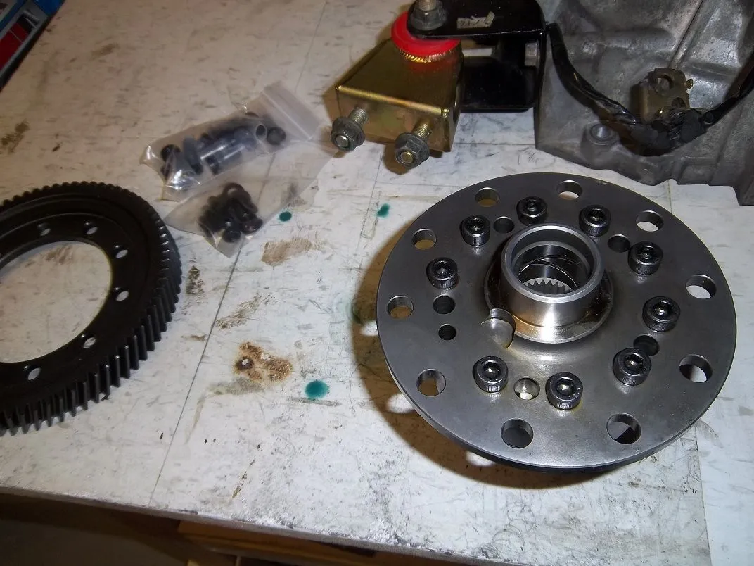

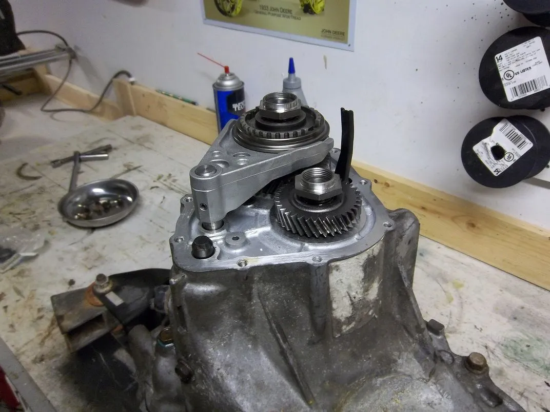

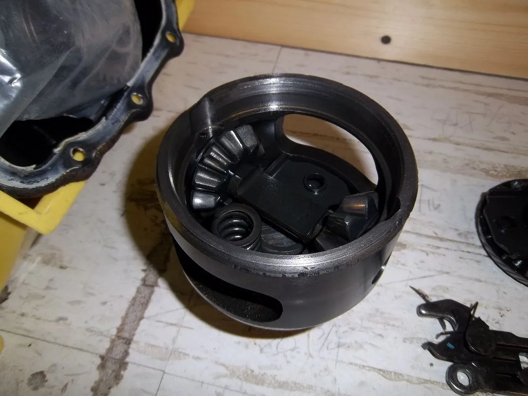

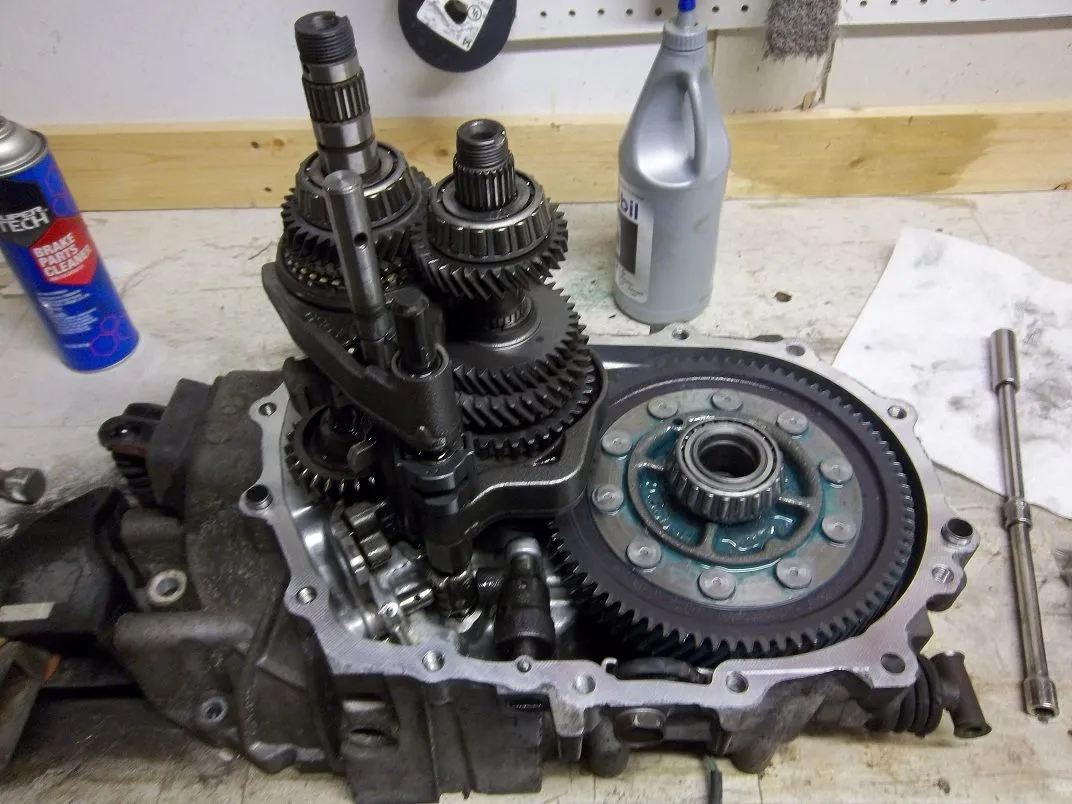

pulling the motor and trans makes it sooooo much easier. of course I don't have any accessorys so that also makes it much quicker. But I found out that I wore out the engagement teeth on third gear and the syncro sleeve teeth, not the syncros. that was fine. I looked at them last time they where out and I could not properly gauge how bad they where, but when the new third gear came in it was abundantly clear they where ******. so ****** I busted about 75% of the teeth off of the sleeve. put in a new 2/3 hub assembly, third gear, bearing, but held on to the third gear syncro because the new one did not have the carbon friction contact area and the teeth had no wear on them. Also with the mazda motorsports development discount I got some awr front and rear motor mounts for cheaper than you can buy just one of them.
I hope this helps someone, but I will not be able to test this till next season. but even with the motor out I still had to buy a deep well extractor socket from matco to get the nuts off for the rear m/m. damn near pulled the car of the jackstands before they let go!!!!

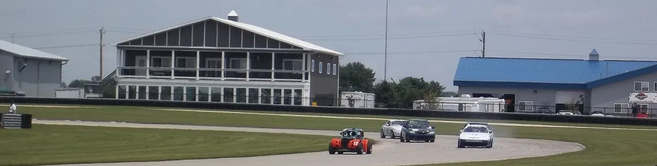

OH YES! third gear works great!!!! some of me and my dog at the track! 100_0623.webp

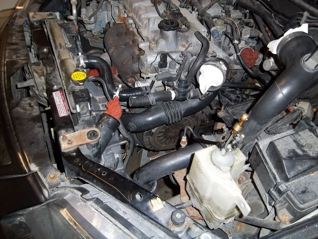

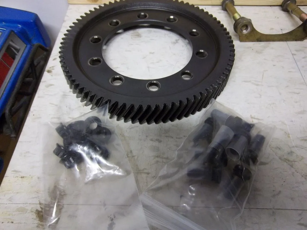

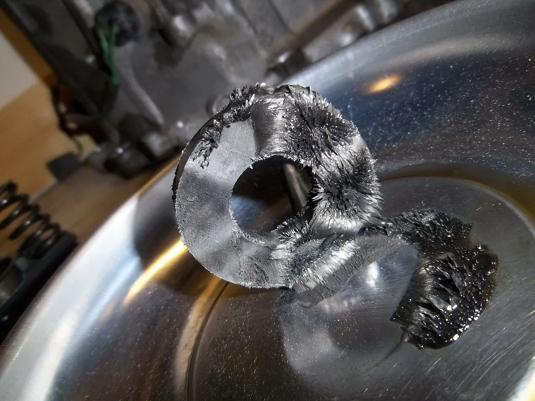

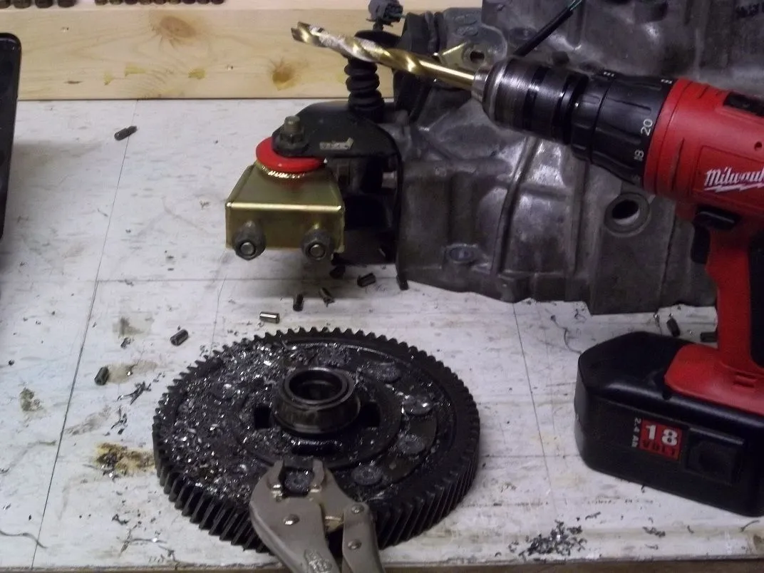

getting close to closing it up!!!
