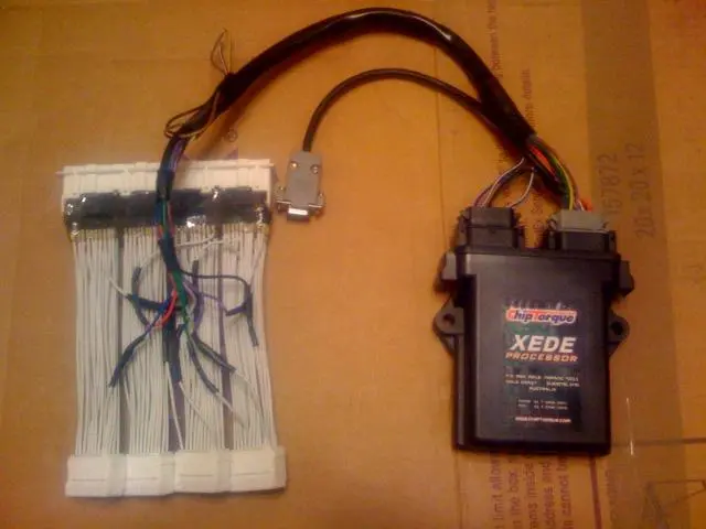

yes it would. the factory setup is very consevrative compared to what you can tune with the XEDE. you'll have full control of boost, fuel and ignition spark. the unit comes mapped for a basically stock car and you'll see gains right out of the box. of course there is more potential with modifications.
Does the XEDE allow fuel-pump specific tuning? TB Control capability? Ready to ship?
I am exploring my options, but in the market.. I have the CP-e ems sitting n my garage, first ones released but idk whats the best without spending $1500+ for a standalone... can I get your honest opinion?
thats not a black and white question. both systems have thier merits. we have experience tuning both but definetely moreso with the XEDE. in the end they are both interceptor systems with the limitations and capabilities that interceptors have.
there is no reason why the XEDE cannot take advantage of larger fuel pumps, etc. there is not a specific menu for fuel pressure but you be able to manage injector timing and fuel flow through adjusting the MAF values once more fuel pressure is available to you. no system has throttle control as of yet. thats something best suited to a standalone or complex add on, neither of which has been developed. you can partially tune around this by holding more boost longer into the RPM range but in the end the throttle plate cannot be overridden. you can control fuel, timing, clamp the MAP signal, datalog results, control boost and just about everything 90% of the people want from most systems.
we've able to get just shy of 400lb/ft of torque on the dyno, stock engine, stock fuel system, pump gas, no methanol and a 12.8 second 1/4 mile time with a 1.8 60ft. there is no argument to made about 'usable horsepower' here when you have those numbers. these are not numbers easily, if at all, replicated by any mazdaspeed6 out there with any assortment of modifications. thats the best testament i can give to the XEDE and its the number one reason why we have stuck with the system, because we have gotten results from it and continue to do so.
if we get further into it will we outgrow the system? naturally i think so, and by the time we get to that point I think there will be newer, better and more expensive options in a standalone market.
does this come with a cd for your laptop or computer ????
yes we have software to tune the XEDE called XMAP. the only thing you will need for use is a laptop with a serial port or a serial to usb conversion cable.
Ken, can you please make a graph comparing the XEDE to Standback?
Can and cant's or does and dosent's?
they literally both do the exact same thing. the interface is obviously different bewteen the two units. both of them can control timing and fuel. both of them can set RPM/load based boost spikes. both of them control boost. both of them can clamp the MAP output voltage to help prevent boost/fuel cut. both of them have the ability to datalog in real time. the standback's interface is probably more user friendly for the uninitiated when it comes to engine management.

Plug and Play harnesses for the Mazdaspeed6 are finally here. For those of you that don't know, this is the system we use on our Mazdaspeed6 with great results.
http://www.mazdas247.com/forum/showthread.php?t=123680546
http://www.mazdas247.com/forum/showthread.php?t=123688302
Now, no more wire chopping, no more warranty worry and simpler install. Just unplug the ECU, plug in the XEDE and ECU into the harness and away you go!
Retail on this system is tentatively set at $1099 shipped.

Biggest thing that is pushing me to standback is the connection to a laptop, the way I understand so far is the Xede uses a old style serial connection. I thought they were dropped from anything computer related over 10 years ago.
I would still like to see some kind of graph comparing the 2.
Or, where can I find out the same info that dada posted about the Xede?
