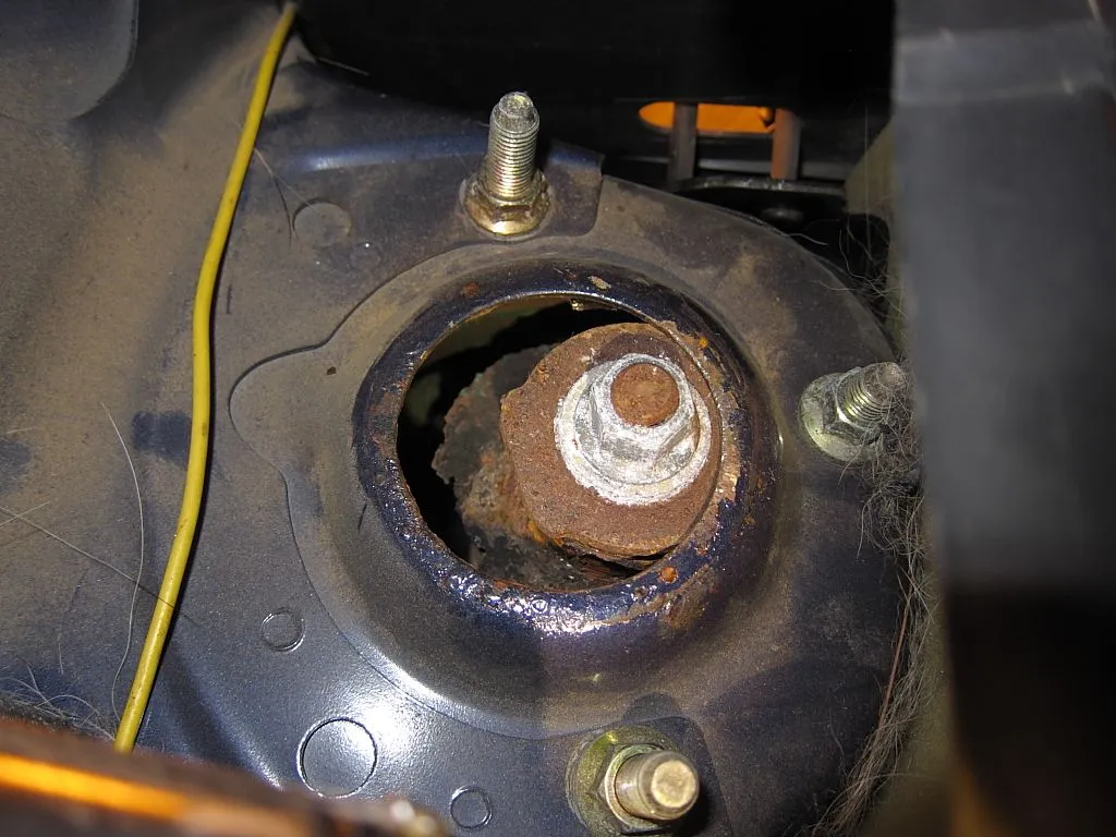

Bumping this ****OLD**** thread. While I haven't taken the hatch area apart yet to confirm, I'm getting crazy knocking/clunking noises from the rear left, and can hear all kinds of grindy sounds at the upper mount location when I bounce the car around and listen. I have the metal cup in place, so nothing has popped through (yet).

  • Is the upper mount replaceable without disconnecting the lower suspension/wheel components? Can I just remove the three bolts holding the mount in place and pull the strut down enough to get the new mount over the top?
  • Anyone know the part number for the rear left upper strut mount?
  • Will I have to upgrade to the AWR upper mount, or can I use a factory one (note- I'm on Tokico Blues with Tien springs)
Thanks a lot!
[EDIT]- Perhaps I just have a loose top nut. I jacked the car up in my lunch break and was jerking things around to try to locate the loose part. I didn't find anything loose... But driving back to work the clunk was gone- well, that is until I pulled into my work parking lot which has a sharp incline at the curb. Then the clunk came back. If the strut was busted through the top mount, it certainly wouldn't have gotten quieter. I'll have to take it all apart tonight and check things out.
Yep- that's not good. :( Still hoping I can replace the mount without taking apart all the wheel stuff. I wonder how hard it would be to deal with the spring compressor and everything all inside the wheel well. Sigh... these P5s are super fun but what pieces of s***... Thin paint, rusty bodies, under powered, sigh. But I still love the damn thing. (uhm)
