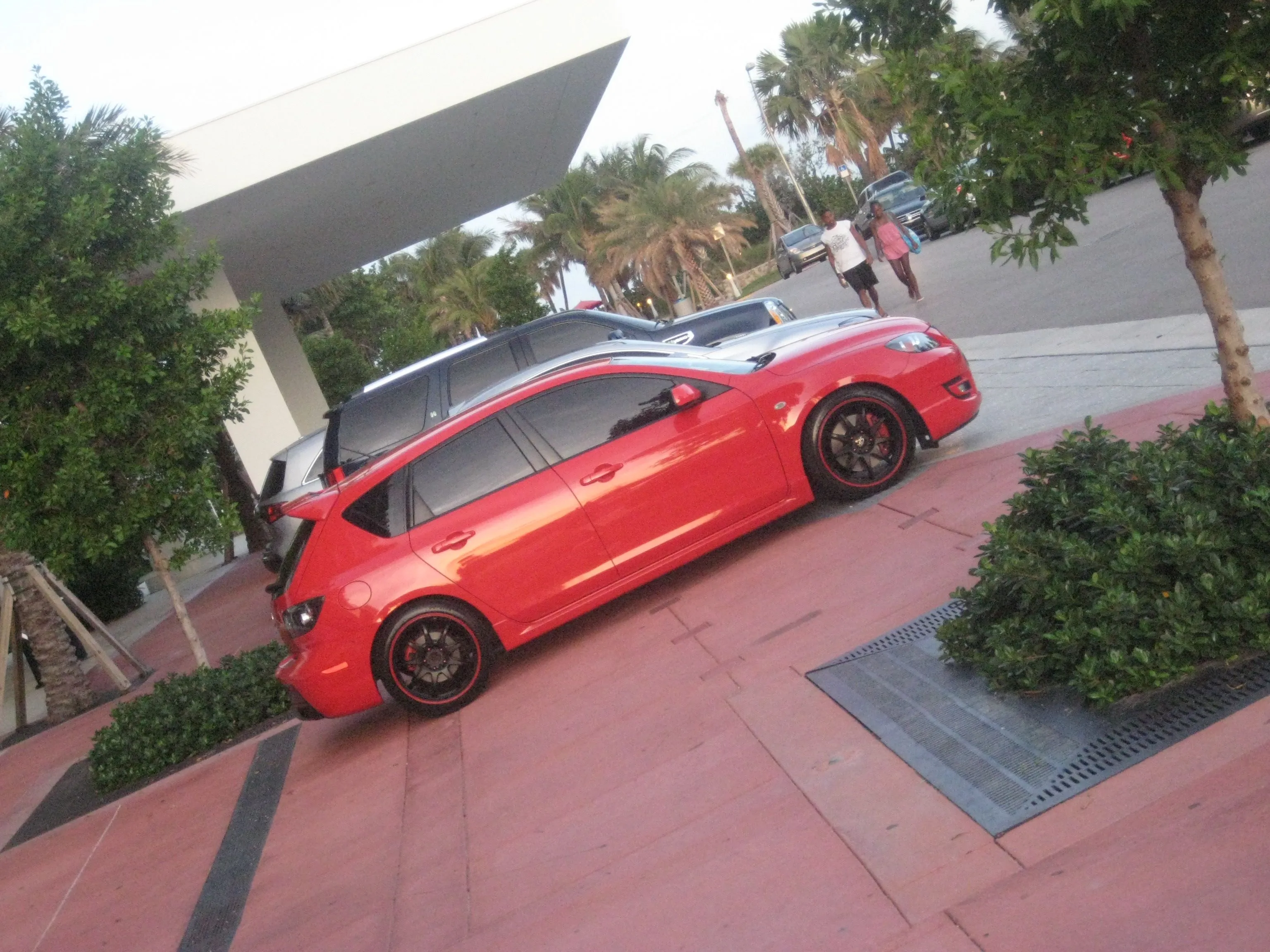

can anyone tell me what is the normal vacuum reading on the ms3 07 ?i have a dashhawk and the vacuum reads -20.18 thru -20.98. mind you im in florida the temp is 85f.from what i was reading people say they have readings at -28.00 or so.so im assuming i have a leak somewhere or can it be normal? here is a list of my engine mods:
corksport downpipe
corksport testpipe
HKS catback
HKS bov
garrett fmic
CPE tpi and intake
TRZ rm:stiff as hell makes my mirrors shake like if i had a sound system lol
ps:is required for me to change my plugs at this point??????
