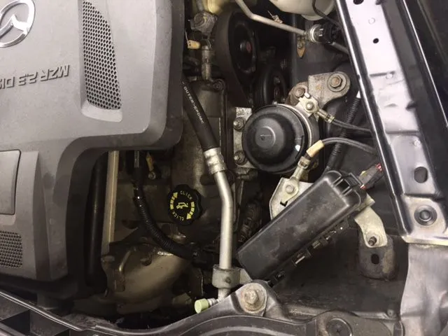

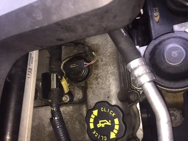

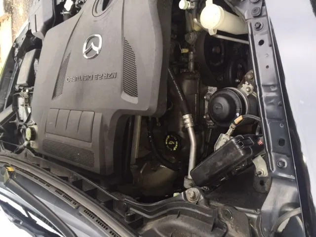

T tfirchow Member : Mazda, CX-7 Turbo Nov 1, 2015 #1 I'm having a slow oil leak around this engine part on my 2008 CX-7 Turbo, it's on the left side of the engine compartment. Looking for any help identifying the part, and if its easy to replace? Thanks! Attachments IMG_1677.webp 33.1 KB · Views: 809 IMG_1678.webp 36.8 KB · Views: 803 IMG_1679.webp 35.8 KB · Views: 798
W Woodrow Member : 2011 Mazda CX-7 Touring S 2.3l Turbo Nov 2, 2015 #2 That's your VVT control valve. You'll have to pull the valve cover to replace the seal around the electrical connector. Fairly straight forward job.
