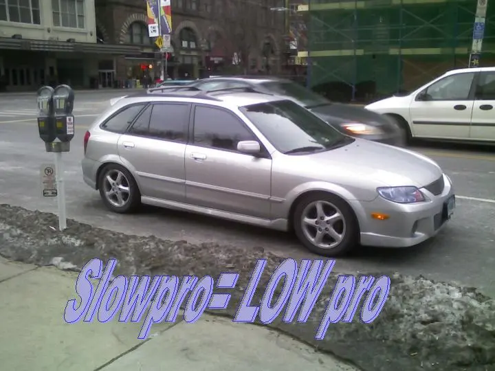

P5's look soooo much better when there's little to no wheel gap
