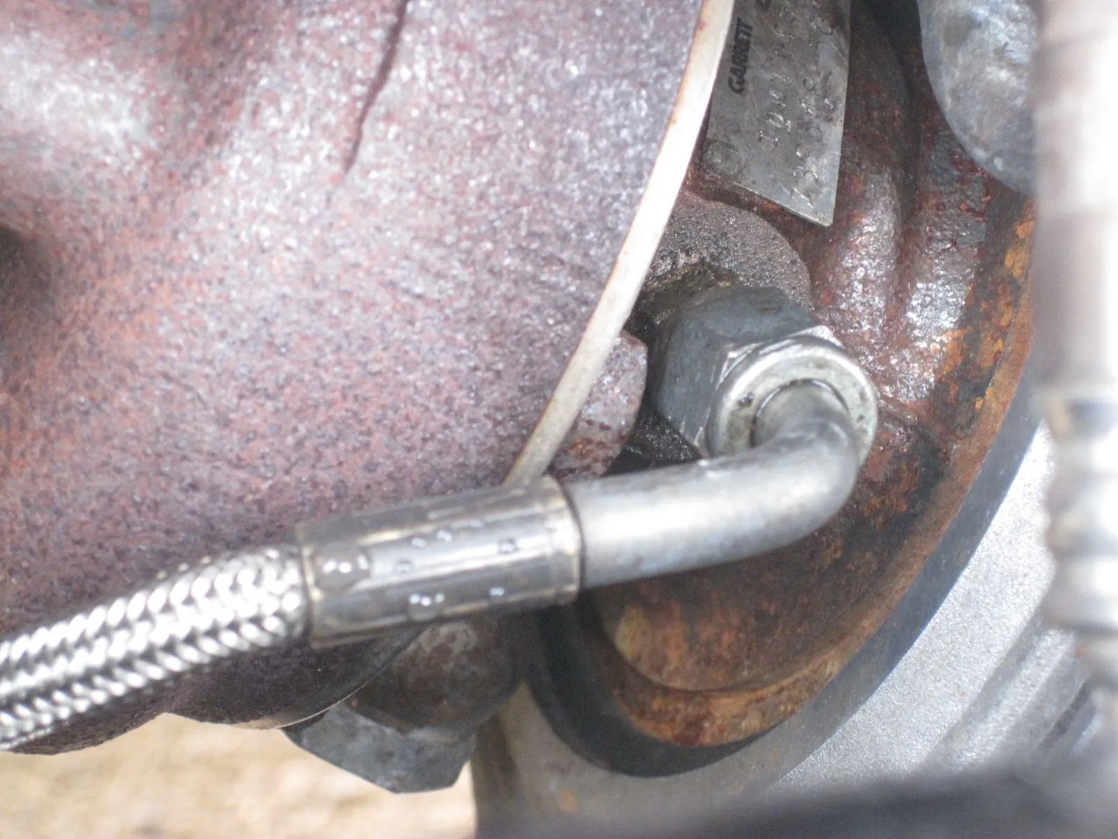

I'm looking to see where the oil feed line is sourced from for the turbo.
I'm having a hell of a time finding a proper oil Feed line that will bolt up to the Gt28RS and the stock oil feedline. The stock oil feed line has a Male end that goes into the female opening on the turbo. All the restrictors I've found are male on both ends. It also doesn't help that I can't figure out what the actual thread and size is on the oil line. I actually find almost what I was looking for on E-bay but as soon as I tried to get it on the cheap aluminum threads started stripping. I'm thinking the threads might have been wrong but who knows.

I'm thinking about just swapping the whole line out to something more universal!!! But can't seem to see where it connects in the back

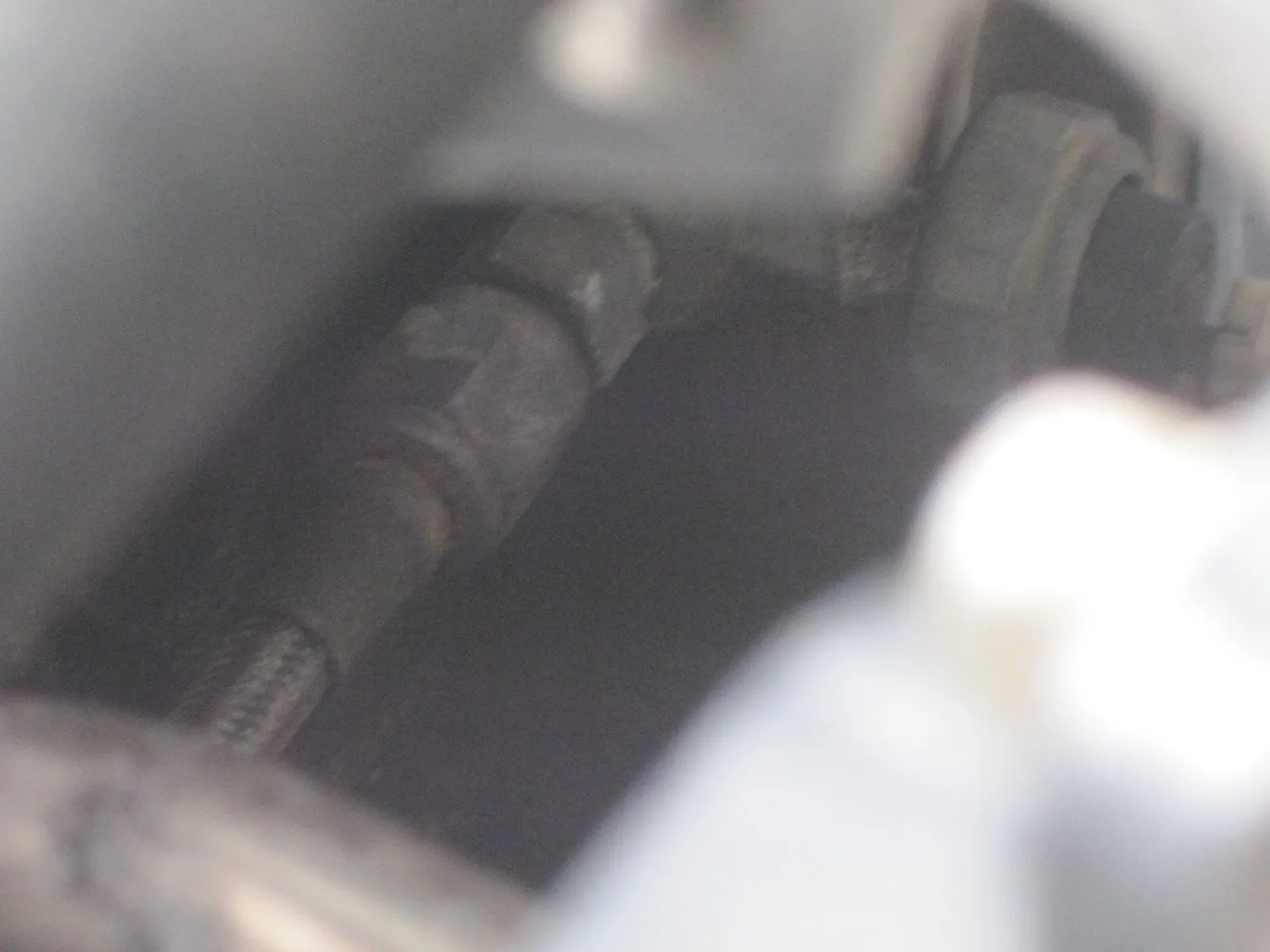

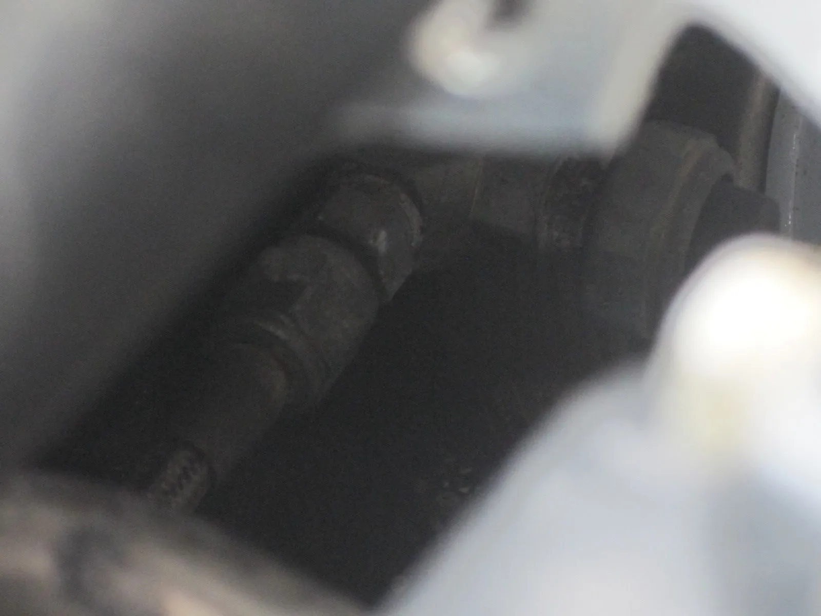

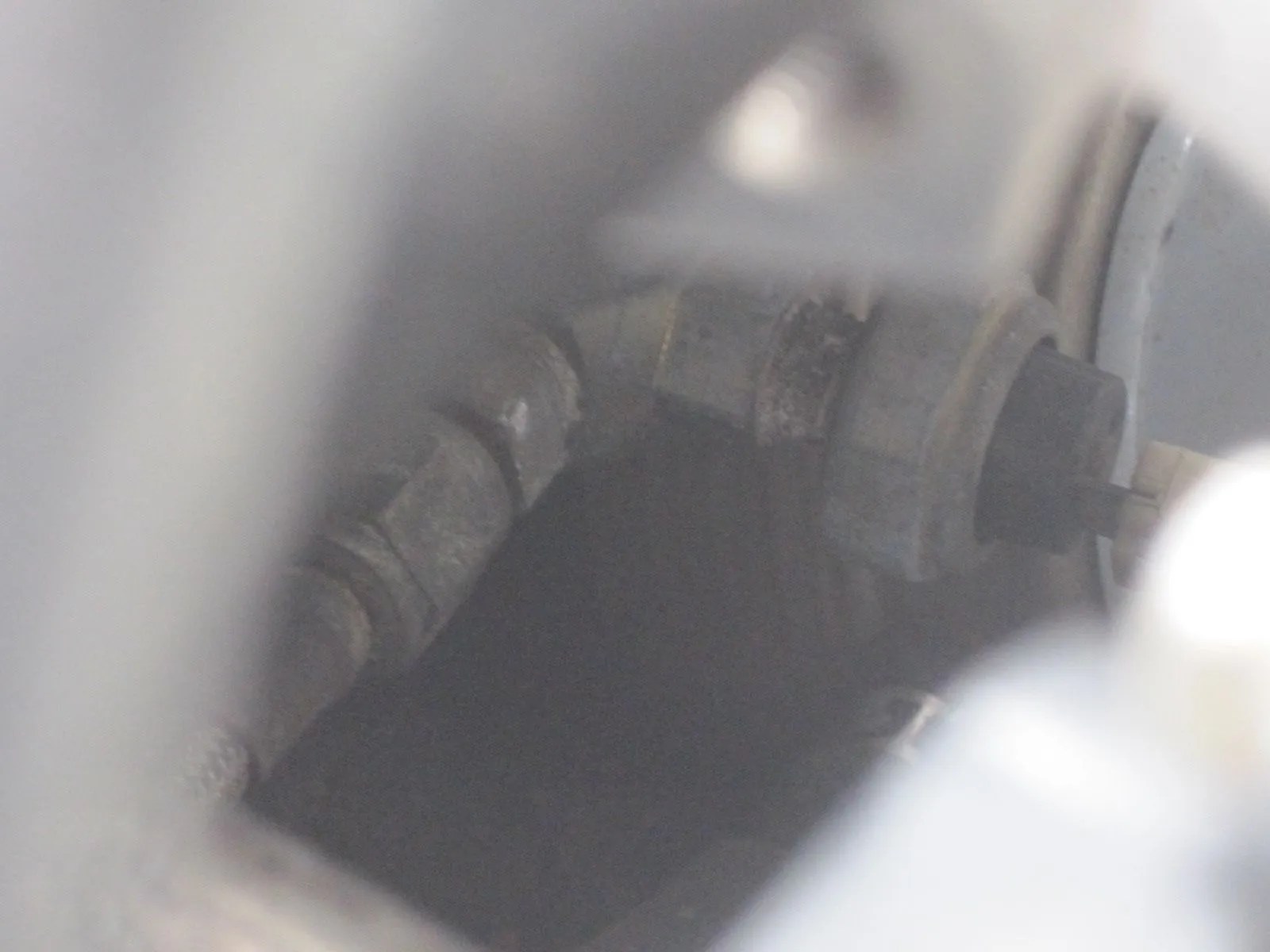

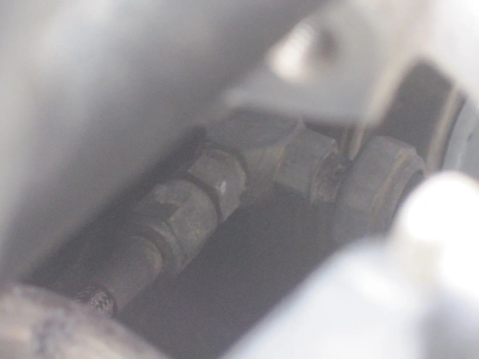

Here are some pics I just took.. the line is connected right under the intake mani to the block..

Thanks Jen!!
I wonder how that connects back there if it's the same way as the front??
Now if I could just find out what size and thread type I'm dealing with I'll be good to go.

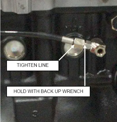

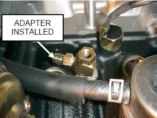

It T's off the stock oil pressure sender. It's a male end back there too.

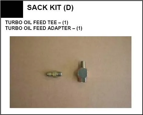

Pics are from the MSM Turbo install PDF.

Thanks for the info and pics.
Just because I have an MSP doesn't mean I've been up under the intake mani. I've touched almost evey other part the this damn car I just couldn't see where that damn line ended
Hey Jen,
Is you line the stock set-up?
I just came back from a speed shop and the guy ran this cool Snap-on Snake camera back there to follow the oil line and it looks like it connects with a Banjo fitting to the stock oil pressure sender. Yours looks like it goes directly into the block.
It looks like I'm going to have to replace the entire oil line just to install a damn oil restrictor going into the turbo.
I can't figure out why they don't make a 1/4 invertered flare maleside and 1/4 inverted flare female side restrictor.
The MSP can't be the only car using a male 1/4 inverter flare oil feed line???
