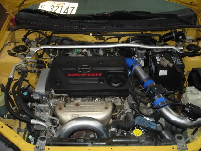

Theres a front mont intercooler with custom air intake and relocated MAF, you can see the sidemount intercooler is still in place but disconnected. Its also using a bov instead of the stock bpv. It also seems to be sitting lower than with the stock suspension. Its not necessarily bad but it exponentially increases the chances that the car was boosted over stock level at some point. Hard to tell what else was changed without additional pictures.

Looks to be well modified. You should be happy that it already had the FMIC, that's a huge benefit to the longevity of the engine and a lot of added power. Does it also have an aftermarket exhaust? How many miles does the engine have?
How many MSP have not seen increased boost? And for that matter there is not standard stock boost, as each MSP seemed to have had a different adjustment made to the WGA arm when at the port. Granted it's not a wide variance. Some people had as low as 4 and as high as 8 in stock trim.
If that original side motor mount is not broken, then that is pretty good indicator that the car was not driven spiritly once in a while. Its the black mount on the passenger side with the blue paint dot on it. You can run your finger around it a feel for rips.
Make sure it idles at 750 rpms and does not stall out when driving and pushing in the clutch. Vacuum should read around -20.
I don't see any boost controller solenoids in the engine bay. There is an aftermarket small air cleaner on the turbo. Oil residue on the front of the head, could be from loose cover bolts or a worn out gasket.
Overall it does look really clean, if it drives fine then get it. Really fun car to drive.
Also, not to scare you, but the FSDE is know to burn oil - more so with a turbo attached to it if driven hard. Check the oil level to make sure that it's at or around the full mark and is not too dark as that's a sign of of an unhealthy engine.
Looks like a nice car, one thing I would have the seller do is remove the heatshield on the turbo manifold and show you if there are any bolts missing, that is an extremely common occurrence. It has an HKS SSQV Black edition Blow off Valve (BOV), I have the same one and it sounds sweet.

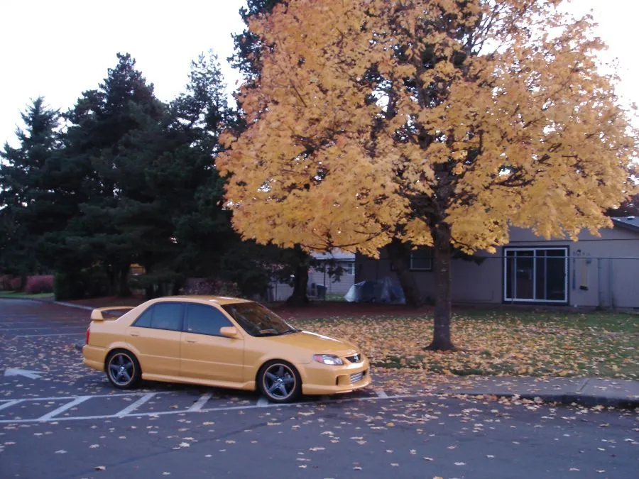

I also have the opportunity to purchase a silver MSP that has 20k less miles, but lacking some of the aftermarket mods. Also, the seller for the Yellow MSP seems so much more proud of his car, and happier with it than the seller for the silver one, which makes me trust the guy with the yellow one more.
