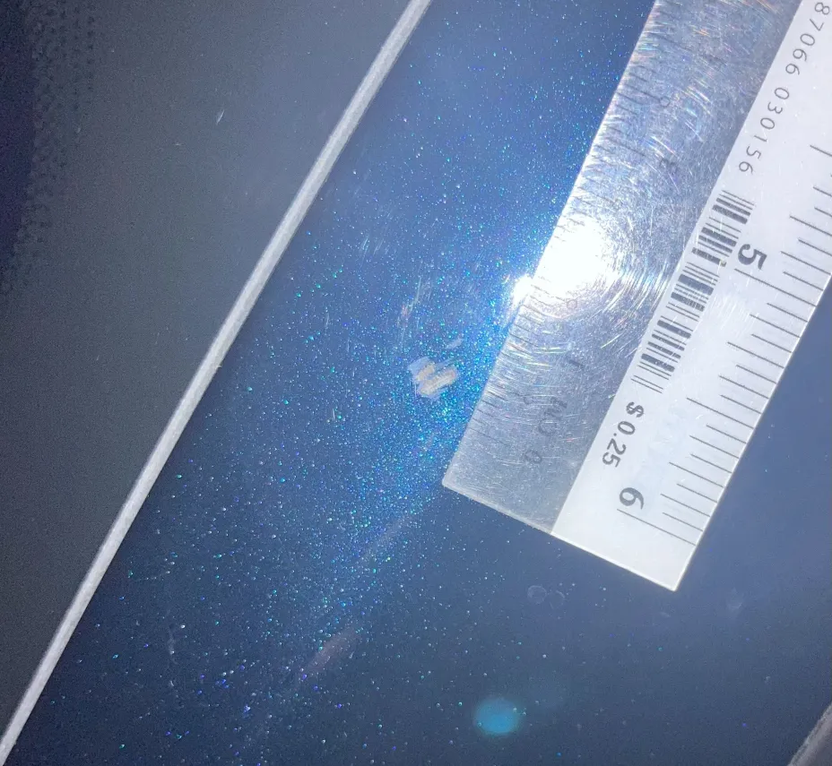

Picked up a rock chip today on a Deep Crystal Blue Mica vehicle today. If it's gray/white in there, is that damaged beyond the paint layer?

I hope Mazda mica blue paint pens are a closer match than the rhodium white paint pens are...but yes use a paint pen to fill it in as quick as possible.

If you can run a fingernail over the scratch, and it catches, it's likely too deep to be polished out. However, if you have the tools and products available, or if you want to try polishing it out by hand, you could give that a try. Just be sure to read up on the process and watch a few YouTube vids to learn before you attempt it. At the very least, you can minimize the look of the chip a little bit. Then, if you don't want to get it professionally repaired, use some clear nail polish and fill in the chip with a tooth pick (do not use the nail brush to "paint" it on). Touch up paint often makes the chip look worse because people tend to apply too much, and because the paint is often not a perfect match.

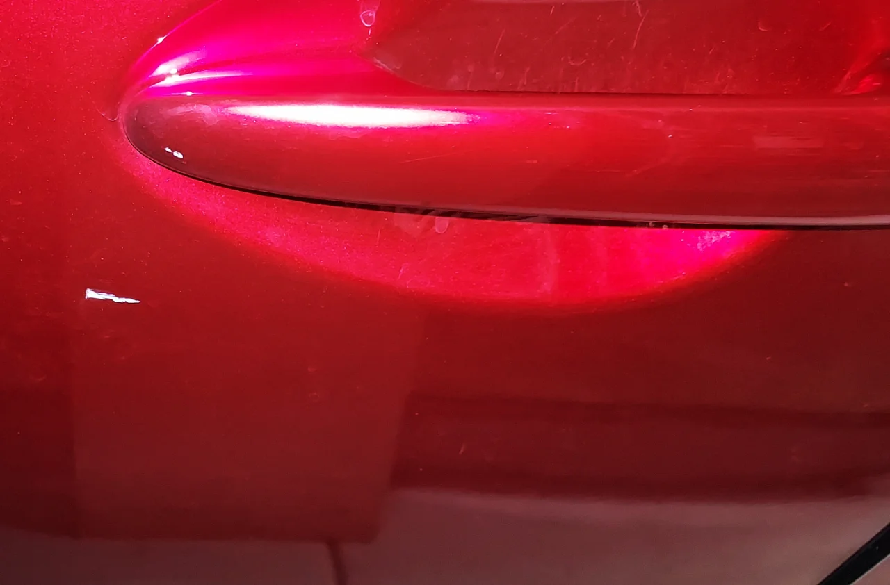

Here is a pic of the damage, near the drivers door handle. Click to open the pic, the chip/scratch is on the left side.

I would just do a light coat of touchup paint. really the only one who will ever notice is you. I no longer even notice mine.

I had read all the horror stories about Soul Red Crystal Metallic prior to my wife's insisting on having that color on her CX-5. I ordered 2-step touch up paint set from my favorite internet supplier and, sure as s***, found it absolutely impossible to get a decent match. Didn't take me long to give up on using the base coat. Now I just use as little of the color coat as it takes to camouflage the scratch and call it a day (like jadmt says above). It usually ends up looking OK in some light and horrible in others. It's just the nature of the finish!
