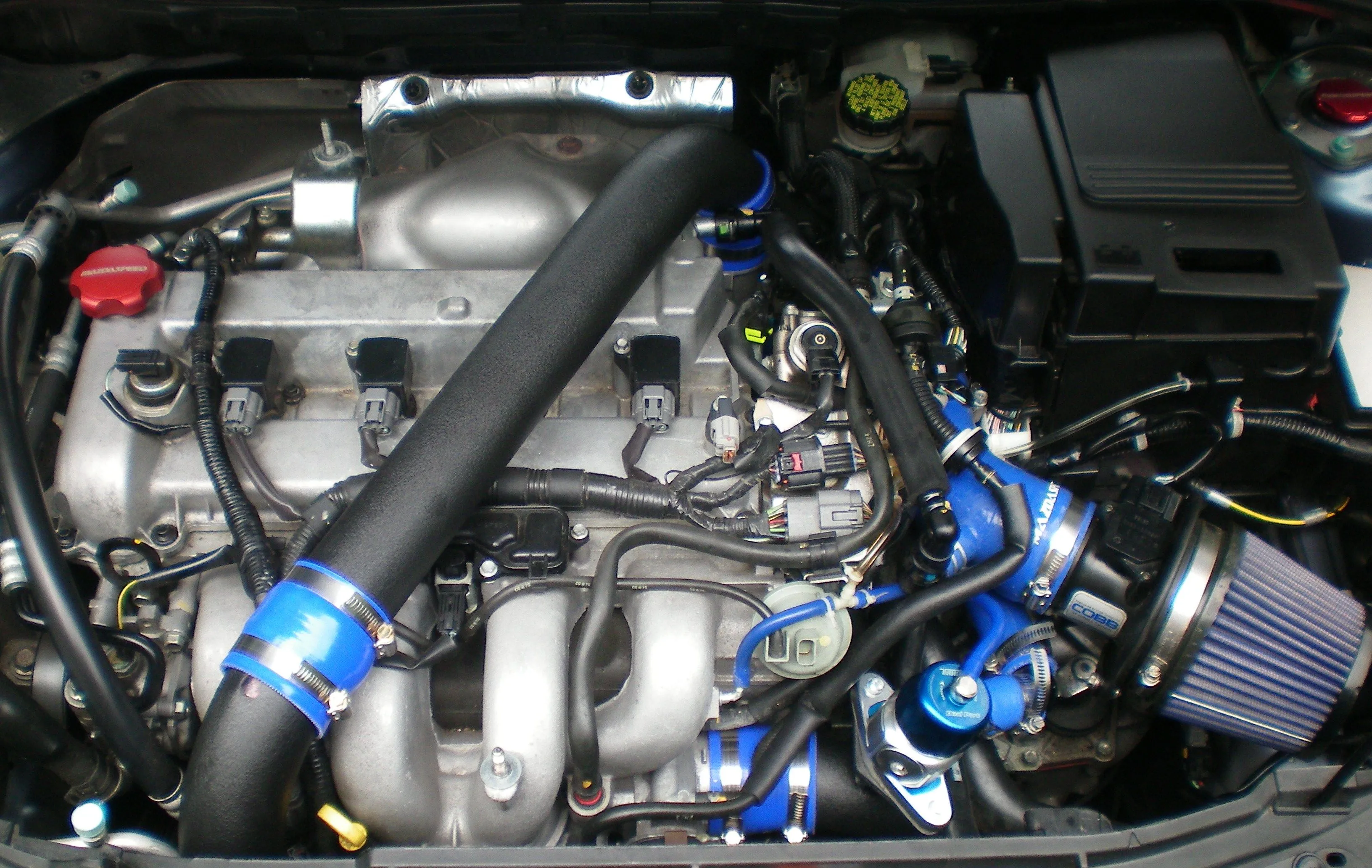

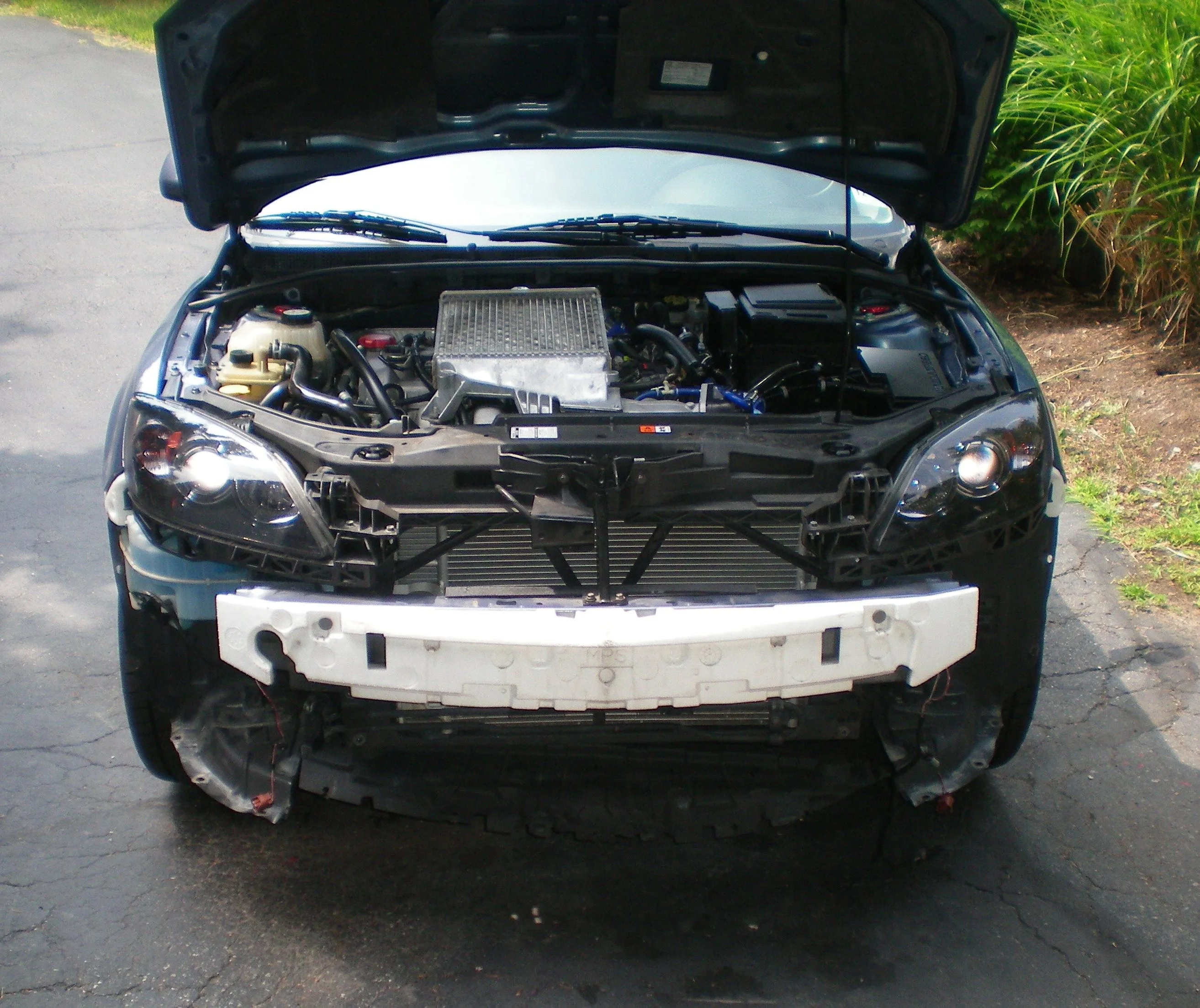

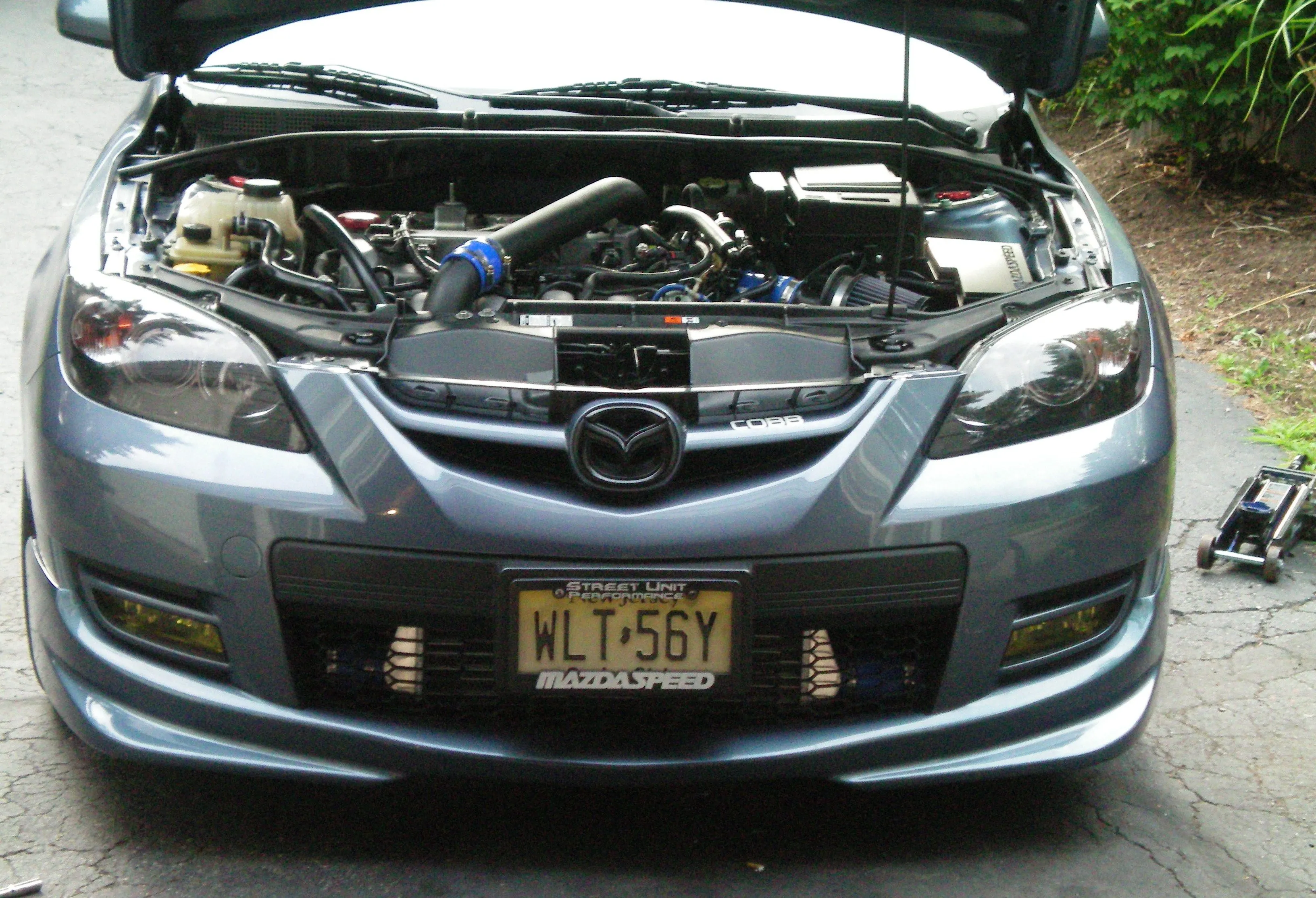

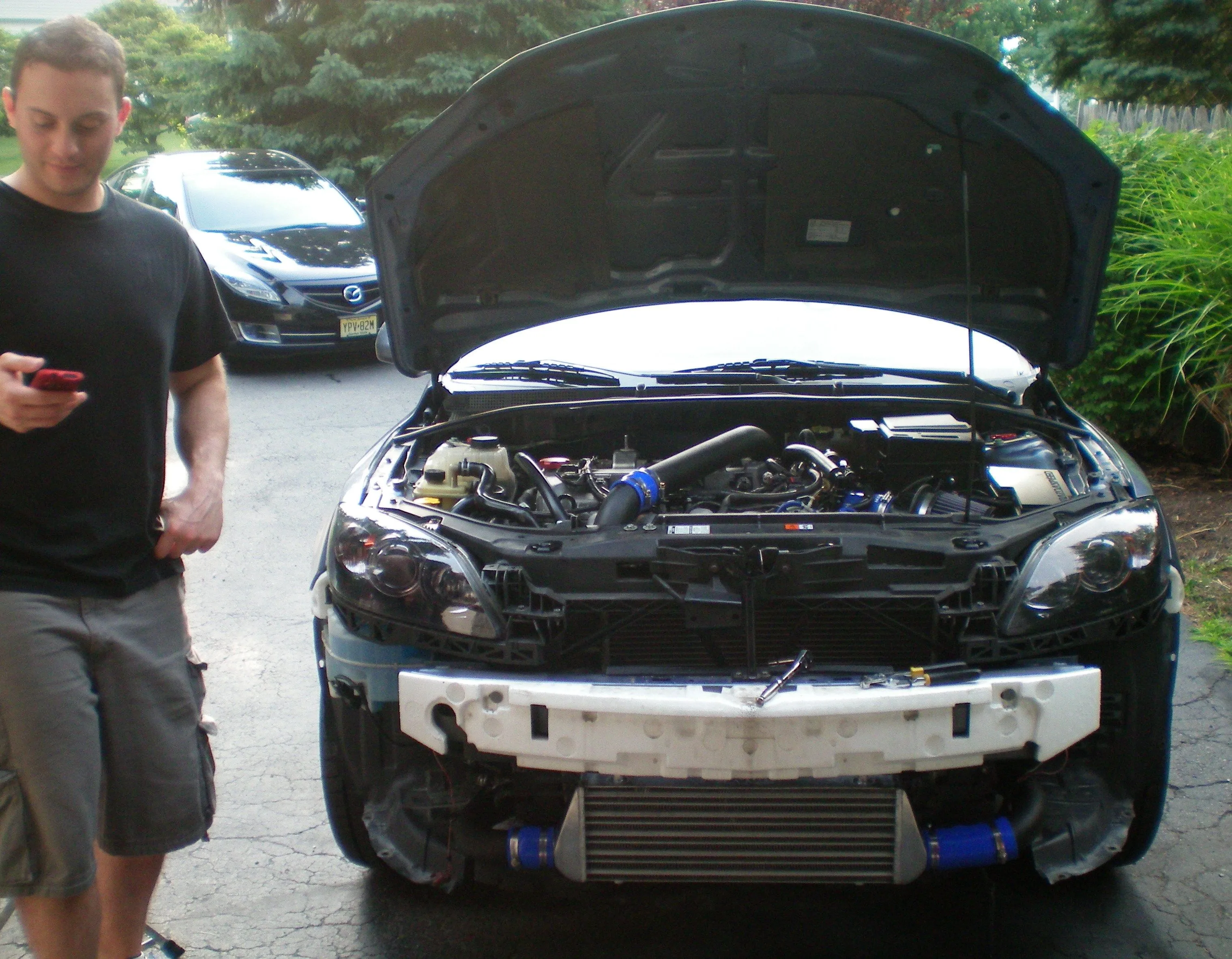

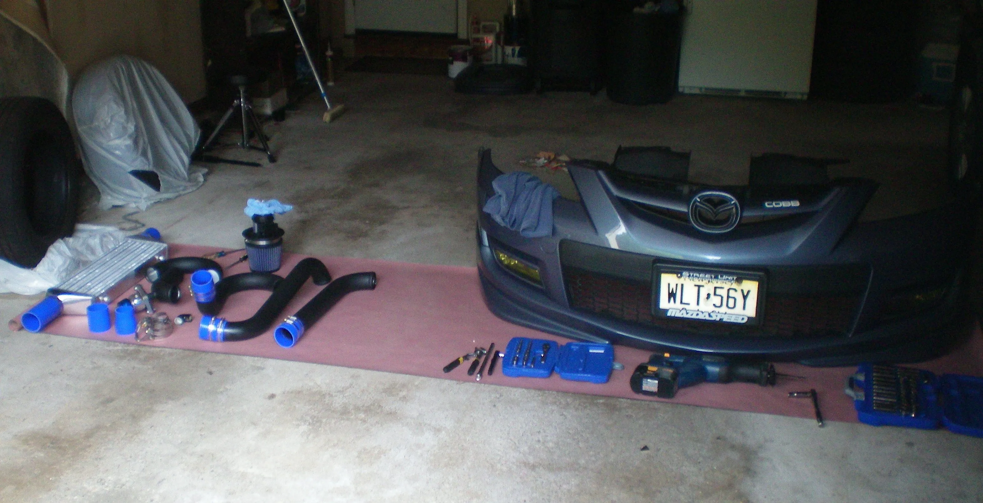

So my PG FMIC is installed and I gotta say I'm pretty happy with it. Ken did a pretty good job on the powdercoating. Only 1 imperfection which probably happened during shipping. I removed the air ducting and front bumper the night before which took about 1/2 hour. Removal of the stock stuff and installing the kit took probably about 3 hours. Half of that was trying to figure out how the hell to make my bracket work. Just a heads up, Ken provided an assortment of nuts/bolts/plates to make the bracket line up with their new cores, but I couldn't make it work that way. The core is barely bolted onto the bracket which I bent the crap out of to make it fit. It is very solid and doesn't move at all. Here are some pics of the whole process
Pic #1 - Bumper off, stock TMIC still on
Pic #2 - Everything that needs to be put on
Pic #3 - Kit installed (buddy of mine who helped)

Pic #5 - Ready to go

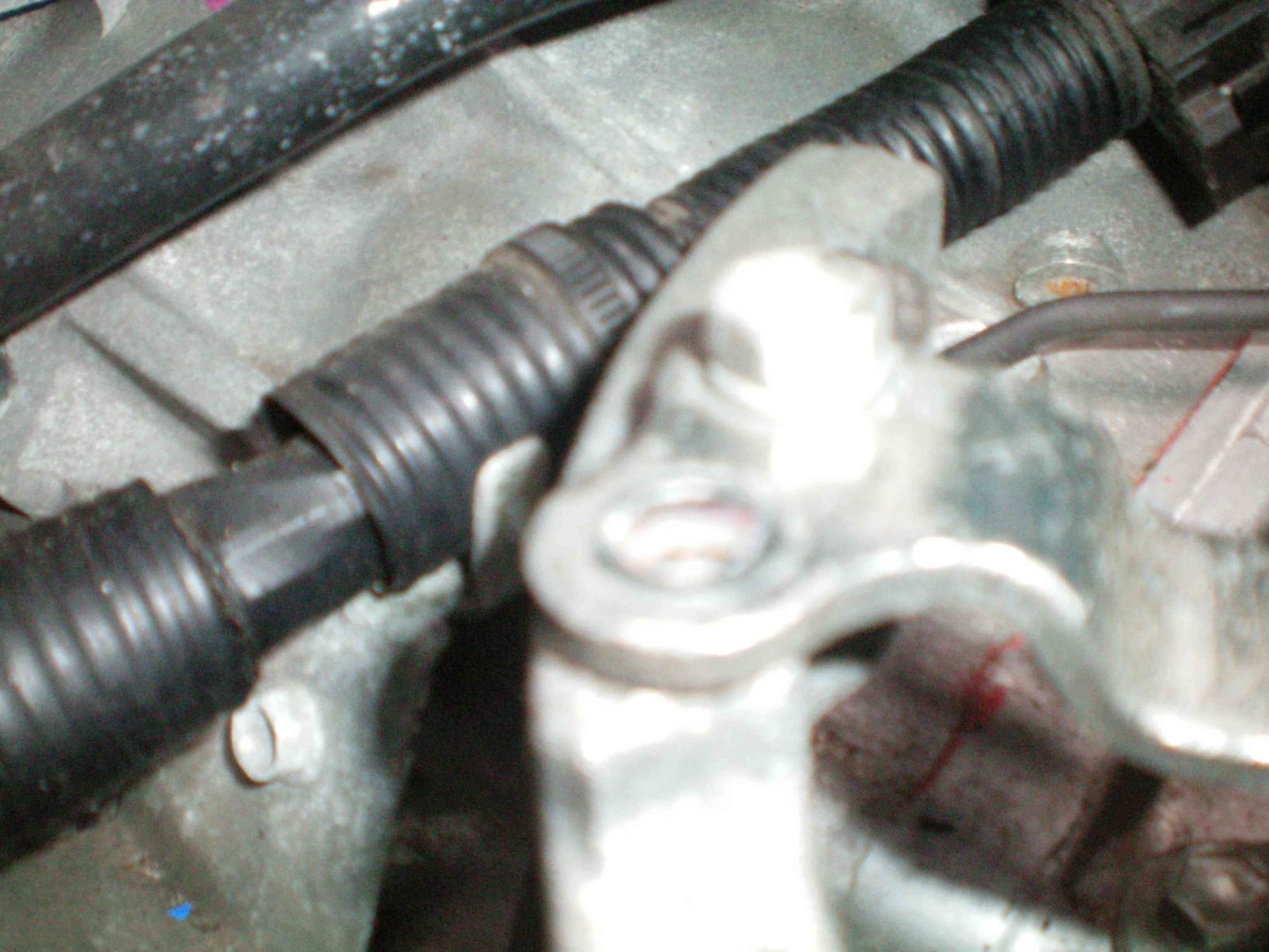

Performance wise, I gotta say the car runs alot smoother throughout the whole spectrum. I drove all the way down to my hometown to see my dad and it ran great, didn't really get on it too much, but moderate acceleration. On the way home, getting on 295 on-ramp I decided to floor it in 3rd gear and immediately heard a "pop" and the engine started bogging. I figured it was just one of the pipes coming off. Popped the hood and everything looked okay "HOLY CRAP I BLEW MY ENGINE".....no, I didn't, but thats what I thought, it was one of the couplers right under the bumper. Luckily I was able to fix it while on the side of the highway without any tools. Drove it like a baby on the way home and took care of it properly. Still have not gone WOT since just cause I'm cautious. I'm posting this last pic because the only other snag I ran into was after the kit was installed with the bumper back on. While trying to put it into reverse I could barely get it into gear. Found out it was the shifter weight rubbing on one of the pipes. After stressing out about it for an hour trying to move the pipes, all I had to do was shift it back one notch and it's fine. Thanks again to Ken for hooking me up although I still want that protegegarage sticker to put on the top pipe!!! Best kit on the market in my opinion.

A lot of us have done that before! Me included. You have to be extra cautious when tightening down that U-pipe on the passenger side. Make sure the pipe is in the coupler correctly and the clamps are evenly distributed on the pipe. By the way how the hell did you fix it on the side of the road without tools? That's impressive.
As far as the shifter weight, a lot of FMIC kits require the weight upgrade (like the one PG currently sells). Not only does the shifter feel better with them but it gives you a lot more clearance when you have an FMIC installed.
