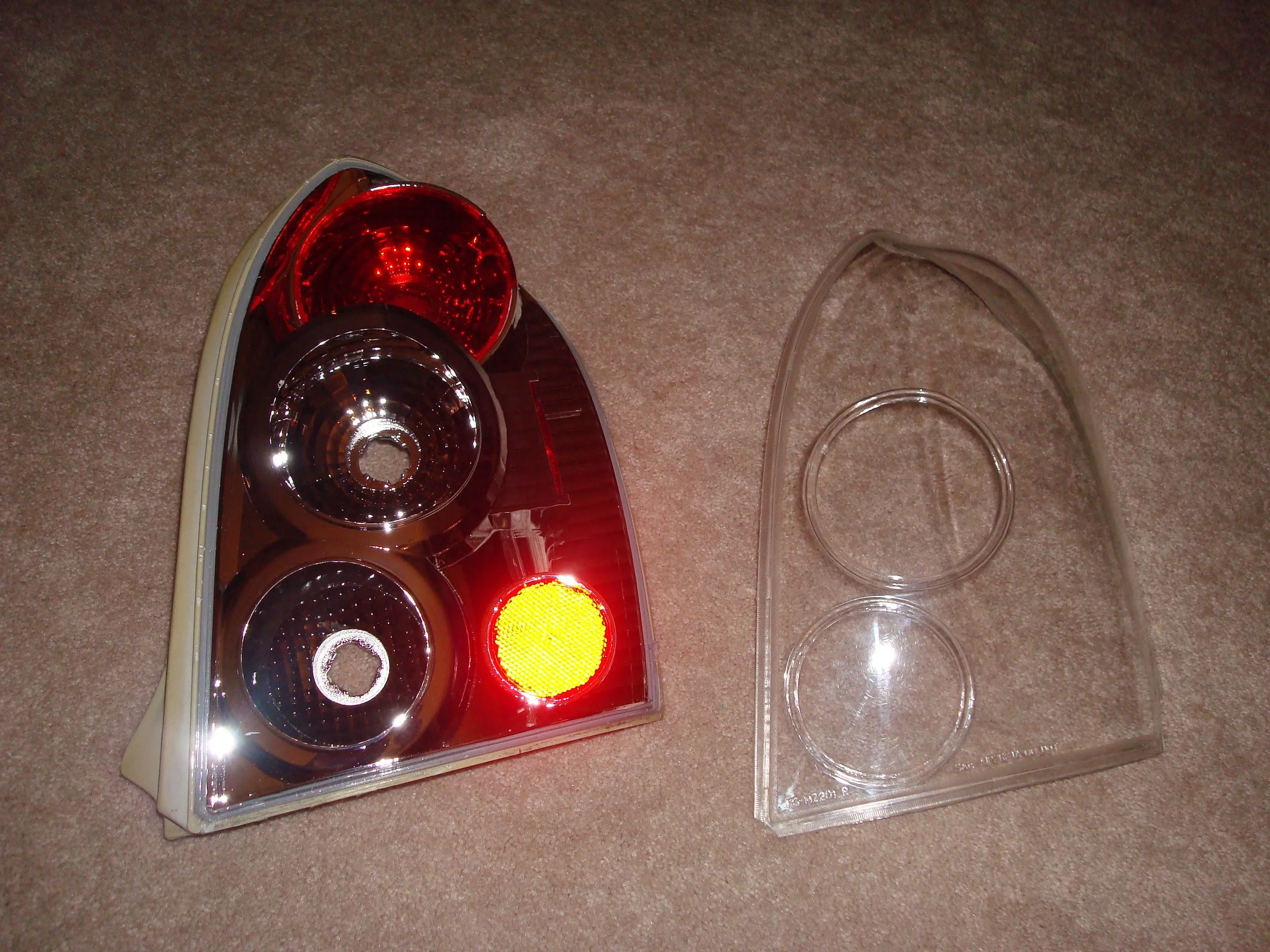

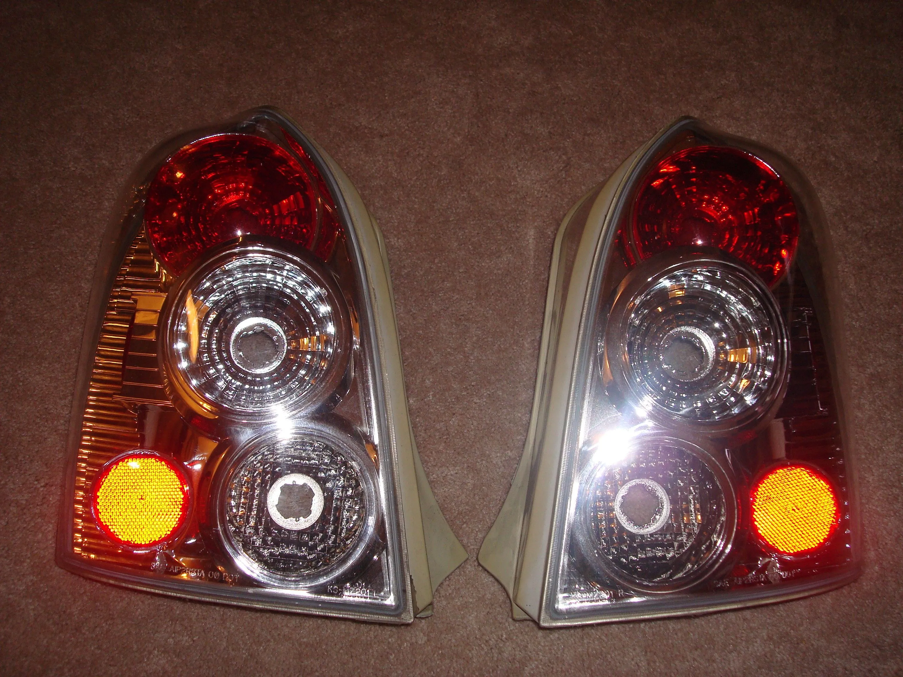

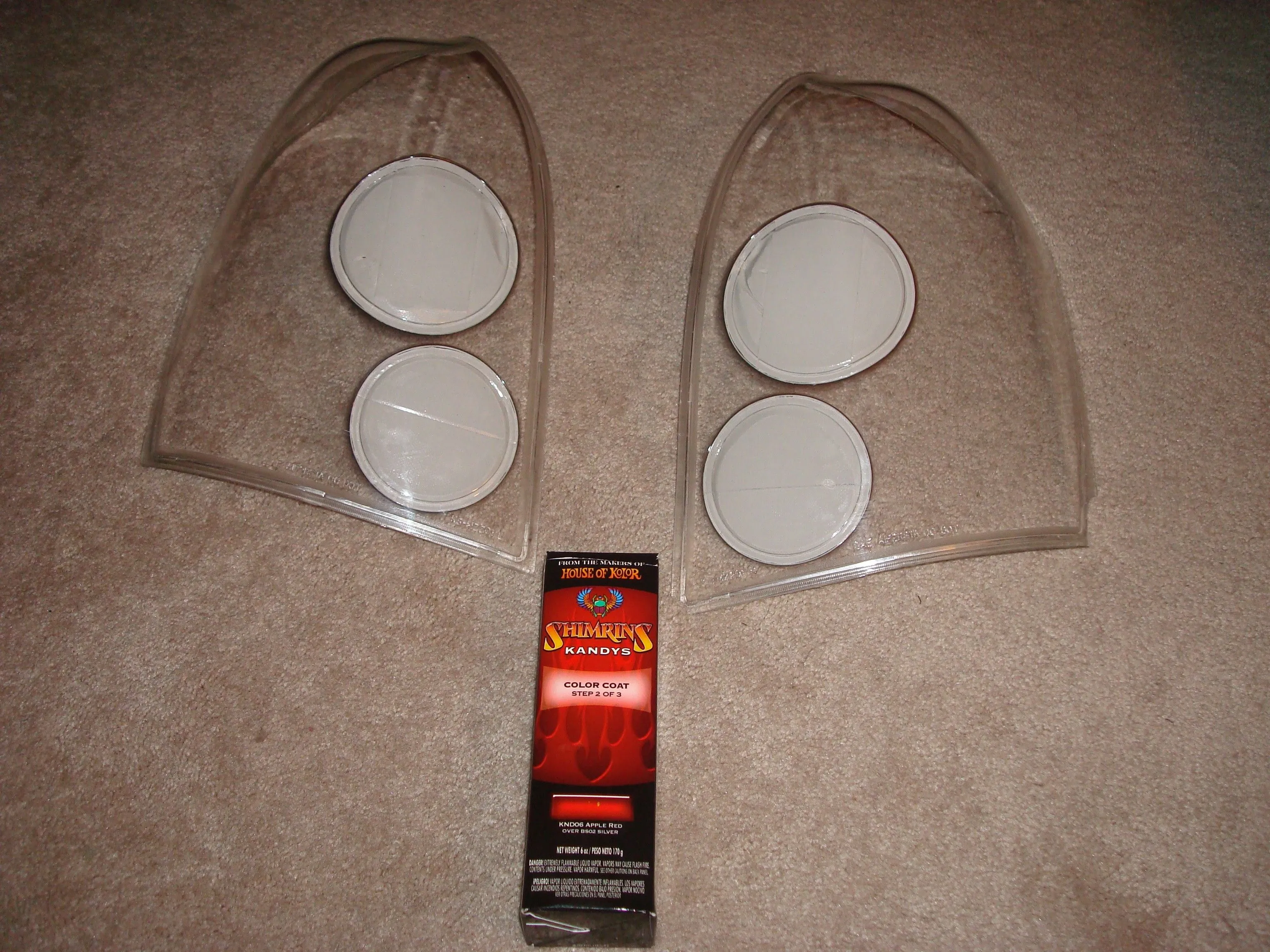

Some of you may know that I have the ugly chrome Altezza taillights. They were on the car when I bought it and have been trying to get rid of them for a while.
Last week when I was washing my car I noticed the Altezzas were the same layout as the factory taillights. So I got the bright idea to paint them.

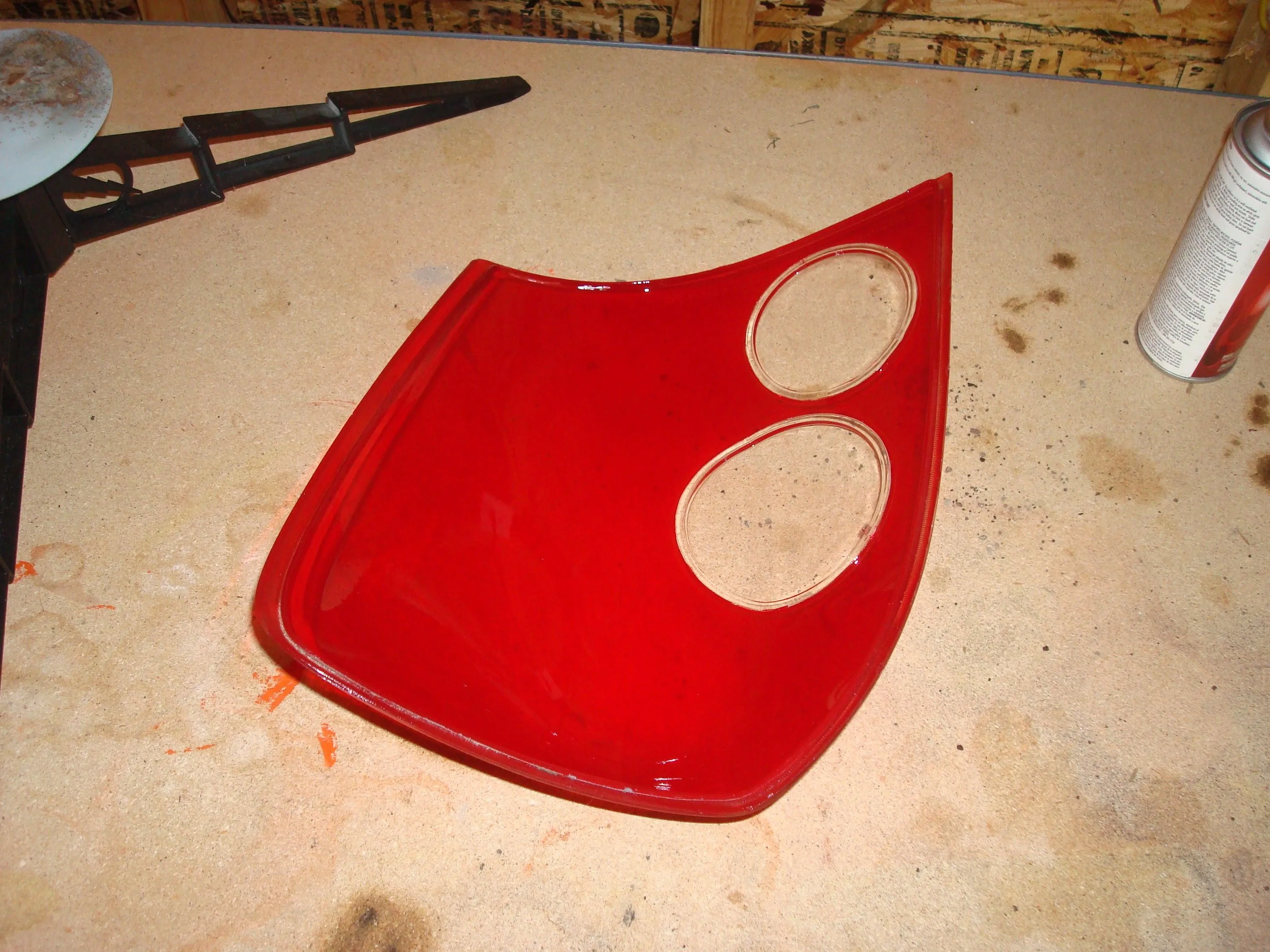

After A LOT of searching, I found some candy apple red in a rattle can.
So, after a few drinks I decided now would be a good time to throw my taillights in the oven. 8 minutes at 300 degrees and the lenses pulled right off.
I just taped off the 2 rounds spots on the taillight for the turn signal and reverse light. Then I hit it with the candy red. While I was at it, I painted the housings black.
Let me know what you think.

Carquest.
Its a little pricey ($10 for 6 oz.), but definitely worth it. If I ever did it again, I would get 2 cans.

haha. Because all I had was the altezzas. I didnt buy them, didnt want them, but it was all I had and couldnt justify spending $100 on factory ones. So for $10 in spraypaint, I can have the factory lights. Plus I think they look a little better because the covers are smooth instead of having the texture on the back.
Testors has a color for painting tail lights on models. It is a perfect gloss red. I forgot what it was called but is definately cheaper at $2-3 for a small can (more than enough for two lights).
transparent candy apple red.. love the stuff!

Yeah, I broke a corner off on the first attempt. Then I put it in the oven at 300 for 8 mins. They popped right out.
I did put it toward the top of the oven with only the lower heating element on, so that may have had something to do with it.

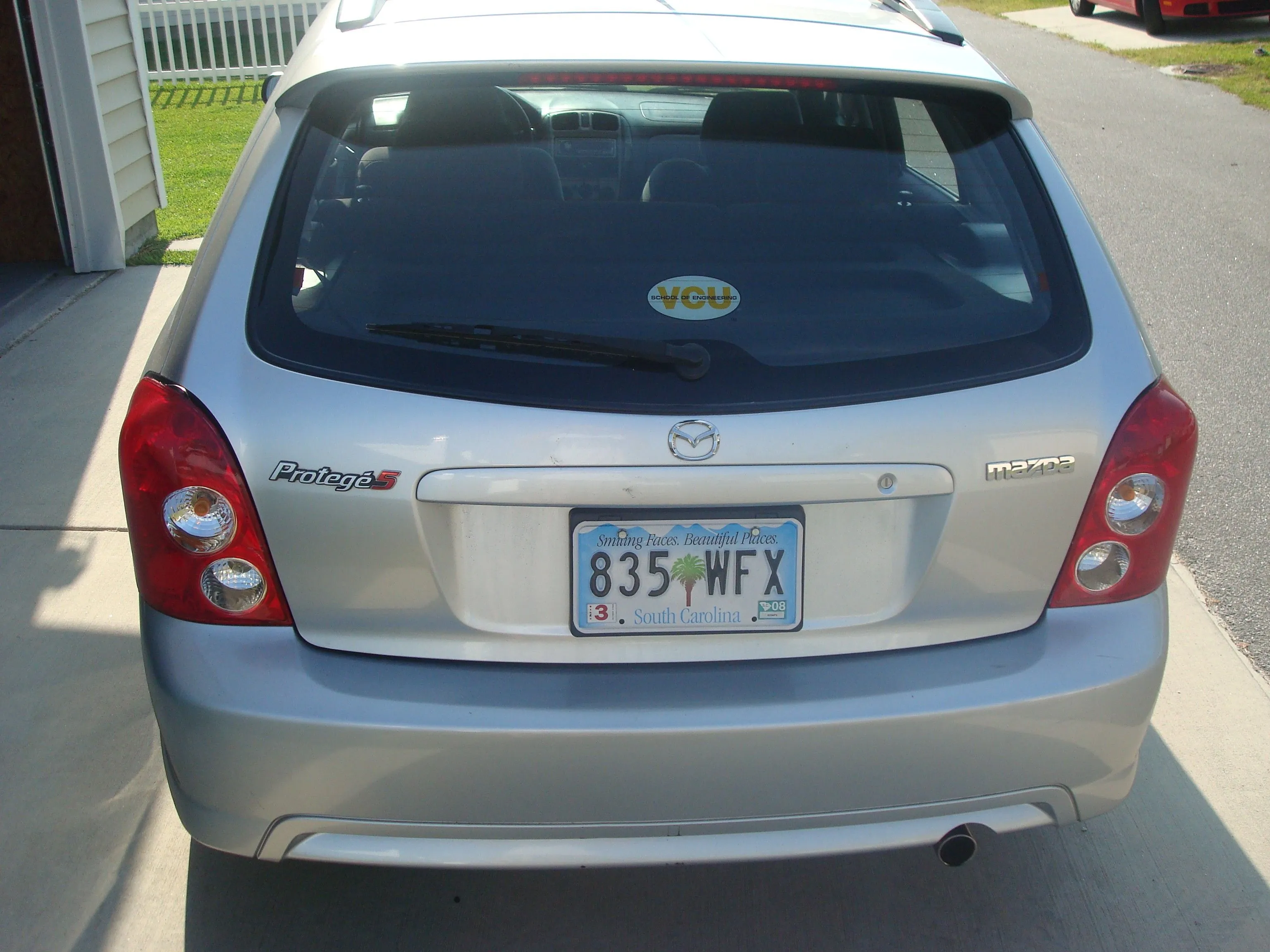

You need to show us some daytime installed pics.
I would have liked to see the Paint applied a bit smoother from what I can see..but I want to see Daytime pics ...Indoor lighting doesn't show true to their environment and helps accentuate the flaws.

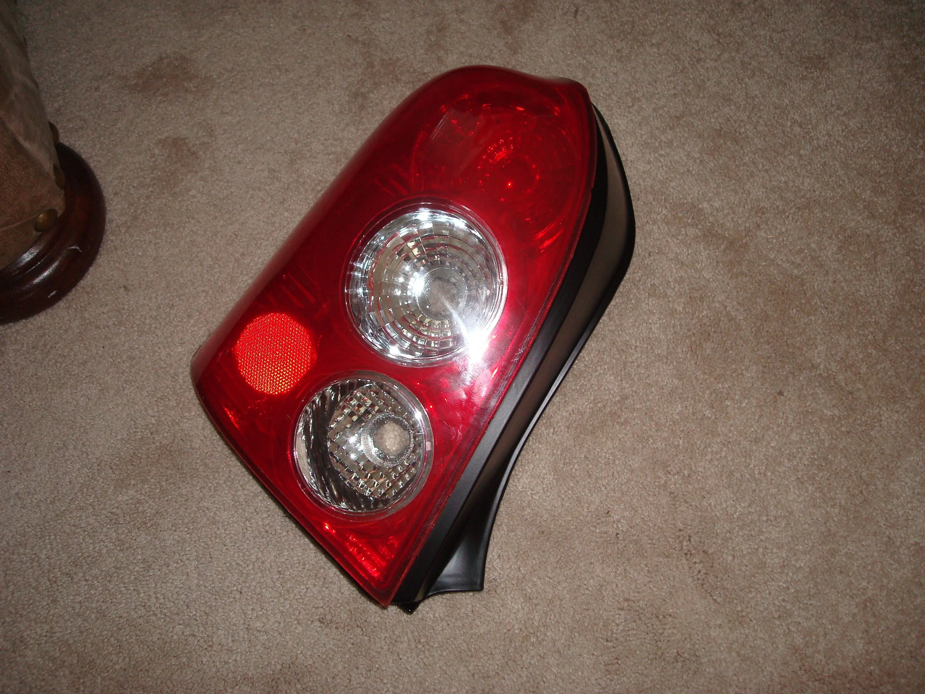

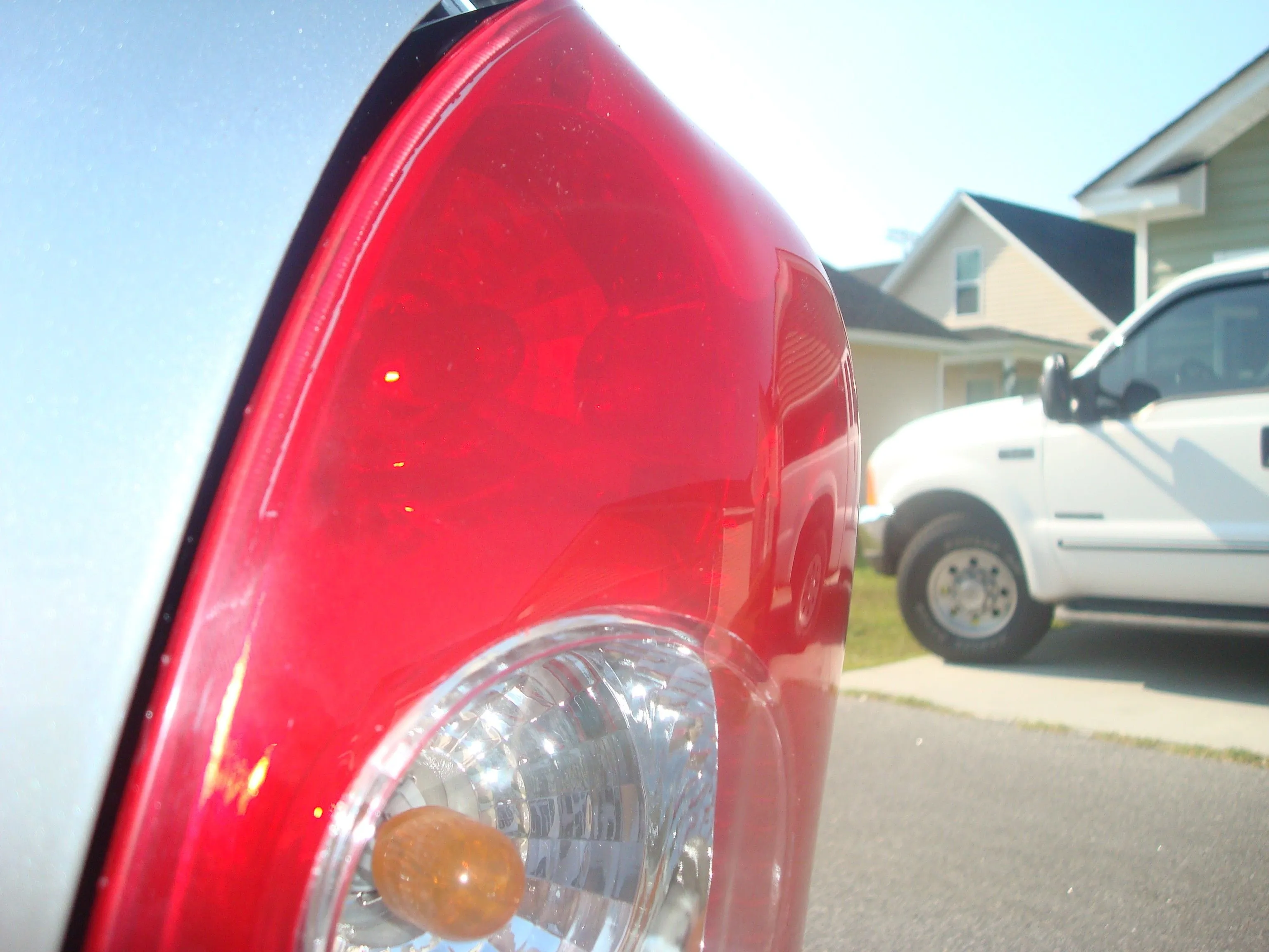

Yeah, I think the photo I took earlier was right after I painted it. If your candy was anything like mine, it took a while to dry clear. It was cloudy in some areas, which made me think it was uneven, so I painted more. Eventually I left it alone long enough to see that it just takes a while to dry correctly.
You can see an installed close-up on the second pic. It really turned out nice. The sealant is still drying in these pics, so you may notice that around the edges.

I like the artist signature fingerprint beside the blinker cutout in the last pic of the 1st set of pics. Chrome altezzas match the oem headlights, black altezzas are for sale everywhere & match blacked out headlights, only thing about the JDMs is they look like usdm sedan tails-not necessarily bad( just an observation) & yes the usdm oems look stupid at night to me. I much prefer the fit of the JDMs to altezzas & how they match the body lines. These painted altezzas look better than the usdm oems IMO. Let's see pics installed & lit up with parking lights & then with brakes.
^I'll take some tonight.
And I will check that finger print... I am 90% sure its on the outside.
