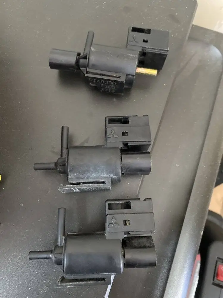

these are the 3 that I took out. im sure about the green and white ones, but is this brown one thats closest to the camera part of the intake manifold?

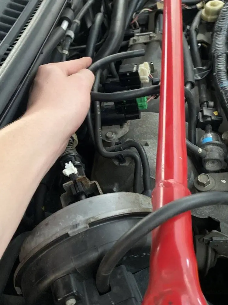

I also have this random tube here that Im not sure if I accidentally pulled it out and it goes on that little metal piece or if it was never put into anything in the first place
I couldn't tell you for that third one. I've never bothered with it and quite frankly didn't even remember that it was there. Unless someone else pops in with other advise, I'd say go ahead and clear your CEL codes and see if this fixes the problem.
As a general rule, you're not really supposed to have random open ended tubes that aren't connected to anything. Same with wires, or plugs, or loose bolts or nuts. So yes, that tube should probably go onto the nipple sticking up off the intake. My brother just bought a Protege that has a check engine light on for that hose being cracked, and it makes a hissing vacuum leak sound when it's loose/open.
yea I assumed its supposes to go somewhwre I just dont know if it was before I started messing with stuff. It doesnt go on the “nipple” on the intake very tightly. It seems like it would definately slide off.
Hmm. Just guessing here...maybe if there is enough slack in the line, you could cut a little bit of the stretched end off and try to slide the newly cut tube onto the nipple? Worst case scenario is that you just replace that piece of tubing, if you can see where it connects to on the other side.

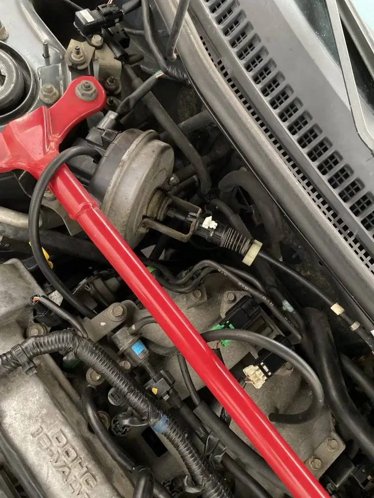

Im trying to find a clear picture of the engine bay to follow that tube, but its hard to find I guess
From what i see on pictures the way this tube is managed, it goes over the red engine stabilizer, but it doesnt do that in any of the pictures. Seems like someone may have replaced it
I'll take a look at how it runs on mine when I'm home tonight, if you don't get it figured out by then.

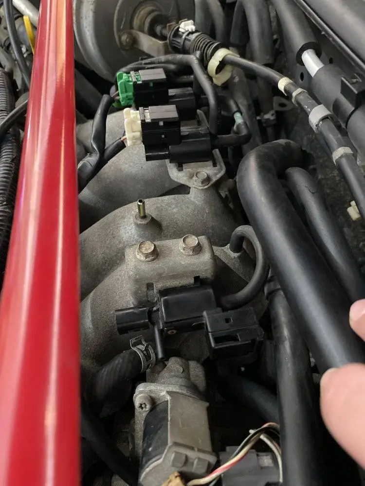

hahaha yea I guess so. this could be a dumb question but would a rubber band or zip tie around the tube on the bottem of the broze nipple thing be a bad idea?
this is how the tube looks right now.
