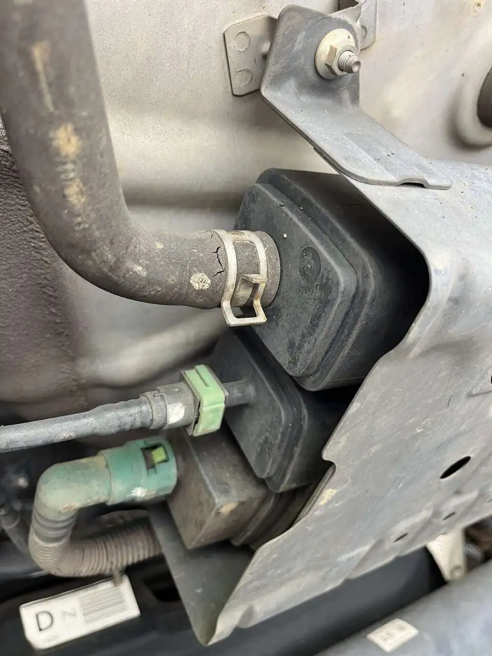

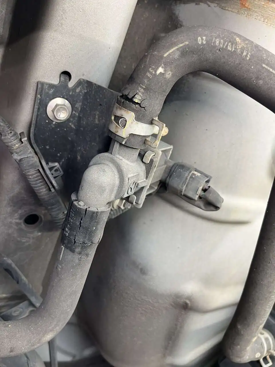

Well, I feel kind of dumb...the cannister vent valve is pretty obvious, its near the left rear wheel. And my evap leak is pretty obvious, as several hose ends are cracked, and probably leaking. For a temporary fix, I cut the ends off and re-installed. This only needs to work for a week until the new hose arrives.
Pictures for someone else having the same problem
