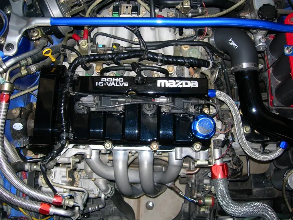

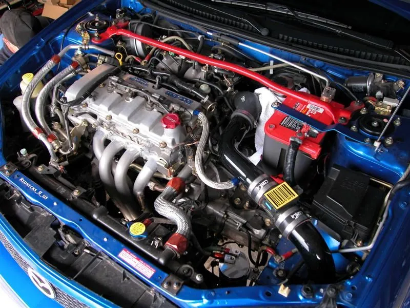

This was one of my most noticible gains in terms of the butt dyno. I could really feel the difference.
