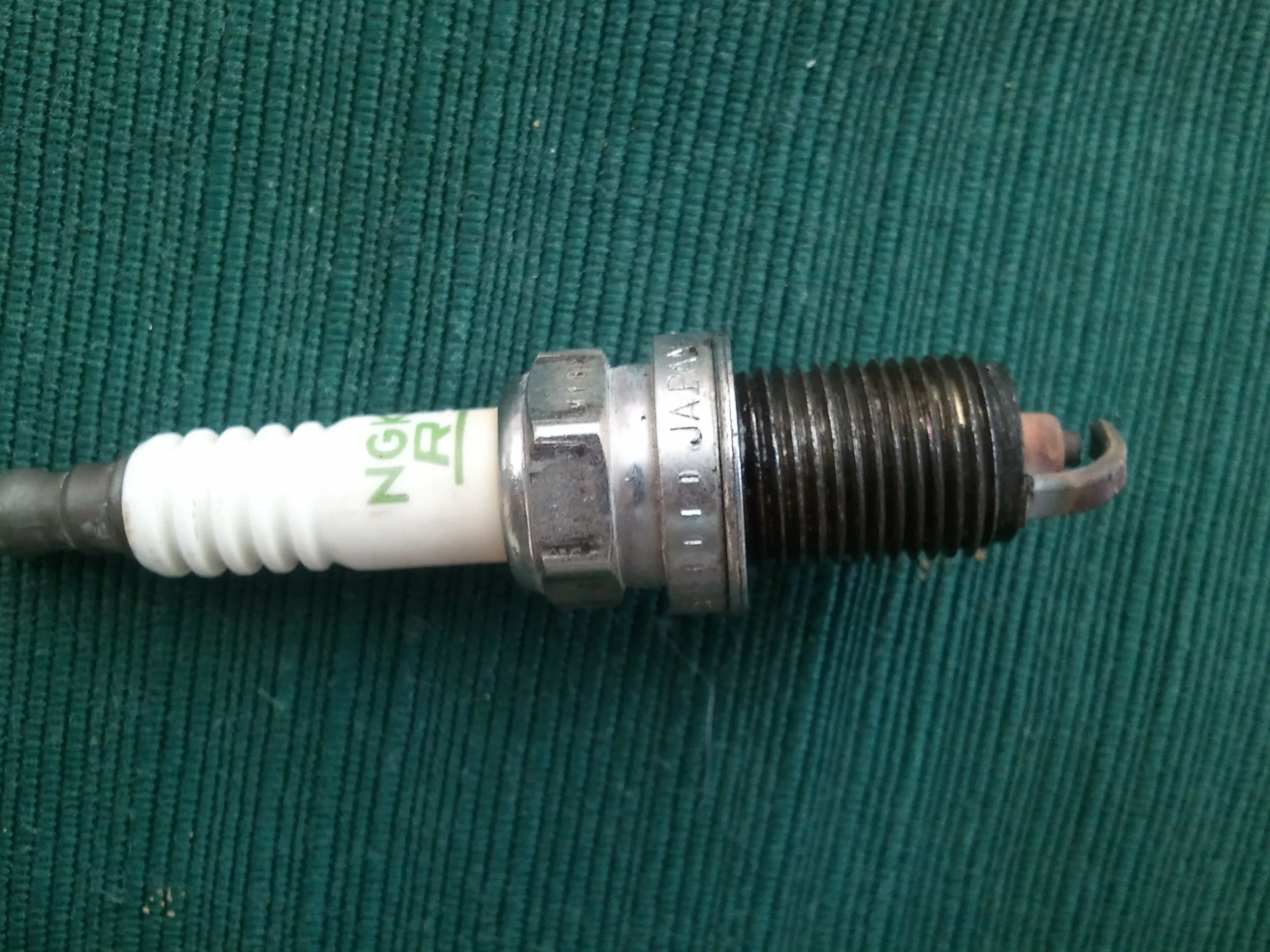

I've been having some misfiring going on with my MSP to the point of where the CEL flashes at me. I went and scanned it at a local parts store with 'random misfire' appearing. I ran it to the Mazda dealer today to see if they could be any more specific, and I just happened to notice something funny on the way there, which may be the cause of the misfiring...?
I have a narrowband AFR gauge (yes, I know, it'll get replaced soon (cheers2)), but while in boost, it holds steady. It usually hovers around 11.5 while in boost, but I noticed today that as the RPMs rise, the AFR slides to 19.0 - this is around half throttle. I didn't go WOT, but I mentioned this to the tech and he confirmed it with his laptop and going for a drive. They said what appears to be happening is the computer is seeing an over-boost and slowly pulling away fuel. My boost gauge peaks at 8.5psi (so does theirs), so, if this is really the case, why does my car pull fuel at 8.5psi while most others say they don't have that issue until 10psi-ish?
So far the car has forged rods/pistons with a 20overbore, new crank, oil pump, cams, valve seals, and a bunch of other misc. things along with a 2.5in turbo back exhaust with high-flow cat. I don't want to do anymore 'fun' work to the vehicle though until I get this sorted out. According to them, at idle, all the fuel trims/pressures are exactly where they're supposed to be - this is the only thing they can come up with. He said getting a piggyback (in the works) would alleviate the problem, but I want to make sure that the 'overboost' scenario is really what's causing the problems.
Does anyone have any other suggestions as to what may be happening? If you want some more info. from me, let me know. Thanks!
