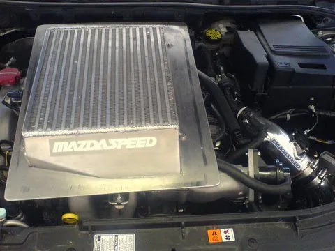

I think that is the old bigger one, heres mine.
Notice that they used hardware instead of tack welds. I filled the gap with clear silicone which seams to work great and is hardly visible when clean.

ETS stopped welding the plate on a while back. The current units all have brackets welded to the core and the plate bolts on. It is much easier to mount/dismount the core with the plate removed. I added captive nuts to the brackets to make it really easy. I had to trim the back of the plate to keep it from hitting the firewall, in spite of the fact that I have a stiff rear engine mount. I also worked at filling the gaps between the core and the plate with some high-temp rubber strips.

the ETS TMIC does not trap heat like the factory POS. we've done several back to back 1/4 mile runs and dyno runs and found the ETS cool to the touch. we use the stock one to cook burgers between runs.
ok i kid, but its definetely noticable
ETS stopped welding the plates because people complained about the welds looking poor, ease of install, and fitment issues going to the CX7.
