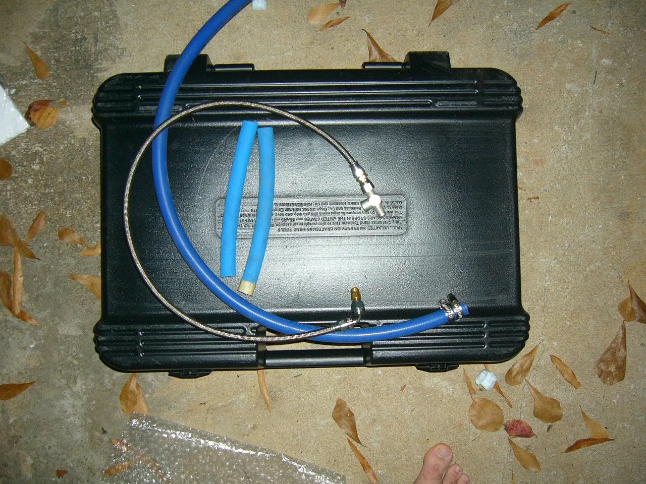

I am not really sure what you are looking for but I used the long blue hose in the picture below for mine. I couldn't even tell you what it is. You can pm mryellermp5 and ask him. He included it with the turbo kit that I bought from him. The hose has held up fine.
hmm that looks like a silicone coolant line. I'm using a heater hose for my return at the moment! Hope it holds up lol
