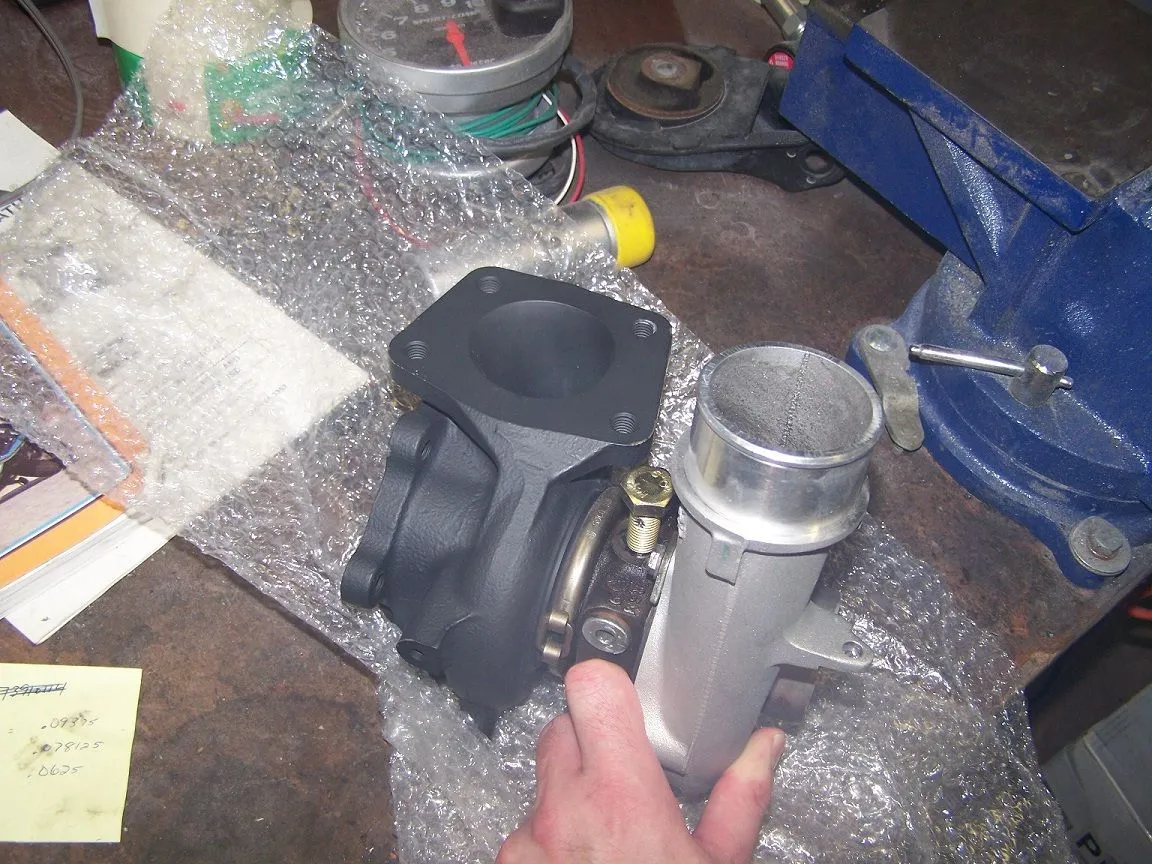

This progress on the part of Mazda is very promising, but long over due. Those of us who went to catch cans with two PCV valves, before and after the can have noticed improvement and sometimes elimination of the "smoke." PCV valves were never intended to work in the environment of high boost pressure and high compression ratios at the same time. The blow by the piston rings and the resultant crank case pressure build up is much greater than NA engines. I'll be really interested in seeing what kind of alternate crankcase ventillation system Mazda develops.
I would not be surprised to see that part of the Mazda fix might be a simple change in the oil passageway specs in an oil restrictor bolt that regulates oil pressure of the oil supply to the journal bearings.
It's just a matter of unscrewing one bolt accessable from the engine bay to the top side of the turbo once the intercooler is removed and replacing that banjo bolt with a new one with different size oil passageway. One poster (bnoon) on another board has made this discovery and it seems to work well in reducing pressure on the turbo seals and reducing the so called "smoke." The restrictor bolt and its location are shown on the attached photo (credit to bnoon for pix). Exact details of the change in passageway specs are beyond the scope of this thread.
I've not done this mod yet. If Mazda releases a re-designed oil restrictor bolt, we'll know this is a major part of the solution.

Yes - exhaust mods. Exhaust mods that increase flow and reduce heat at the turbo exhaust outlet -- DP/RP and going catless -- can contribute to the "smoke" issue, simply because those hot cats are not there to burn off the remaining crankcase crap that got injected back into the intake through the PCV valve. If it all does not burn, it goes out the exhaust. Smaller, more restrictive DP holds heat up high in the DP longer to burn off some and the cats produce heat all to burn off as much more of the stuff as possible. Oil catch cans keep some of that more liquid and solid crap from getting sucked back into the intake.
Some say that the reduced backpressure in the free flowing exhausts changes the ability of the turbo seals to work properly. Maybe. Not so sure about that, but that's what the banjo bolt mod is about mentioned above and it seems too produce improvement.
And we run pig rich, which makes the exhaust "sooty" to begin with. The only intake mod I know of that might contribute to the problem would be running an aftermarket BOV in vent to atmosphere mode, as that would worsen the fuel richness, contributing to additional unburned hydrocarbons leaving the combustion chamber through the exhaust valves and eventually out of the exhaust side of the turbo.
