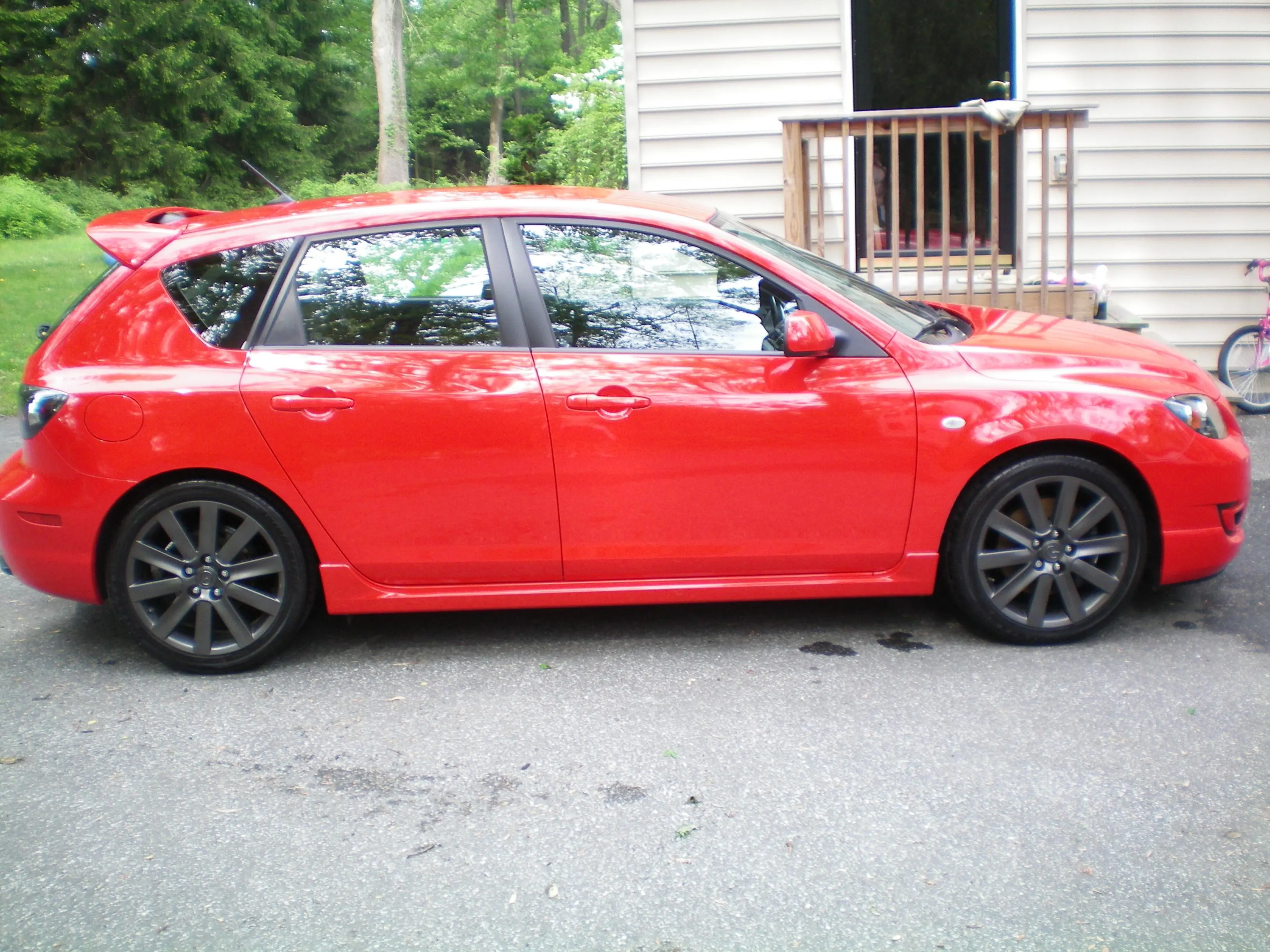

OEM 18's painted Duplicolor Graphite
Just wanted to show these to anyone thinking of this color. Hadn't seen these before on this site. Have seen plenty of black though. I like them alot and for about 4 hrs. total work and about $20.00 in materials, the results can't be beat.

Very interesting and looks great. Does the paint hold up well? That is my main concern, I may actually give this a go.
I used it on the rolla, it is pretty tough stuff, you'll get chips over time, but you can spot em with the same paint applied with a qtip
and if you want a dif color, you can still use the wheelpaint clear on top
Nice
I painted mine gun metal a few months back. I love the look! I also blacked out the side markers... Makes it tighten up really nice with the window tint.
I think they look great, but I also think you'll be redoing them before too long. Nice work though and nice price.
