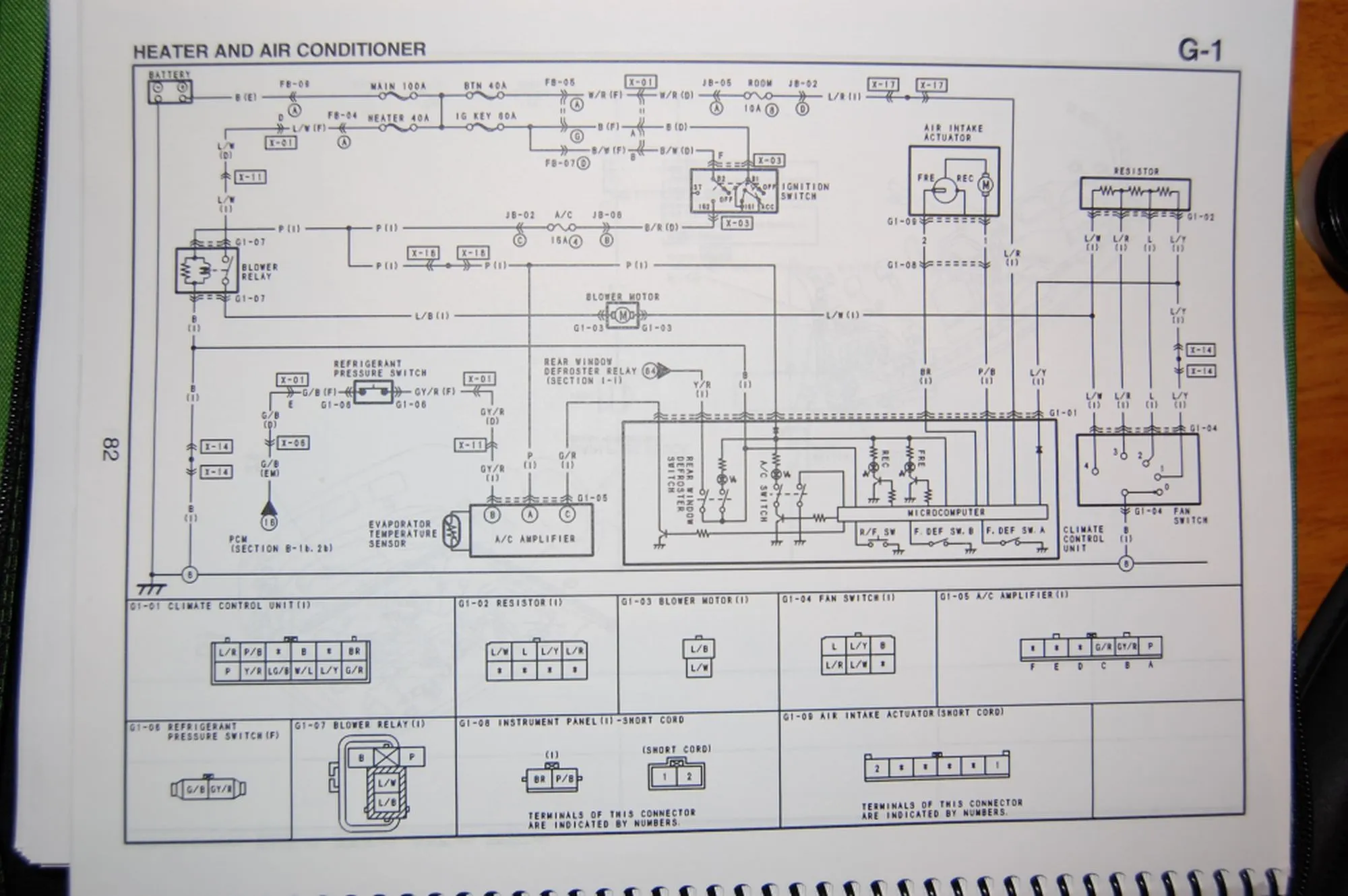

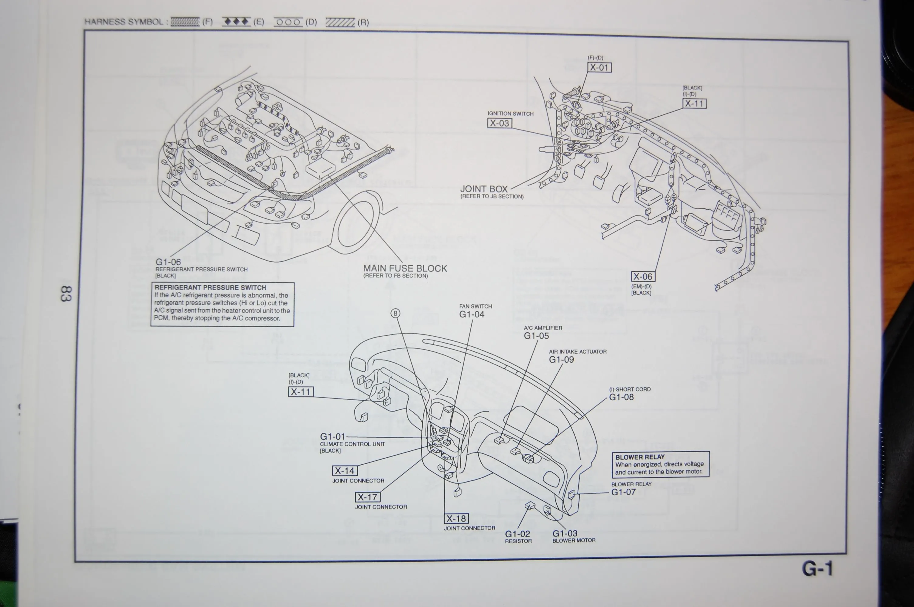

Does anybody have a wiring diagram for the A/C system?

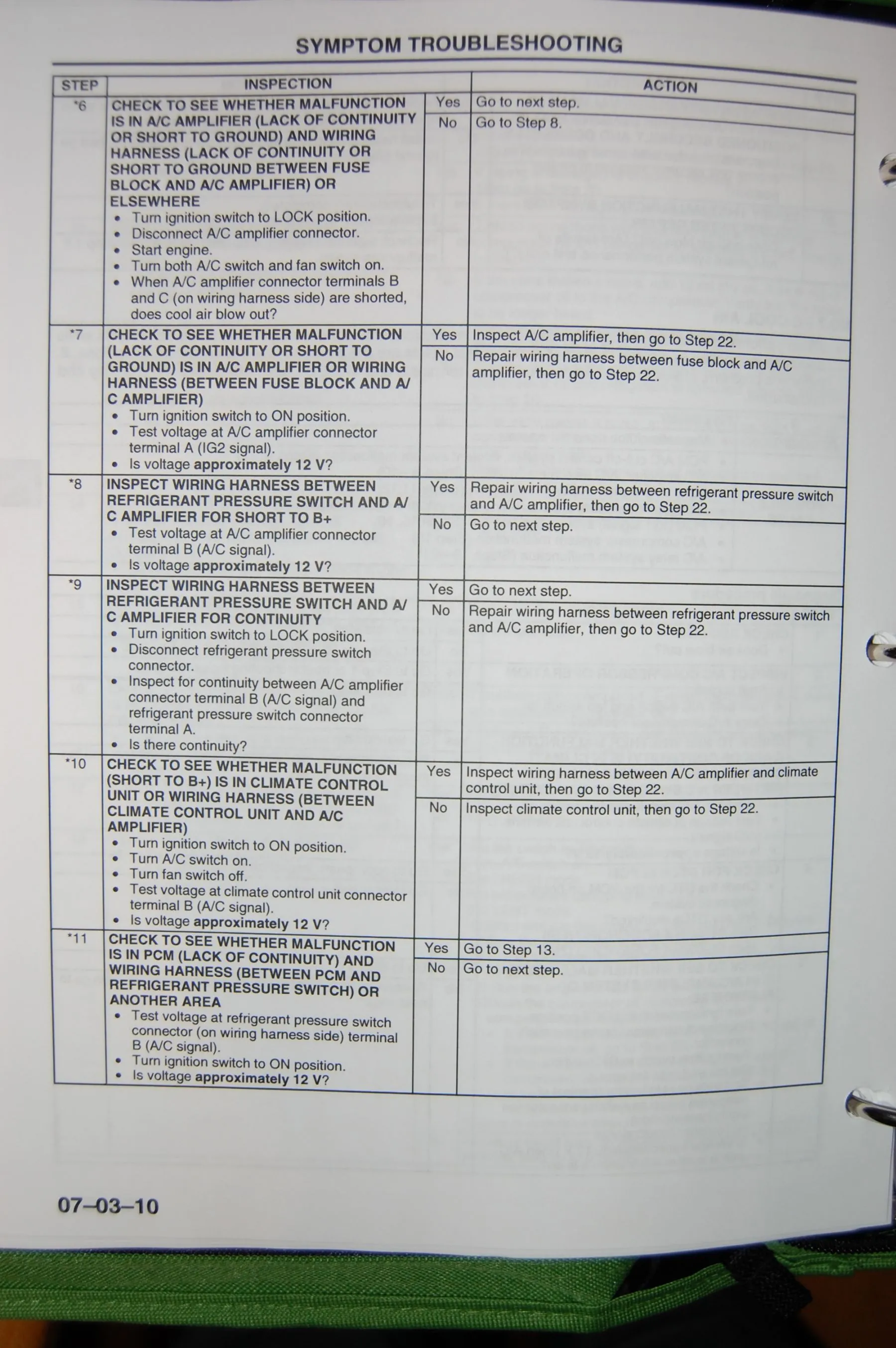

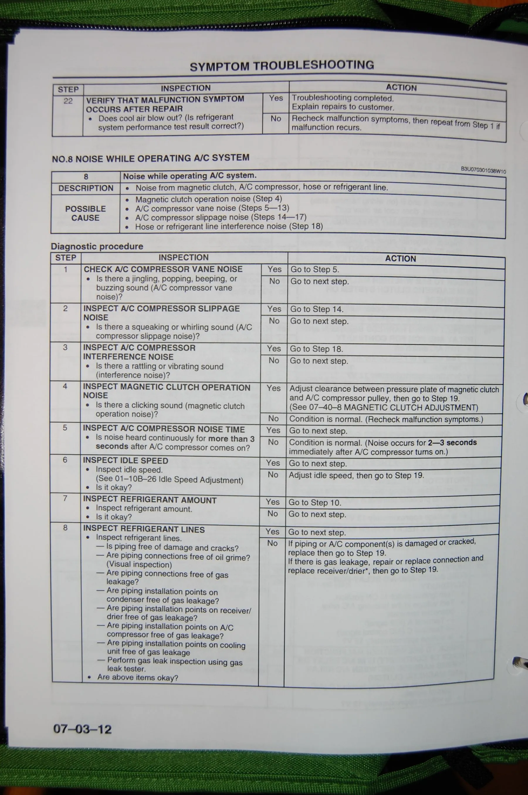

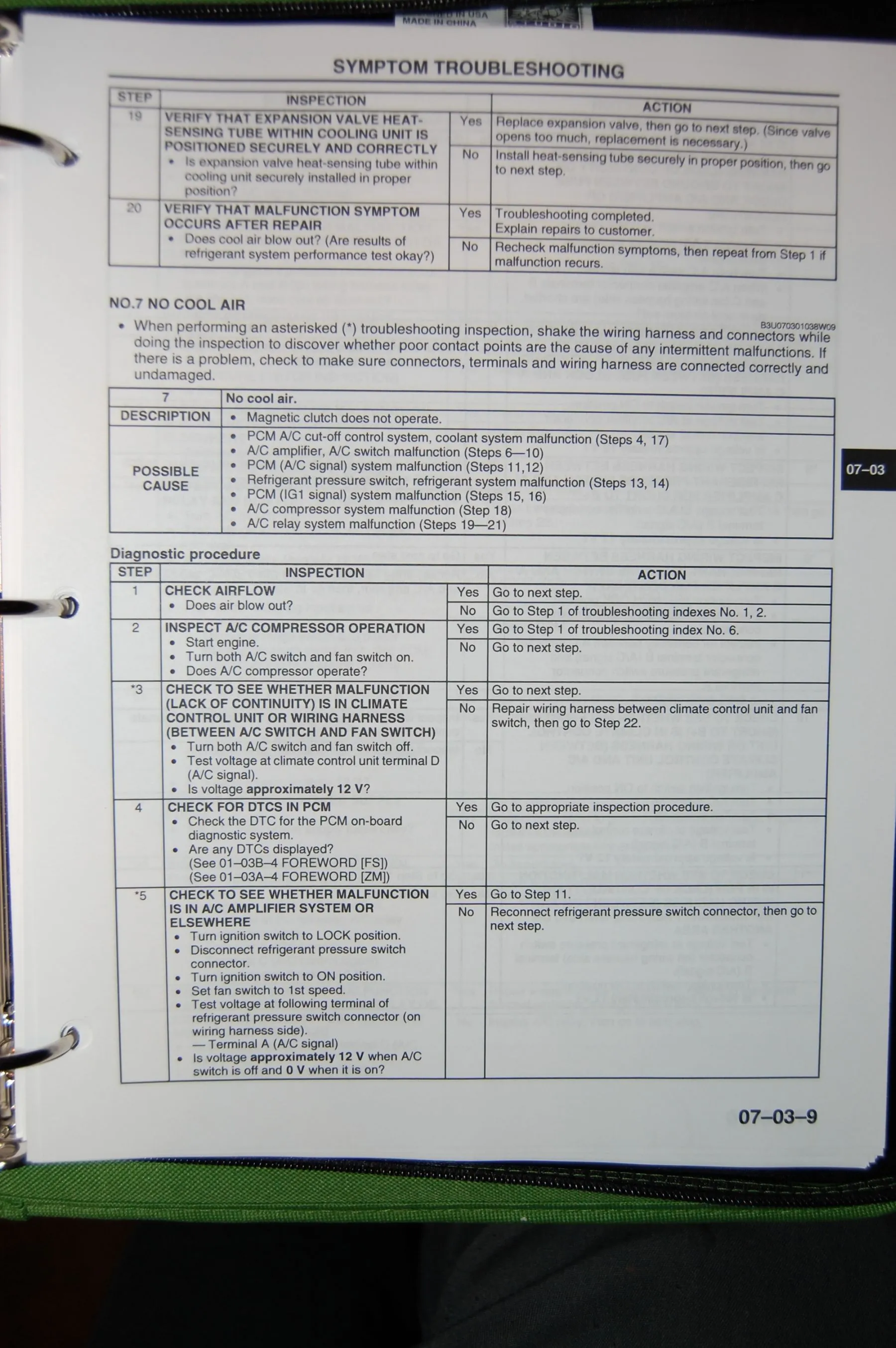

Here's what I got. Click on them to make them bigger. Sorry if they get too big. Start on no.7, it gives you troubleshooting for the AC compressor. One more on the next post. But I have a question. When you put power to the compressor was the air getting cold inside the car? If it didn't get cold that way I would think you'd be low on R134.

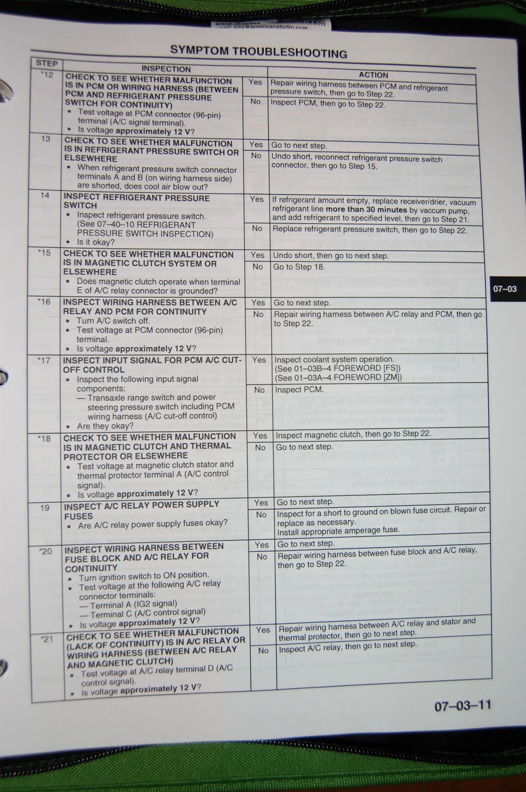

Last one. Only step 22 on the top. Hope this stuff helps!
A/C Troubleshoothing! This might help me a lot, I'll try to go through the list and see if I can find my problem, thanks.
When I connected the compressor manually it put load on the engine but nothing happened to the air inside. Even when I had my engine out the A/C system was sealed the entire time and the refill isn't that old, so I guess that if I'm low on R134 it means that I got a leak. I'll go through the chart and if I can't find it I'll have to refill the system with colored gas.
