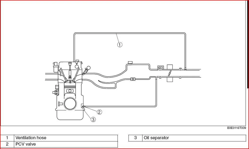

I was looking through the FWM for the first time. I've had to do nothing but change the oil so far but I was looking at some common maintenance items and came across one and let's say I almost shat myself.....
POSITIVE CRANKCASE VENTILATION (PCV) VALVE INSPECTION [L8, LF]
DPE011613890W01
1. Remove the intake manifold.
2. Remove the PCV valve.
WTF????? Are you serious, remove the intake manifold to remove the PCV valve. Holy s***. Hope this isn't a sign of things to come with this my first Mazda.
Of course, keeping your oil changed regularly keeps the PCV valve clean. So maybe the PCV valve gets changed 2X in the vehicle's lifetime. Like a water pump, so no sweat.
eh, not sure I agree there. I clean the PCV valve on my civic about every two years (~25k) and it needs it every time. It was clogged open once (plunger couldn't return and seal) when I let it run for about 70k miles. The average oil change interval over the 200k miles I've owned the car (bought it new in 96) is 3100 miles so you can't blame old oil. A PCV valve is basic maintenance and removing an intake manifold to do it is a complete joke.
I used to change the PCV in my last car (Ford) every second oil change. It was a 30 second swap with a $5 part so I figured it's worth it considering what can happen if the PCV decides to seal shut. I've been looking into getting some very slim hands to try to change the valve without removing the intake but I need to do some more hunting first. Depending on exactly where the valve is (hence the need for searching) it might be easier to tackle the change from the bottom of the engine.
I have a mazda5 2006. I have never had to replace the PCV not even crack open a sparkplug to see how it looks. Back in my old buick I had to do it at least once a month..
I look at the exhaust pipe of my the MZ5. It is clean not even a sign of black sooth.
Anyway here is the PCV location, as per the drawing:
Actually just realized the manual I had is the european version. the only engine options in the VIN chart is a 2.0, not the 2.3 I have.
Anyone know where to find a US workshop manual? 2007 if I can be picky.
