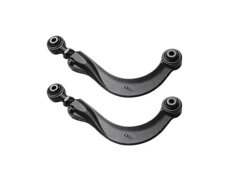

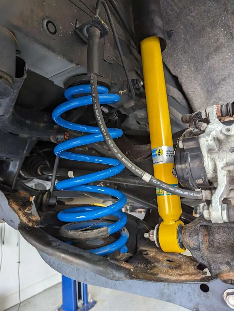

an update... suspension ✔️
It took some digging, but found some OEM-ish control arms
  • Suspension ✔️ - corksport + Bilstein + lykt control arms
now tires are the weakest link... down the rabbit hole we go.

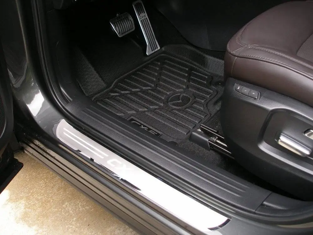

I'll echo the choice of the U Guard Maxpider 3d mats. They are an excellent choice, BUT, the OEM Mazda Canada mats look even better (with the CX-5 emblem) and are also made by U Guard. I have owned both of these mats over the years. They both completely cover the dead pedal which was the main reason I bought them.

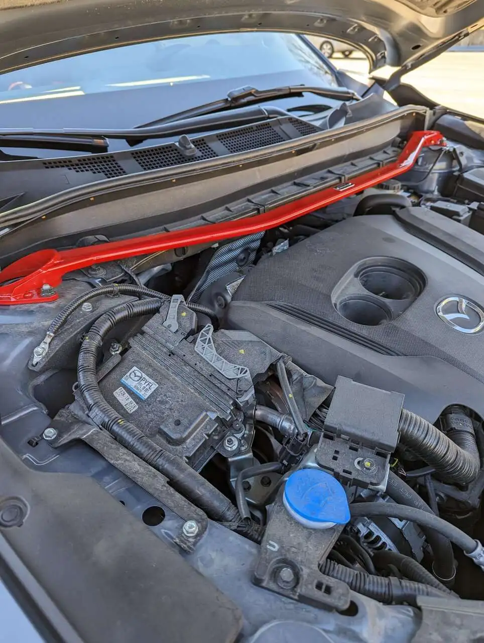

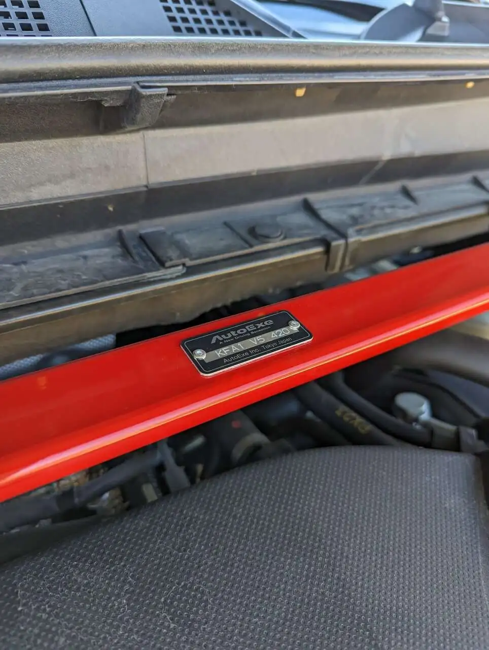

I'm somewhat of a naysayer with strut braces.
I had one on my gen 1 crv to help prevent the strut towers from failing when lowered, I think it helped. But as my Audi had one from the factory (sport suspension), I figured I'd go for it.
The autoexe bar was kind of a pipe dream piece for me, and of course it took a month to arrive and came damaged (scratches and paint chips). the vendor mazmart did nothing to help. Pretty frustrating, especially given their apparent presence in Mazda parts/tuning.
On the cx5, it definitely makes the front end more rigid. I can feel the road more. However I haven't noticed a big change in handling or driveability.
Autoexe recently changed the model number of the strut bar (not sure why as it looks the same to me).
Pardon the unkept engine bay.
View attachment 324547View attachment 324548
I've been wanting to get the AutoEXE front strutbar for my 22 turbo CX-5 but hadn't seen anyone actually offer it for sale here. Mikstore has a front strutbar for sale but they give no info on construction or who makes it.
